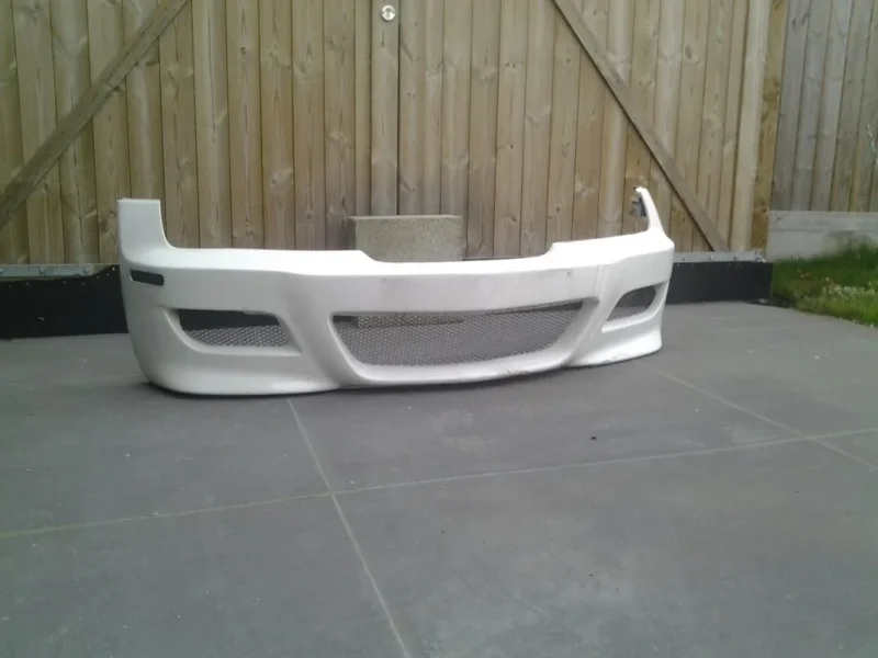

oooh hello @Stormy_be
wana be my new best friend ? haha
looking for a wide mouth bumper atm as I only have the little mouth one
my rear end is facelift I believe , do you have any cool add on bits for me aswell ?
Is this the type of wide mouth you are talking about?

I have one now mate , it's not like that though !!! That's cool , looks abit like a e46 msport bumper
