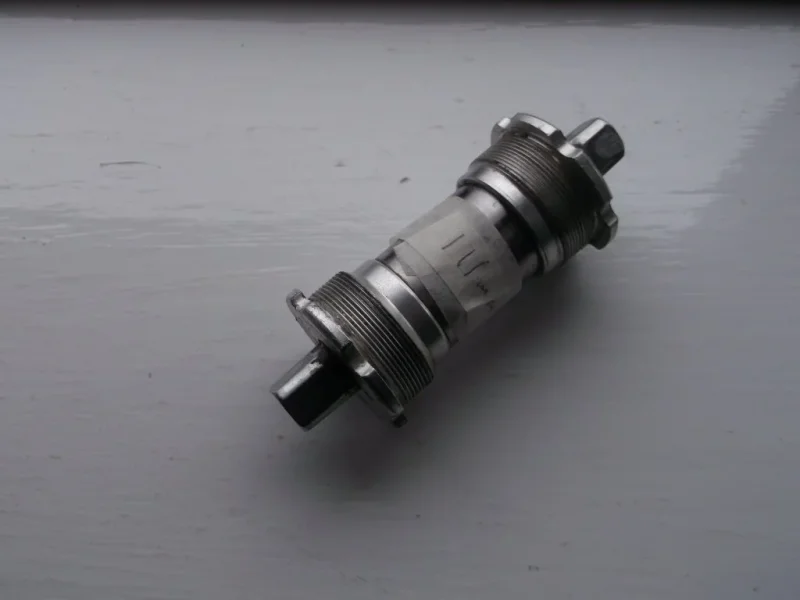

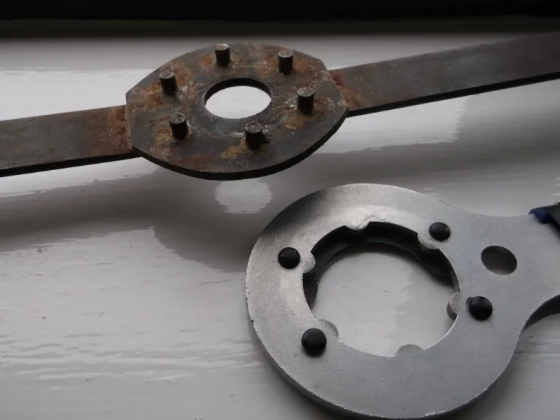

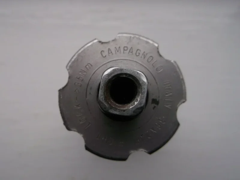

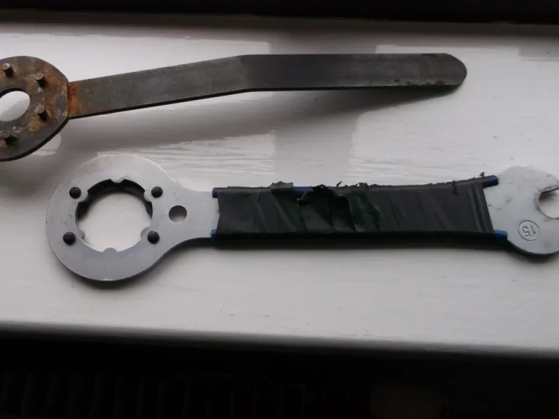

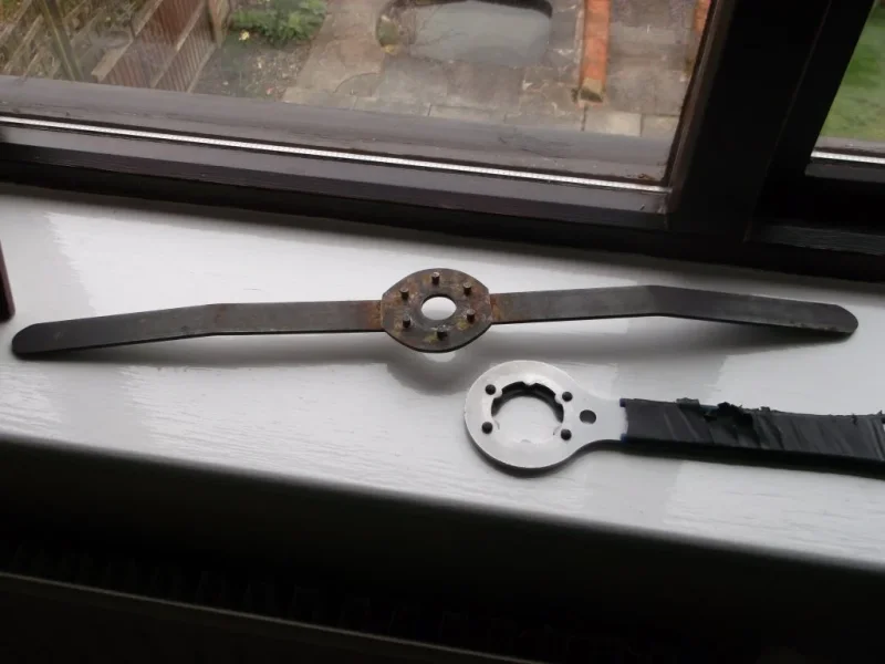

Some of you may know I like my bikes as well as my cars and I bought myself an old one last week. It's the type of Italian racer I was riding in the late 80's. So as it's cold and there's no room in the garage the spare room has become a bike workshop! The first job was taking out the old bottom bracket from the frame. On this it's the old Campagnolo type shown. In the shops you can buy a spanner to fit like the one shown,but they tend to slip off and don't give much leverage so I made myself the different two handled design which is miles better.
