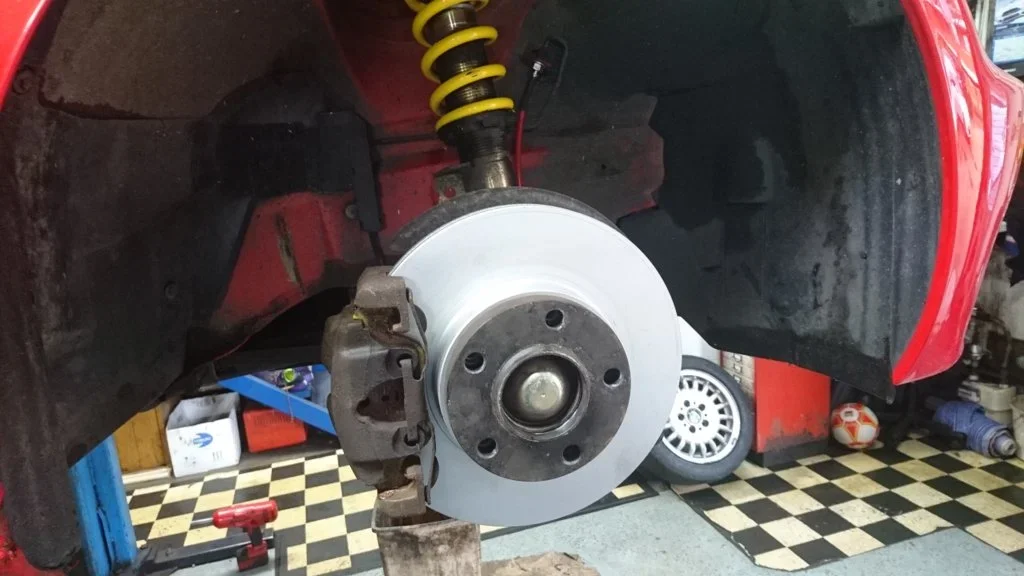

Good luck mate, have fun and be safe.6 cylinder calipers and pad carriers fitted
New vented discs and yellow stuff pads
Braided front brake lines and high temp fluid
Track style tyres!
Ready to go!
Is this a plug and play Andy? JIM6 cylinder calipers and pad carriers fitted
Track style tyres!
Ready to go!
Yes, surprisingly easy to fit braided hoses - as long as the old pipes free up easily, if not you can damage the skinny metal brake lines, you are replacing the OEM rubber sections only - which bulge when hot and reduces the pressure in the braking system therefore you get a spongy - ineffective pedal.Is this a plug and play Andy? JIM
