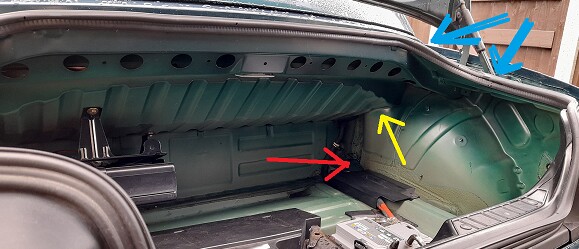

My leak into the boot was here
Here's picture inside my boot. I pore water carefully into the channel near the hinges. See blue arrows top right of this picture.
and drips appear inside at this joint. (Yellow-Arrow)
Water collects in the corner (Red arrow) and from there spreads to the battery tray etc.
It's a spot welded joint with sealant along the seam i guess sealant gets old dry and cracks. I've now sealed that seam front to rear with proper chassis sealant. Water doesn't come in any more. But where is it going? No idea.
It should be running round the outside of the boot seal and dripping off below the boot lid. It's all down hill from where you poured the water.
I assume because I pored the water it had a bit of uphill momentum. But we don't all live on the lincolnshire flat lands. Some of us need to drive down hills or even park on them. Doesn't take much of a hill to get the water going up that channel.
