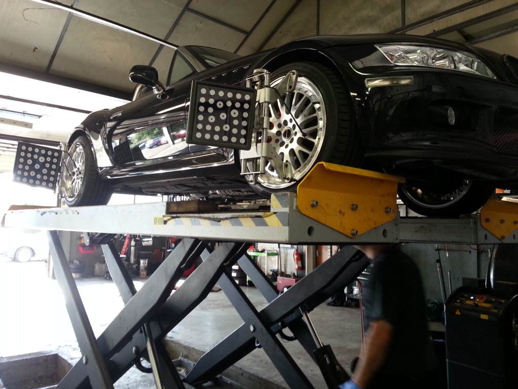

check the condition of the bushes first but i have done lollipop bushes with powerflex purple (mainly as they are easier to press in DIY) and i've just recievd my powerflex purple ARB bushed for the front as my rubber ones are splitting.
biggest change to mine was when i had it properly aligned.
First thing I replaced on mine @5harp3y with power-flex blue was ARB then the lollipops with the same, helped towards the terrible tram-lining and like you went straight for the wheel alignment. It's still not perfect but handling has improved.
