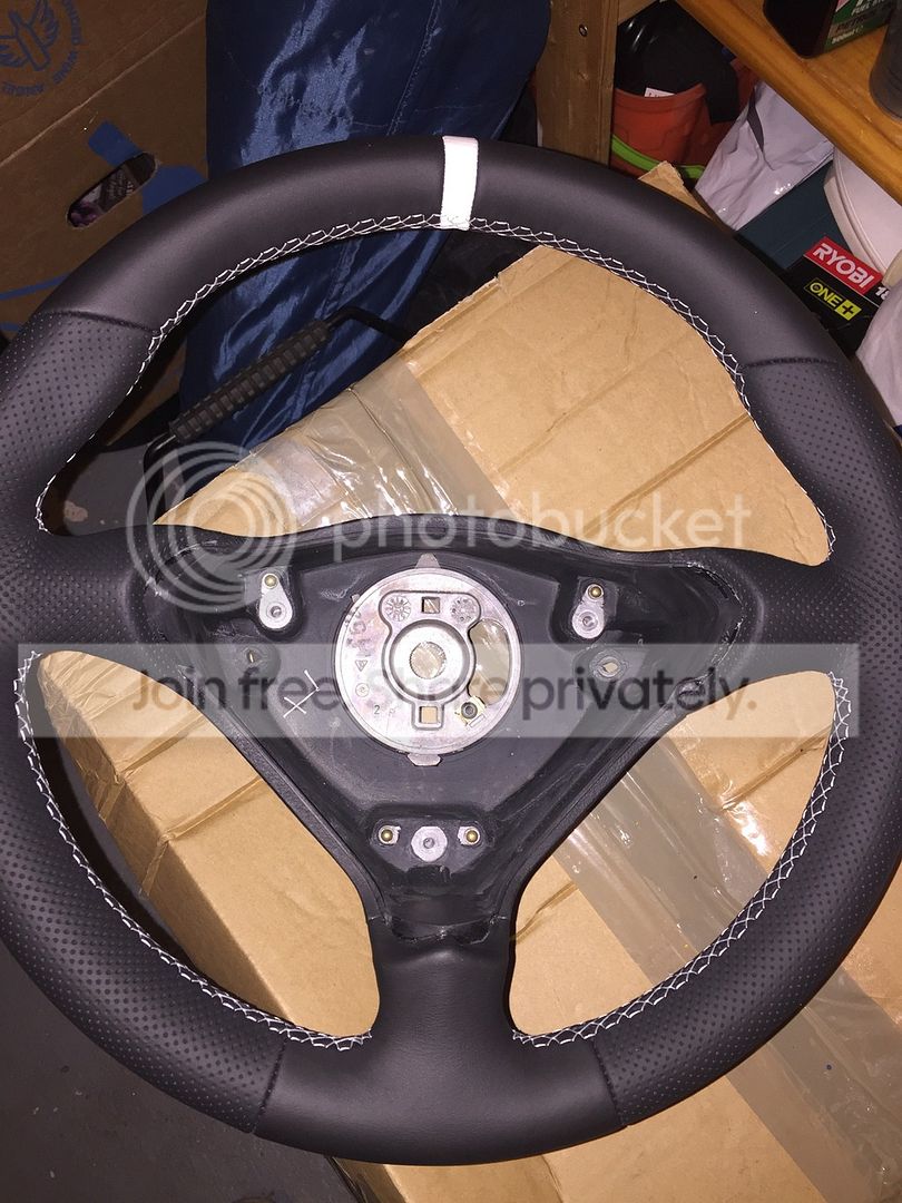

Do it - you really will not regret it.... I have had one on my //M for 18 months or so now and last week I got this one below with the thicker padding as discussed:
Compared to the old one :
