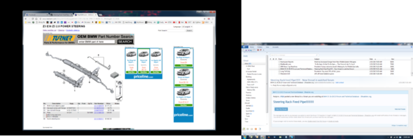

Hi Antm72 Have been on that site and one view says no parts available for my car and the other view doesn't show the correct pipe. BM dealer said it wasnt listed he showed me the schematic ( or whatever its called ) and its not in the picture.

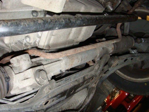

Which pipe are you talking about?
Is it the one that runs from the banjo fittings to the oil cooler? See rusty pipe in the photo. This one is readily available. Item 10 in link.
http://www.realoem.com/bmw/enUS/showparts?id=CJ32-EUR-03-1997-Z3-BMW-Z3_28&diagId=32_1115
If its the small pipe that runs along the top of the rack, easier to get a new one made up.
Thats the one !! the big rusty one. sure its no 10 ?

That's the part number I purchased when I replaced the rusty one on my 2.0 L Z3 in the photo. Just checked the invoice to confirm it.
