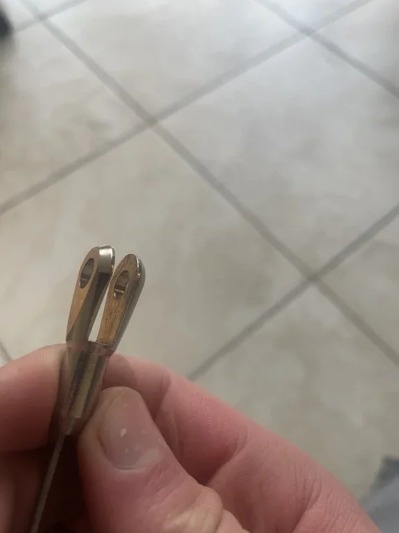

The throttle cable (pt num 35411164834) on my 2.8 z3 needed replacing.
BMW don't make them anymore so I had to source elsewhere
I found JJ cables on Facebook, based in Banbury, others I know have had great experiences with them
He said he cannot reuse the hook on the pedal end of the cable
So we found a triumph clevis (that JJ has in stock)(pic attached) that goes over the hole where the hook went, and then a pin goes through it
I couldn't use the original gromit so I cut a piece of hose pipe to stop the pin from rattling around. You wouldn't believe how well this fitted
JJ was quite busy, but he did it for a very reasonable price.
So the cable now has a brand new inner and outer, and looks brilliant
Thanks to JJ cables for that

Did they reuse any of the original cable ?
Smudgemanuk
Dec 1, 2024
73
Bicester, Oxford
2.8l TU pre-facelift z3
They only reused the outer mounting parts like, the gromit near the brake servo, and the bit that goes through the firewall
So in summary they only reused the bits they could not recreate as they are BMW special

Here is the final result!!
Very pleased indeed, works like a charm
Instead of the rubber grommet, I used a piece of hosepipe to stop the pin from rattling around, it fits perfectly!
