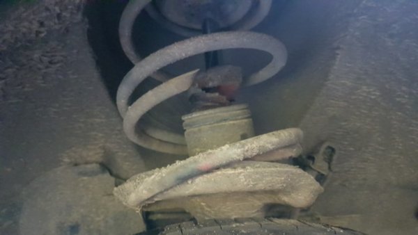

So I was going to join a few of you on track this past Monday, however when getting my pads changed, the mechanic pointed out that my front right spring had snapped (see pic).

Also as per the picture, it looks like some rubber has perished around the shock. Would I *need* to get this changed if I'm just changing the spring?

if you want the very simplest job.
get a complete shock and spring setup from a member on here (@Synclare , @spurs fan in a coupe, @mrscalex )
and then swap it for yours
5 bolts (ish) and you would be dine for now until you can replace all the springs with lowering ones for mad stance

I'm in Lincolnshire and have both front struts off a 2.8 with new springs on them
Sean d
Sep 29, 2015
201
Lincolnshire
Z3 2.8
I also have a set of springs off a 2.0 but I believe they are the same
Sean d
Sep 29, 2015
201
Lincolnshire
Z3 2.8
Mines a 1.9 and well a few moths old is better than snapped :thumbsup:
The newer ones are still on the struts but I will be removing them soon, so you will need someone with a spring compressor to put them on your car, I would suggest that you get 2 front shocks and do both sides
Where in Lincs are you
I have all you need to do the job if you can get over to me.:)

Think you'll find the springs on a 1.9 to be different due to the lower front end weight.

I would ask at ECP and see if they sell the same ones for both cars. Most likely they will.
