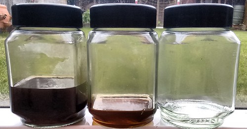

That Gearbox oil looks bad.
I don't think mines ever been changed well I don't see it on any of the bills that came with car.
Mines now done 75 k bit worried now.in case mines as bad.
Don't have any noise or issues with box or diff though.

Mine is at 85k and I suspect the gearbox oil was the original and the shift was stiff in first and second. I had no problem with the diff either, I just decided to do it as the car was up and level, it looks like it might have been changed previously as it wasn't too bad. They probably only did the diff as it's a damn sight easier than the gearbox due to the location of the fill plugs.
I wouldn't get too hung about it, :nailbiting: very unlikely the oil is so bad it will cause issues in the immediate future, I would just pencil it in at the next engine lube date as part of the service.. Peace of mind job! :)
