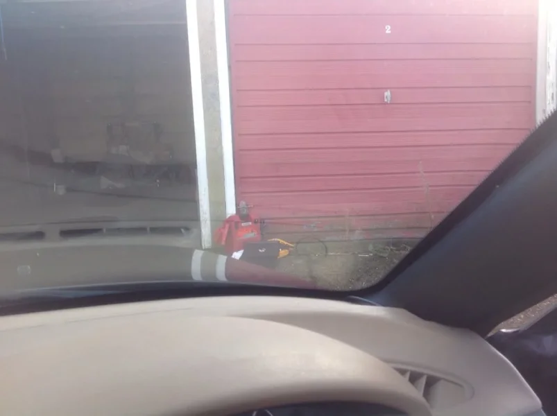

Bought dash cam after talking to T Tony and Aceman,, fitted it with some success so decided some DRLs were next after seeing pic of T Tony's Z and liking the look, (even though I intended to get some new lights with halo's,) when it comes to electrics I would normally get the pro's in but decided after fitting the dash cam to get myself a new meter and have a go. Guess what? After two days of freezing my nuts off and removing grill and under tray four times I finally got the DRLs in the right location, all this done in -1 to +3 degrees on concrete outside my very narrow dark garage. Then waited a week before wiring up(which I was less than confident in tackling). For some unknown reason I couldn't find the wiring instructions so went on Internet to get some idea. Much help and no help,seems they could be wired two to three differant ways. One day this week was forecast +7to+8 so off I shot (long johns an all) to my personal patch of concrete, took my jump starter to wire up DRLs just to make sure they worked after all the relocating,and they did. So after forgetting my I pad to photo my progress I went back today with it to give you all some idea of my finished work.

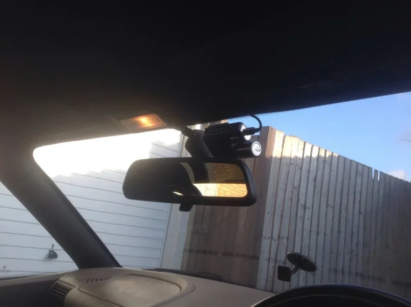

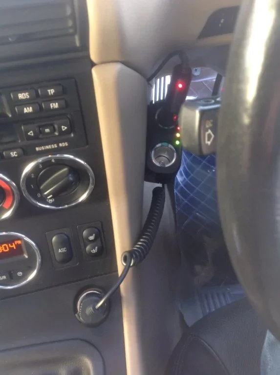

Hi Tony, thanks for the comments and I'm ashamed to say I didn't hard wire the dash cam in at the time,but am gaining in confidence so will attempt it soon, have taken some pics today of it cos I just new you would ask.;) So I'll post now. You'll see I went for the double adapter which works for cam+Tom tom, allso gives me a batt condition indicator, one small part of wiring shows as you'll no doubt notice but will endeavour to hide.
This is what I used Roy, just cut the plug end off at the required length and found an ignition fed live at the radio plug (n/s of console), plugged camera plug into the socket (this is also the voltage reducer - down to 5V) wrapped some tape around it for security and housed it behind the glove compartment. Only took me 1/2 an hour. Then camera is automatically switched on and off with ignition. By the way, the company I work for have just completed camera installations in our fleet of vans.
