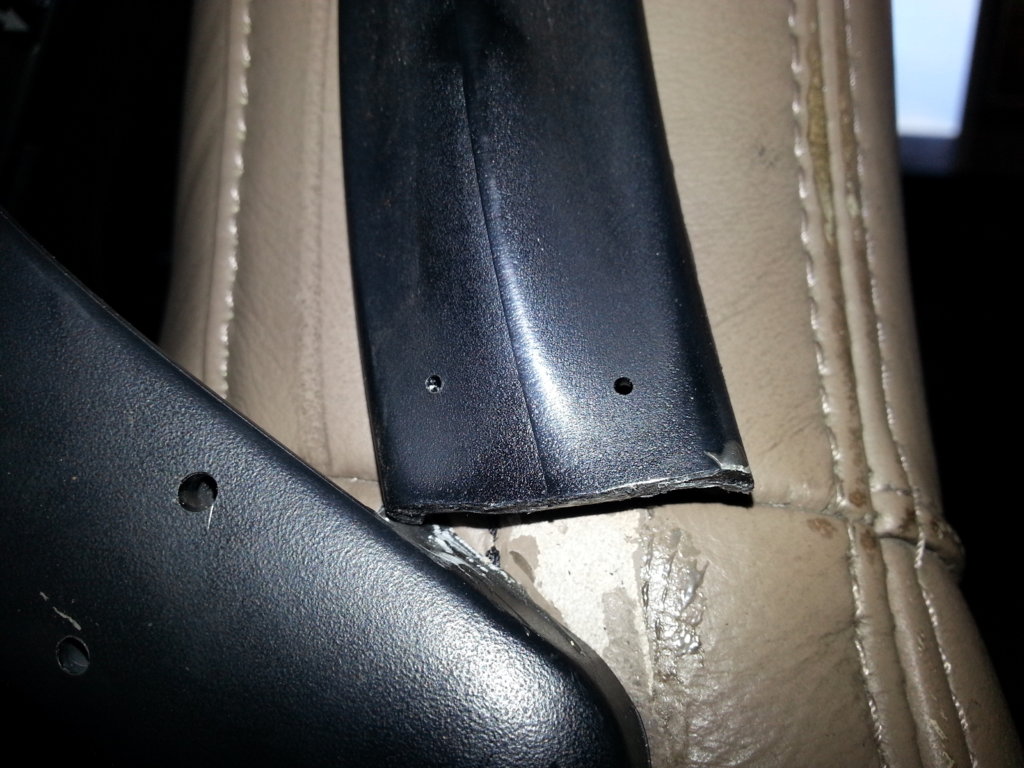

I have seen quite a few methods of repairing the seat belt guides on our cars. Here is mine, not as pretty as some but definitely less expensive. Requirements: All you need are 2 pieces of copper brake pipe cut to 5mm long and de-burred at the...
