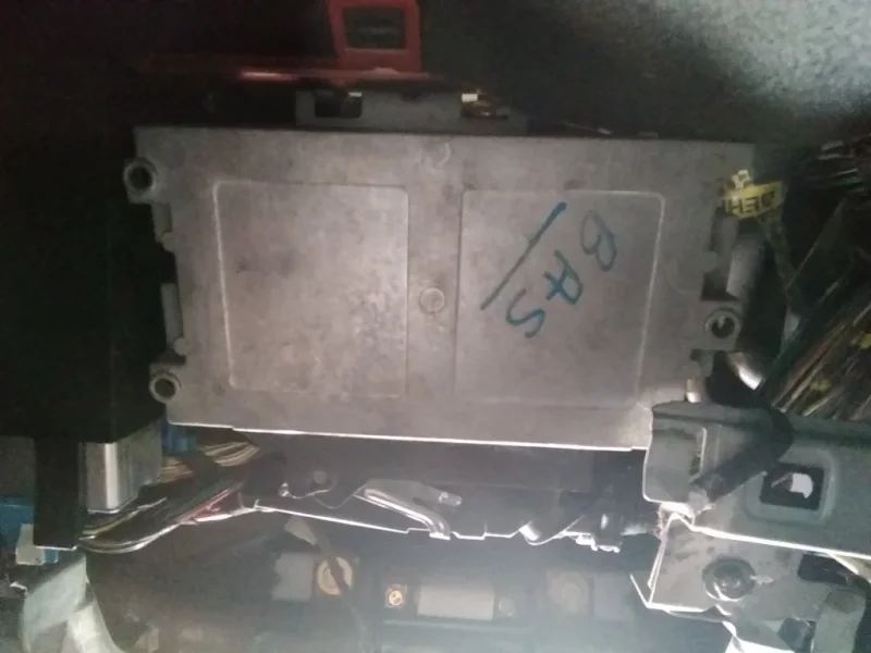

I might have just stumbled onto something. I pulled the glove box to visually inspect for anything obvious going to the module. I don't know all the history of this car, but it appears the module has already been replaced. It looks like salvage yard markings on it. I've read that these have to be coded with the car in order to work. If so, how is that done? Your thoughts on my discovery?

1) I looked up where the ABS unit in your car is used in RealOEM and its used in all the E36 cars. So try selecting an early E36 car and see if it communicates. I checked out my NT530 and there is a date that separates the ODB1 and ODB2 cars. The older date lets you select the module you want to talk to. The newer date asks for the car model. Try both.
2) Yes a replacement module needs to be coded to the car. Attached is my notes on ABS unit repair/replacements for ODB2 cars. The coding instructions at the back will be the same for your car. I suspect that you will have the same issue of having to find an old computer with a com port to be able to talk to the module with NCSexpert to code it. When I replace the ABS module on my car, I could talk to the module with my scanner and NCSexpert before it was correctly coded to the car.
3) Also attached is the electrical wiring diagrams for your car (production date 12/97). You can easily look up the fuses that control the ABS module.
