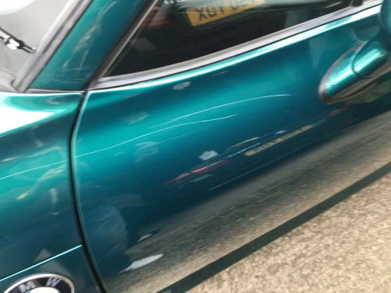

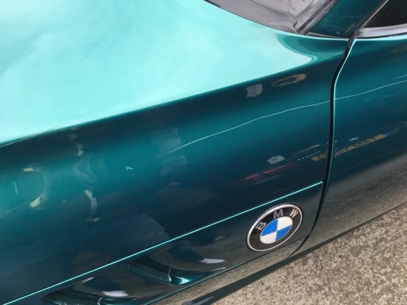

Thanks to everyone for making it another great day just seems to get better every year didn't get any photos a bit gutted car washed and polished outside of garage on Saturday before we set off when a little s*** from further up street on a bike decided to try and ride between car and garage end result

I came over when you were looking at it mate and although it looked bad I checked the depth of the paint a bit later on and found you have plenty of clear on for a bit of wet flatting and polishing. It looked close to going through to primer but mayb'e doable with so much clear on. Just fresh at the moment so looks pretty bad.
Readings were between 160 and 180 with the clear being a good 60. Considering new paint is about 120 to 130...
When you wet flat you probably take about 10 microns away being as yours is a little deep but I would be optimistic about this coming out.
Would save painting 2 panels and no issues with colour match..
In my opinion anyway..
