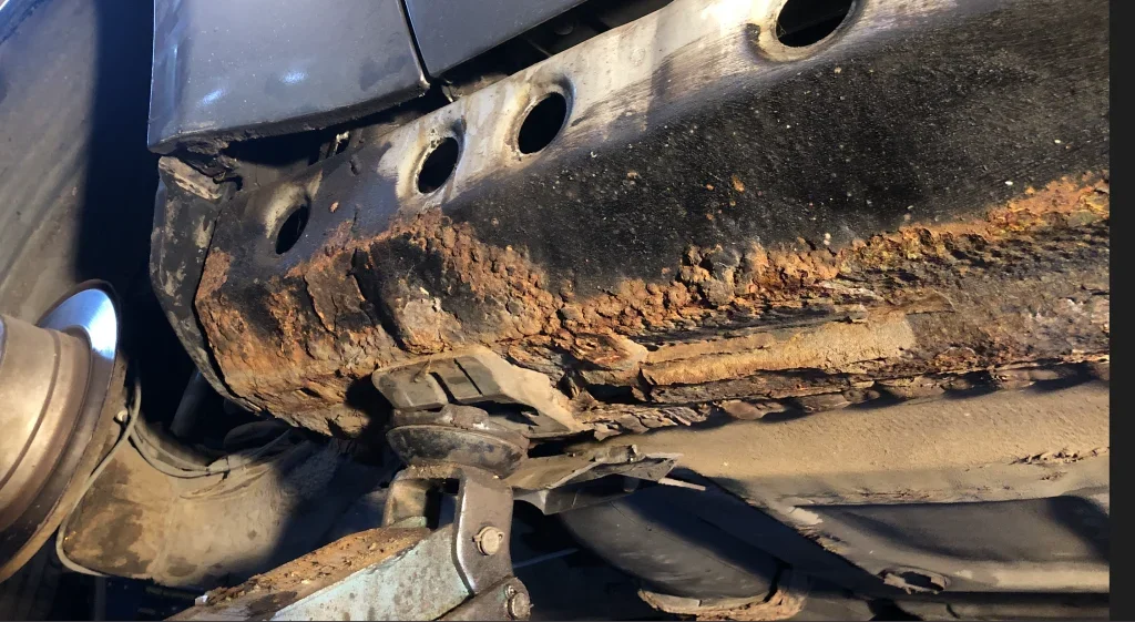

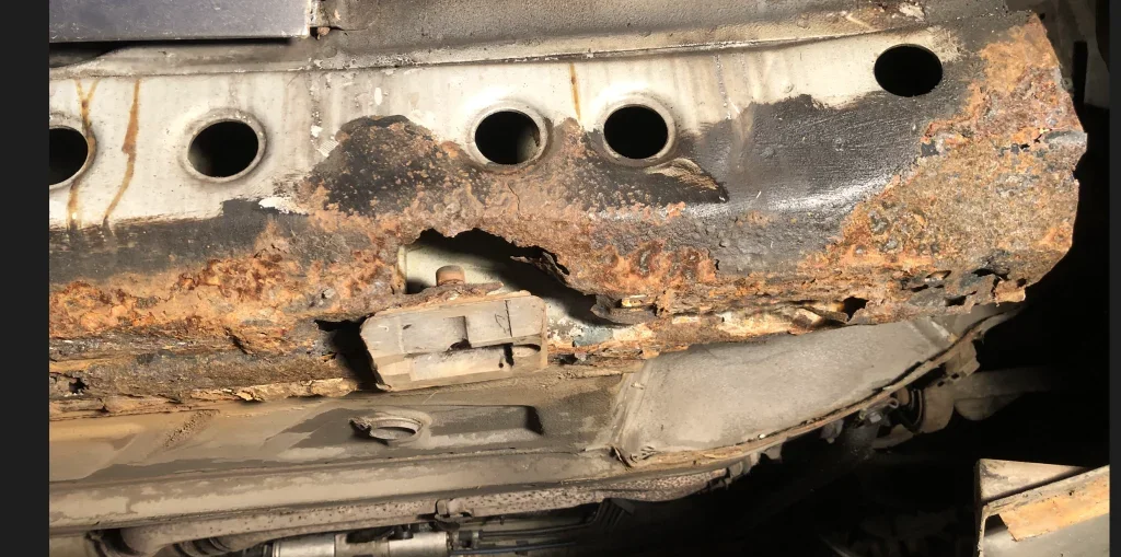

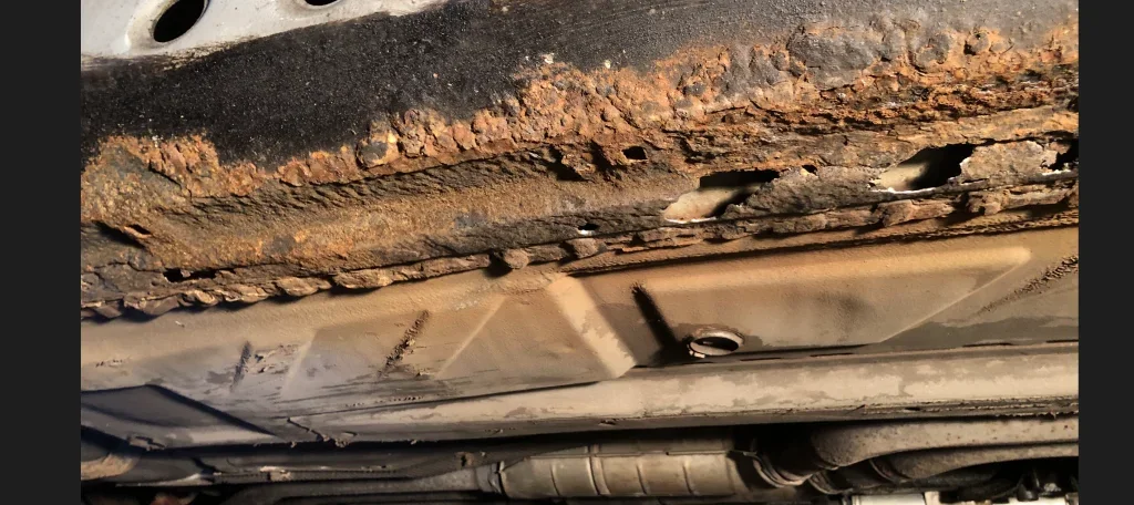

yeah thats quite a good amount of rot, but can be repaired, this isnt a patch up repair by the look of it, i would be looking at chopping the whole lot out and doing a full sill replacement (im sure thats what you had in mind) i think you can still buy the complete inner sill
TriumphZ3
Aug 2, 2023
66
My quoted price was for outer sill, apologies if that wasn't clear, but if inners are available I may need those as well - only removing the outers will tell. I'll ask BMW when I'm over later in the week.
Are there any kinds of front mud flap or plastic protector available for this area that looks good and keeps rot at bay for a bit?

Failing that yes I would also be looking at at cutting out sills and fitting them I do NOT want a tin can patch up job.
Actually, you DO want them patched.
I’ve repaired/replaced various outer/inner sills over the decades. Inner sills CANNOT be replaced economically unless its mates rates.
And 80+% of that sill is perfectly intact. So replacing it is utterly pointless.
To replace both inner sills completely it would be 4-6 days of solid work, (for one person), and needs quite a few specialised tools. Requires the full interior stripped too, as braces have to be welded in, or the car will fold when the inner sill is removed. Could probably bolt them in on a Z using the door hinge and hardtop mounting points. Time consuming compared to welding. Doors removed for access. It needs an awful lot of thinking about as it’s dead easy to stuff up. Then the doors don’t work. Believe me, I’ve seen it done. Fixing that? You have to cut through the new sill, fiddle with jacks and doors, weld a big plate across the chopped in half new sill and hope the MOT man doesn’t call the Police thinking it’s a Cut-n-Shut.
To repair those sills in situ, properly, would require cutting the rust out, I would suggest in 3 sections, as the middle isn’t as bad as the ends. I would NOT plate over the top of it, and if anyone even suggests it walk away. The sills are 2mm, all the repair sections on eBay are 1.5mm, so they’re actually no real use. 2mm mild steel sheet is readily available, I made corner repair sections for someone a while back, fairly sure I ditched the formers, may still have the oval punch though, . . Somewhere. It wasn’t difficult, no complex shape, the jacking point and lip I hammer formed.
I butt weld, I dislike overlaps, it’s slower and requires more care but I feel it gives a better finish.
The only tricky bit will be if there’s floor involvement. If there were, I’d simply cut the floor rot out and use a piece of angle to connect the floor to the inner sill vertical wall, then weld the repair panel to it. Much easier, and faster, to weld to new metal than rusty floor, especially with 2mm. Distortion is not much of a problem as it’s not seen. Myself I’d weld the floor in sections and planish it flat, but that’s just me.
Both sides, 2 days tops. It probably wouldn’t look original from underneath if the floor needed trimmed, but it would be solid as can be. Oil it to death and it’ll last forever. No need for bracing as most of the inner sill is still intact. Doors can stay on.
Not really that difficult for even just a half decent welder, not a challenge for someone experienced. I’d still want the seats out as it’s easier to fold the carpet out of the way, and the cables and battery +ve are there.
Do ask to see samples of his/her welds, and I’d advise it not be done gasless. It’s ok for fences and small repairs, but I wouldn’t use it on a body repair of that size. But again, that’s just me.
