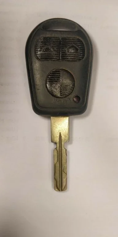

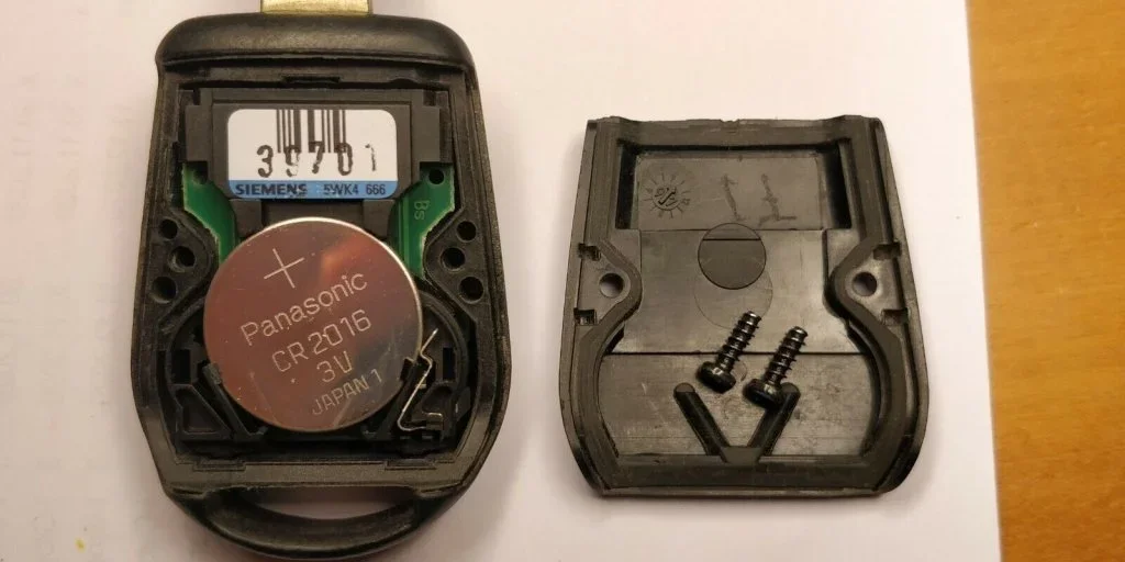

The key was the 433Mhz remote control version, no longer available at BMW. On eBay I see that there are Chinese copies, but I would like to buy an original BMW key because the replicas have horrible key feedback. I found someone who could sell me a remote control key for an E36 that should be compatible with my Z3. Attached pictures. Do you confirm?
I think it is possible to reprogram the internal electronic board and insert a new transponder for use with my Z3. Right?
The only problem I see is: is it possible to replace the metal part of the key with a new one suitable for my car?
Do you know if the metal of the key is fused to the plastic or if it is replaceable?

The blade is moulded into the plastic fob and cannot be transferred to a replacement fob.
The keys have two distinct systems inside them, a printed circuit board that operates the central locking functions and can be programmed to your car using a sequence of button pushes when you sit inside the car. If you have more than one key each key has to be programmed immediately after the first in order for the system to accept the keys. There are threads on here explaining how to do this.
The second system is the security transponder that is a small black almost coffin shaped transponder that is laid inside the fob alongside the printed circuit board. This contains the cars identity and key code that is read by the key aerial around the ignition switch and speaks to the cars EWS system and cross checks the key identity and a rolling code it was given the last time it was used, it changes each time the key is used. The transponder requires no power source to work. The battery in the key only supplies the printed circuit part of the key for central locking functions.
The transponder has to be coded to your cars EWS module for it to work if its a new key.
If you buy an ebay key and get the blade cut by a locksmith you could recover the transponder from your original key and insert that into the new fob, the car will recognise it as your original key and allow the EWS to start the car.
I use an ebay replacement key on my Z4 and have done so for the last 3 years, no problems with the quality of the key or blade.
