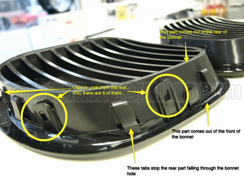

    Can someone please tell me how to safely remove my radiator grilles as I have bought some new ones. I may want to replace the old ones eventually so I hope not to damage the old ones. Thanks, Tony.:)

    Open the bonnet, at the back of grills you'll see the clips I think there's six take a small screwdriver and release the clips. The black part of grill comes out the back and the chrome surround from the front. They normally come out easily

    HTH

    Looking at these grilles I notice that they have the same type of clips as my aftermarket ones. Totally different from OEM ones, but still made removal easy, thanks Brian.;)
