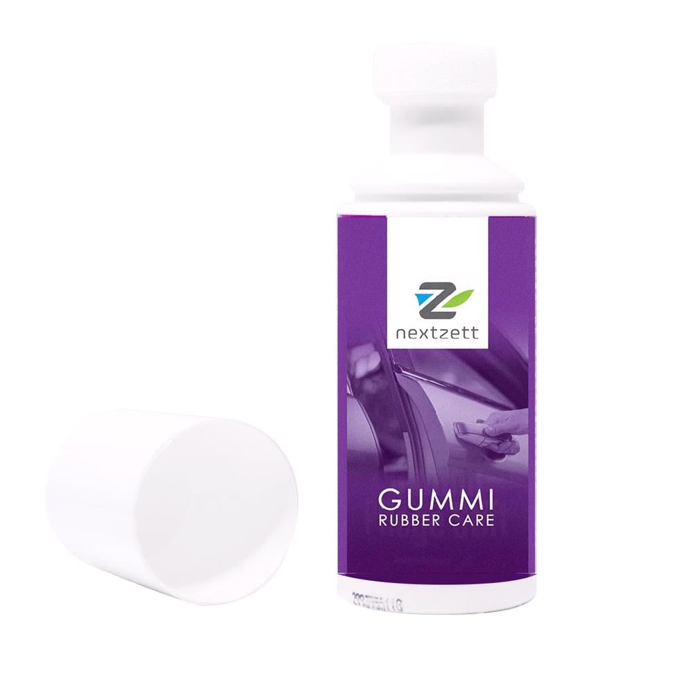

I would try a clean and then gummi pflege first. But if you're not happy with them replace them :thumbsup:
Cool, will do that. Can you see though this cord on the right side? One on the other side was just sticking out and I though first it was little old branch lol
I was referring to the rubber seals not the tension wire, Gummi won't help with that ;)
I understood, ordered Gummi for the seals and will wait with the tension wires after the new roof is done.
