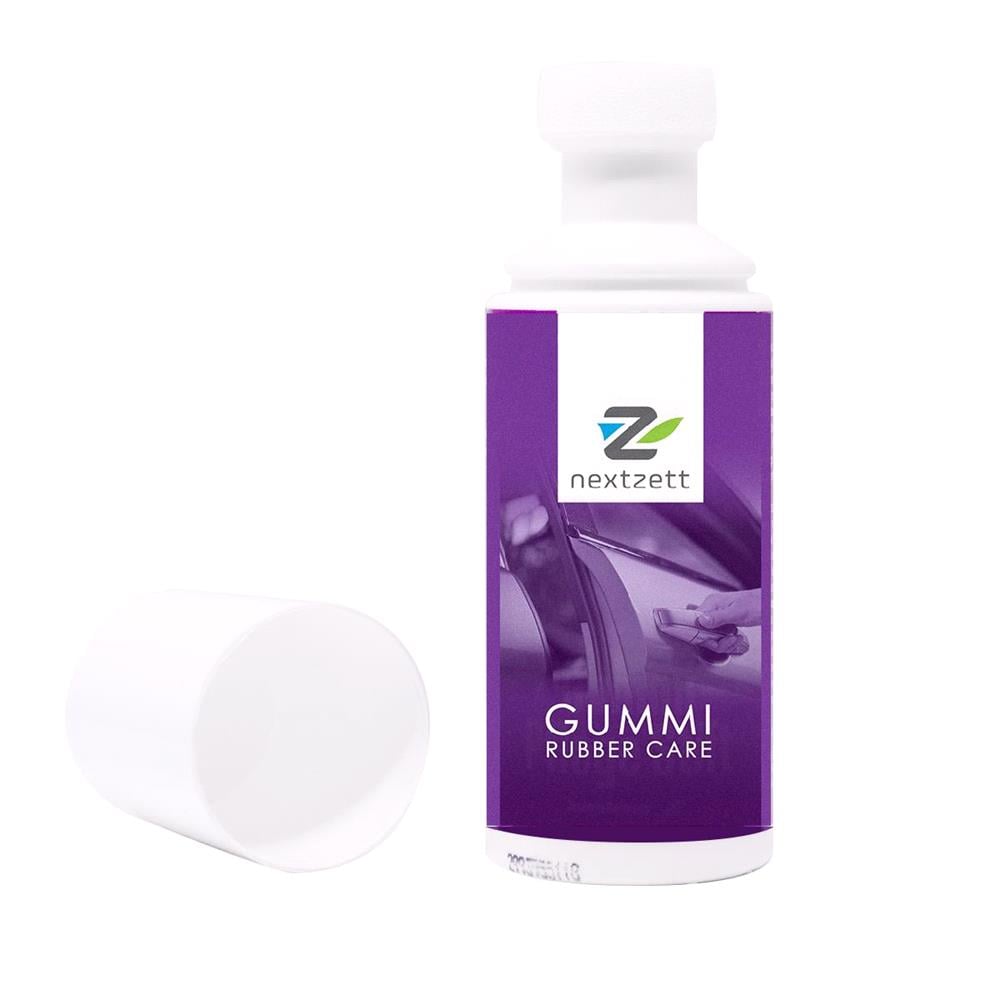

  • Gummi Pflege the window seals, it may help OR the windows may need adjusting via the bolt on the underside of the door to bring them tighter into the seals

So hopefully get struts sorted this week. Also ordered all the Gummi and silicone to assist the side window and will check the adjustable screw and see if that works.

What needs doing, I always treat my rubber seals with Gumipledge rubber conditioner at least twice a year, it plumps them up for good sealing
