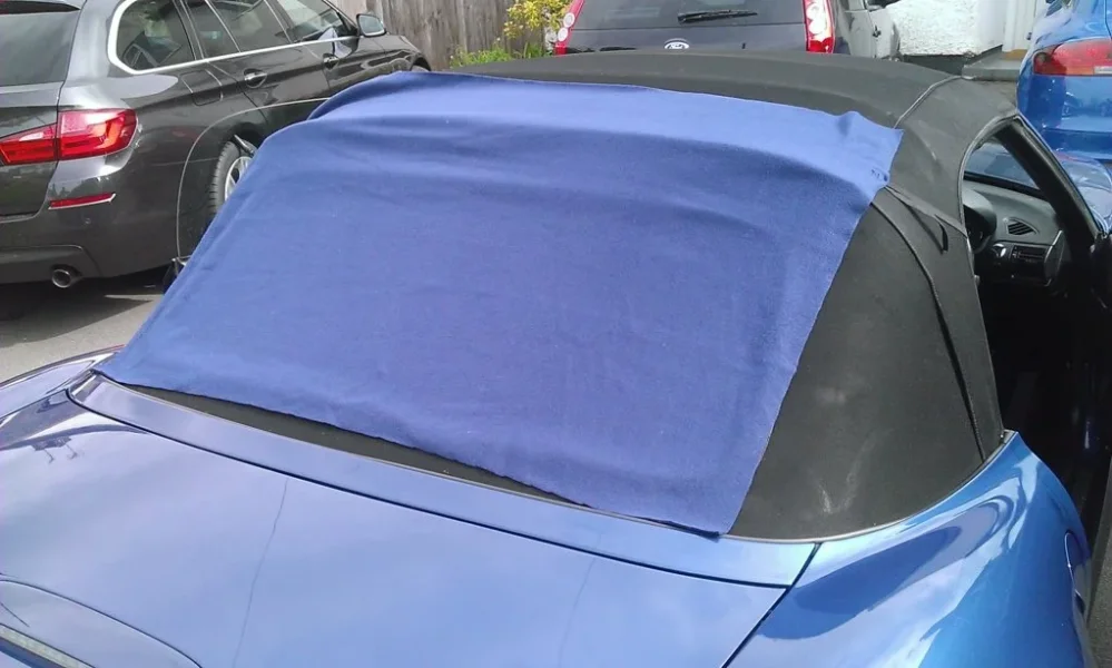

If all else fails you need some fleece from the Market , elastic and some clips and make you own like I did. £2.50
Will do tomorrow. It fits the same as the grey BMW one and covers the whole window.

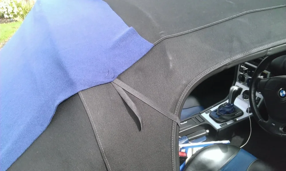

Where do the elastic straps hook please.Brian.
The just hook onto the roof frame round section just below where the roof liner finishes. and are 15mm cable clamps cut down. about where the red line is.
