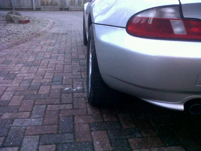

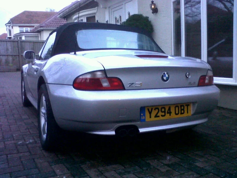

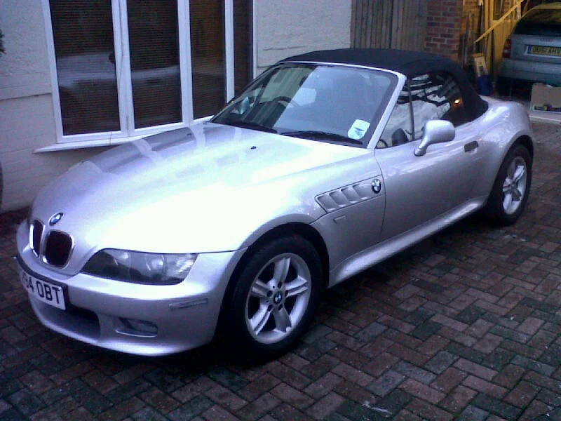

Well the 20mm Hubcentric spacers are on and I can confirm they have moved the stock 16" alloys out by the perfect amount. Very happy with the result. I got the type that bolt to the hubs so you can continue to use your existing wheel bolts including the locking ones.
At a shade under £60 delivered money well spent I think!
I'll get a couple of pics next time she's out of her box.
