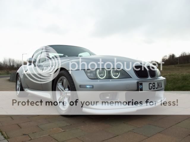

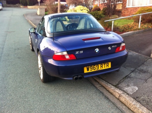

So here is a couple of pictures of a facelift Z3 with the same wheels as yours with 15mm spacers, and it did not move them as much as I thought it would.

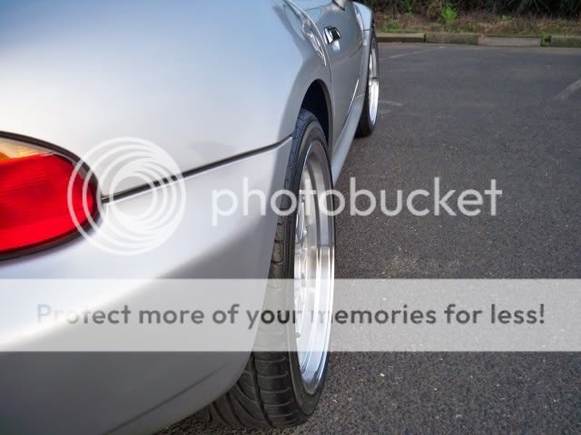

Haven't got a better picture of the car from behind to show, but same wheels with 15mm spacers on the rear. Pushed them out a lot better but you should get 20mm spacers on easily.
Don't forget though, yours is lowered, so the camber kicks the top of the wheel inwards allowing for wider spacers.
Remember when we first put on your BBS wheels, when the car was still on the jack they were protruding beyond the wheel arches and as we lowered the jack they went inside them. At first we thought they would be too wide,
The lower the car, the wider the spacer, or smaller the offset, is allowed.

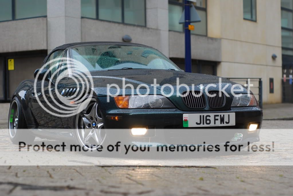

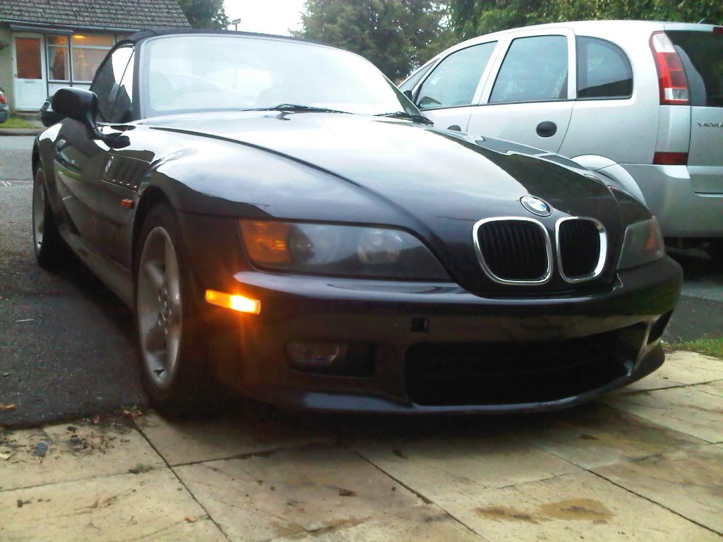

I disagree,.... the wheel camber angle changes as the car is lowered, look at these pics of the same car.
how do you suppose the angle of the back wheels has changed? allowing these wheels to be fitted.
Also on another car
Tyres protrude..
and same car ...
now they don't
thats how you fit Z3M offsets to a normal Z3..
Lowering a car results in negative camber at the rear. Lowered Z3's always make the existing wheels look further inset. so they require spacing out more. or consequently non lowered can not accept smaller offset wheels or as large a spacer

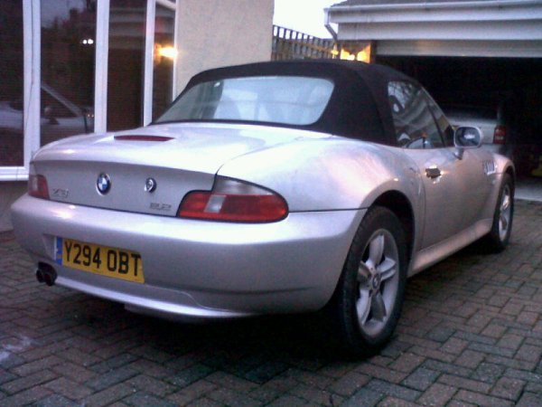

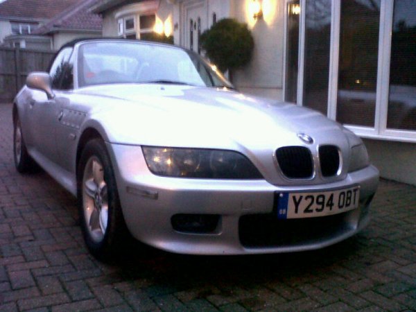

When I fitted my 18's to the car we put the back ones on and they stuck out miles from the arch when the car was lifted on the axle stands. There was no way they were going to go under the arch if they were fitted like this and I almost took them off and returned them, but when we lowered the car so that the wheels were on the ground they sat about level with the arch. Now it has been lowered they do sit further in and there is more negative camber to them, before I couldn't get spacers on without them sticking out of the arches, now I could get away with 10mm/12mm ones probably.
Look at the pictures of mine, not the best to show it but the top picture is when its not lowered and they sit flush even a little out of the arch and the bottom picture shows with the car lowered and them sitting in the arch and with more negative camber.
