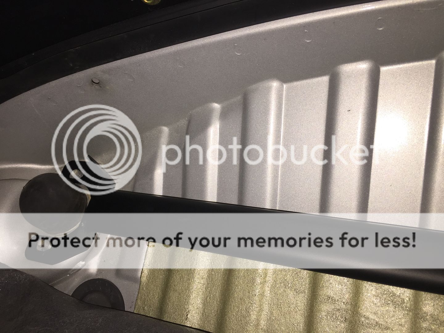

Ok.... Rear strut update.
I have modified the E30 rear strut to fit the Z3. It needed shortening and re-welding.
When we got down to the cutting and welding it was noticed that the E30 strut had 4mm Aluminuim brackets (I think steel would be better) and the tubular steel strut was thinner than I expected (strength was good though as a wide diameter).
Now to fitting and testing it.

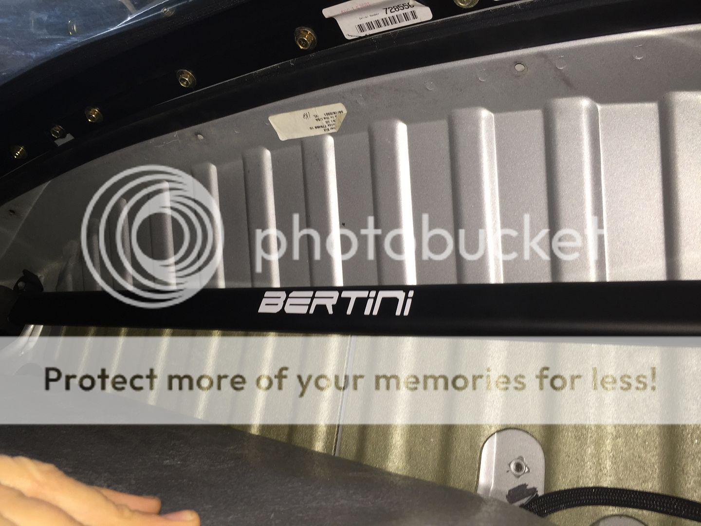

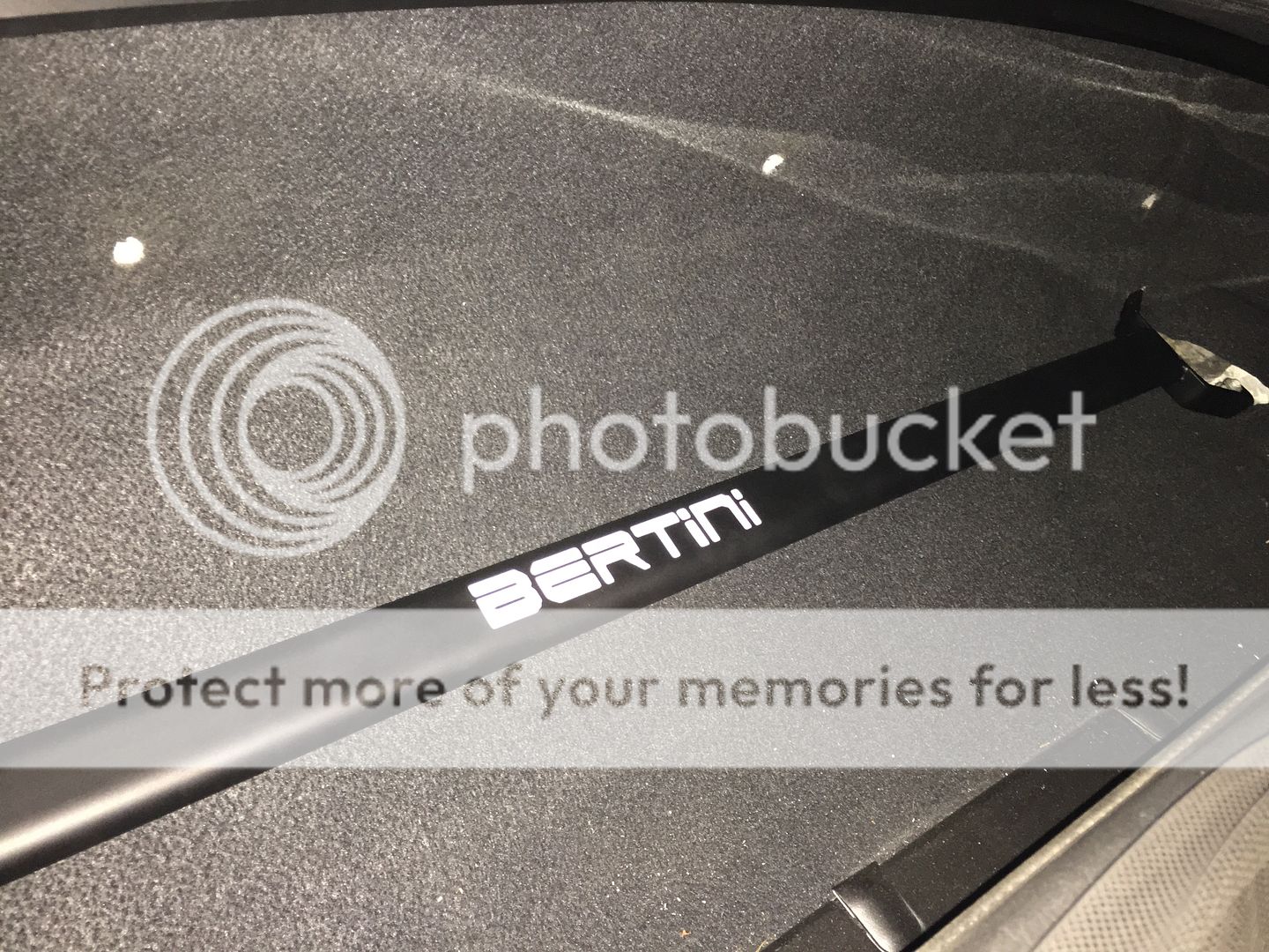

Simple to fit. Just unpop the plastic fastenings on the carpet below the roof. Pull back the carpet. Undo the 4 nuts. Fit the brace. And tighten the 4 bolts. This takes in total a maximum of 15 minutes.
The hood operated perfectly. Tight on closure. It could do with further modification. But still fully closed.
Road testing... This was fun.
I drove 60 miles on mixed roads before fitting the brace and 60 miles home after fitting.
I defiantly felt more feedback and the rear felt less loose. Less rear body roll and the car generally felt more planted. I was a little sceptical before fitting it as the existing bulkhead runs between the top mounts. But the additional bracing really seemed to add rigidity to the back end.

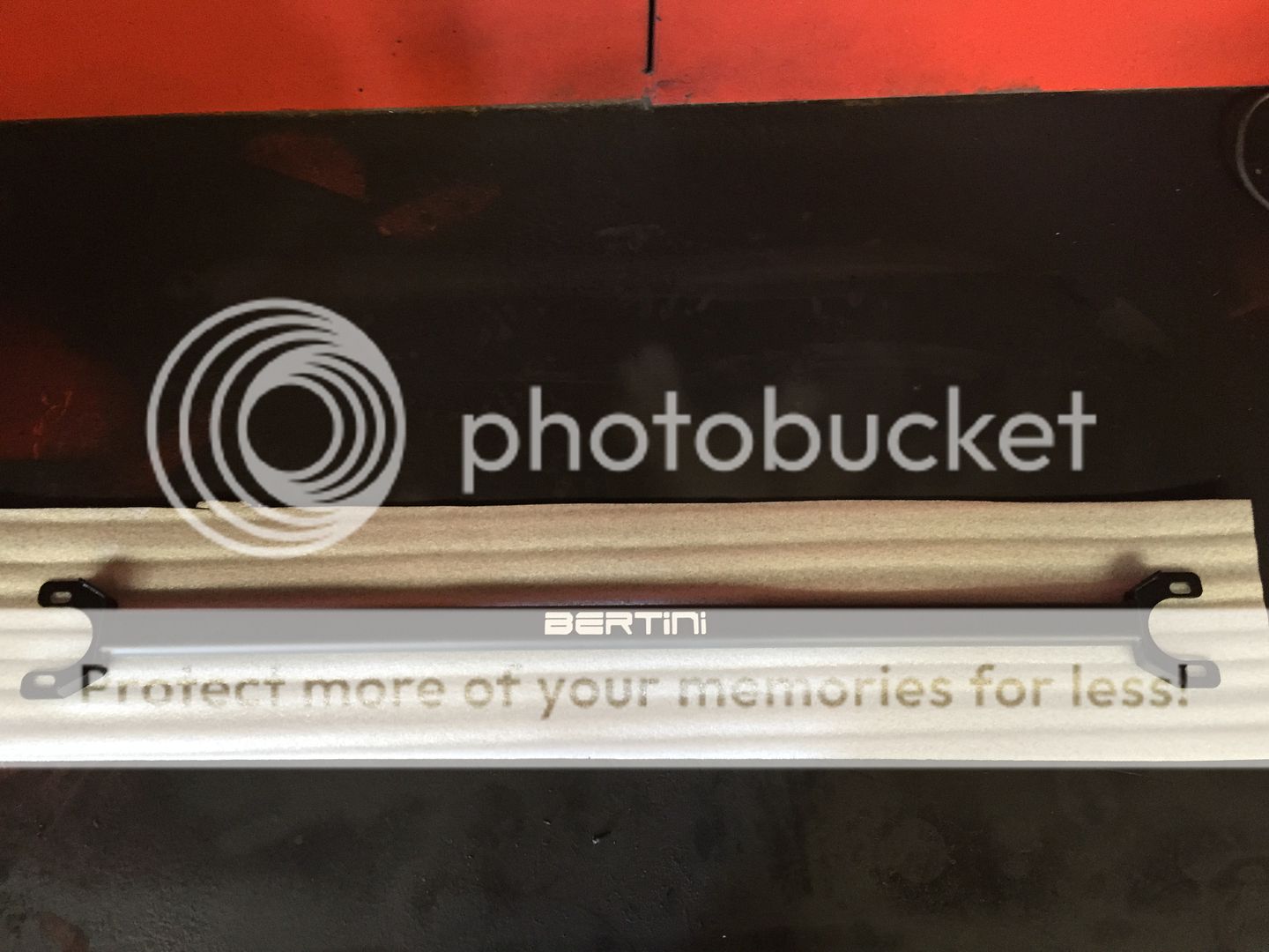

I was so impressed I decided to draw up some plans with the fabricators to make a batch of 10 x Z3 specific rear braces.
These will be of a thicker, stronger oval tube with a lower top profile than the one I modified. To allow a greater tolerance for the roof to close. Also 3mm thick steel end brackets (double the strength of the 4mm aluminium brackets) All tig welded together. This will be a very solid brace. Finally finished in black. (Although you won't see the brace as it will be under the carpet and below the roof.) this first batch will be ready next Thursday.
I intend to sell them for £99 UK delivered. But will bring some down to the London/Brighton where I will sell them for £80 take away on the day.
I'm pretty excited with the results! As soon as I have some pictures I will start a dedicated thread.

I don't see why it won't fit.
One of my concerns are if the positions of the bolts are the same in all the Z3's? I have tried it on a 3.0. And will check to see if they fit the M. But I only have two 3.0's and an M in my Bertini garage.
Cutting the carpet would make fitting it really easy. I guess that can be the choice of the owner. It might be cool to see the bar when the hood is up.
I will take loads of pictures with the brace installed both ways.

Very interested to see it.
I have damper adjusters coming out of my rear top mounts, wonder if that will affect fitting?
It should fit no probs Dino the standard shocks protrude as much as your BC shocks, the adjusters you have will just fit through the hole in the brace.
It looks very nice.:thumbsup:
