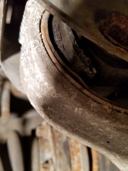

I’ve photos on this and my diff oil change, remember? Just didn’t take any notes so can’t do a How To guide.Remove the arm from the car. Rip out the old rubber bush then using a hacksaw split the outer steel shell and remove that. Poly bushes come with fitting instructions.
Agree - Special tools required referred to in this https://www.newtis.info/tisv2/a/en/...3-17-rear-axle-differential-mountings/ANLDVWQWould require specialised tooling, that's why people fit the poly type bushes.
Good to have both of those links as I want to give it a go with a stock bush. Jonco's as now I know how BMW do it and I won't be buying one of those tools! And Pingu's as hopefully I can make my own tool now and I have a 10 ton press so hopefully that will help.There is a very simple tool that costs around £1.
