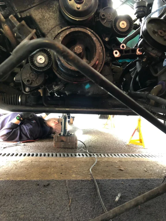

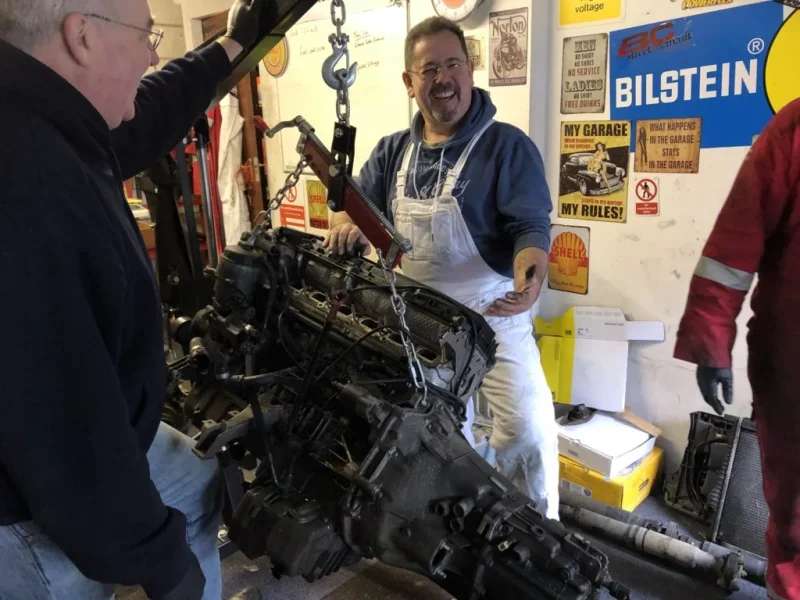

Then we tore in to completing the removal of the M54B22 engine, most of which was mostly removed if you see my last post. We wanted to do this without having to empty the air conditioning gas, so we took a bit of extra time and care to move all the components out of the way so the integrity of the system was maintained. Will also save having to get it regassed when it's back on the road.
The engine is pretty much out at this point, just some messing around with the gear linkage and negotiating the route of the engine out.
A few minutes later - thank goodness Niall turned up, we likely couldn't have managed without his triumphant claim of "doing it all on his own" :whistle:

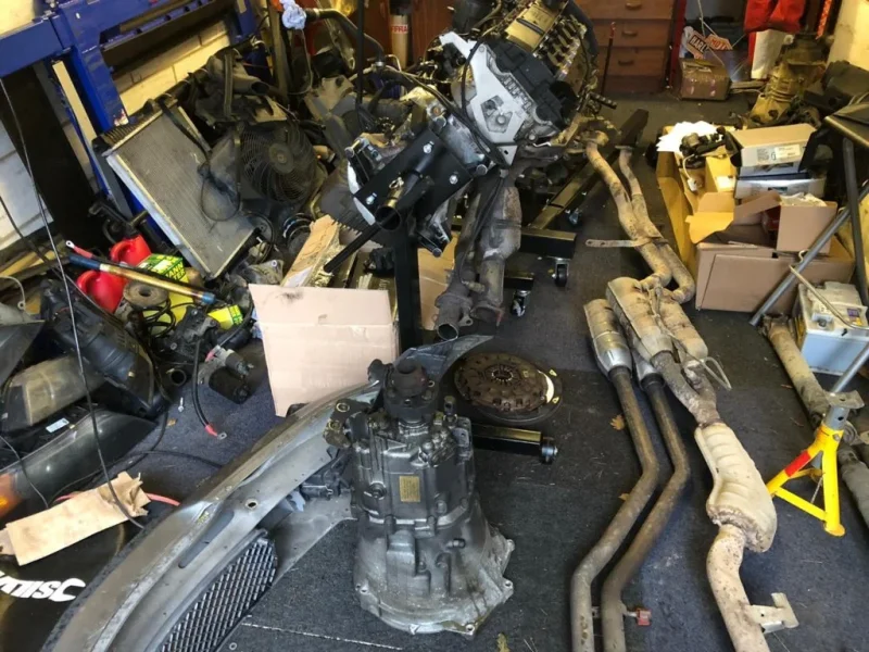

Another empty engine bay... You can see the air con ancillaries on the left hand side of the bay.
Gearbox off the M54B22, this time no fight and no broken casing bolts.
A picture of the cats integrated in to the exhaust manifolds
In the background the M52B28TU donor engine, and in to the foreground being attached to the engine stand is the M54B22 "scrap" engine. We are most likely going to use this for training on how to do Vanos seals and other tasks people may be interested in seeing.
