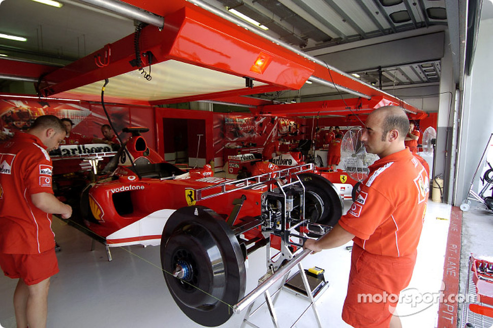

I can't help think that some thick nylon discs that fit like wheels would help you wheel the beams in and out from under the car, they would also protect the rear brake disc guards.
Something like this. But maybe a little cheaper :)
Good work as always boys :)

I have seen those that replace wheels and allow a vehicle to be pushed around in a shop so some smaller would likely work and avoid having to balance on the jack! JIM
But, you still have to have the ability to lift the beam back up to the car ........................ ?

Remember the rear subframe assembly is not rigid. It flexes in the middle but the discs will be a good idea to protect the guards. Then again they barely take any weight because it's supported on the jack.

Just a thought, would a trans jack provide wider support than just the pad on a trolley jack?? And you are correct @t-tony you would still need a jack to lift it unless you were built like @Lee who should be able to just press it up into place! Me, I'd need all the above. JIM
