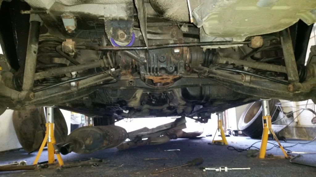

Had this messaged over to me by Lee, he's collected most of the parts from GSF. The PowerFlex diff bush has been ordered from an online supplier as GSF don't do them!
The rear beam has been dropped off for the old bushes to be pressed out and the new ones pressed in.

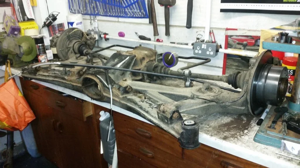

Well, that's that project finished! Total time estimated at between 10 and 11 hours from wheels up to wheels down :thumbsup:. Two evenings and on Saturday (even had a proper lunch break today when popping out for more parts).
One thing I forgot to mention earlier in the thread was that Filbert is now on 161k miles.
A few more pictures from todays efforts. Lee had already picked up the rear beam from the guys who push out and push in the beam bushes. The guy said these were really hard work as they were really bad.
New Brembo brake discs fitted. These have a nice coating on the hubs so shouldn't rust/discolour quickly. They aren't that much more expensive either.

New beam bushes close up...
To show the contrast in how a new beam bush act compared the knackered ones earlier in the thread...
View: https://youtu.be/itLO06RqYYc
Ready to drop off the bench following a sanity check to make sure everything is correct, fitted and tightened.
