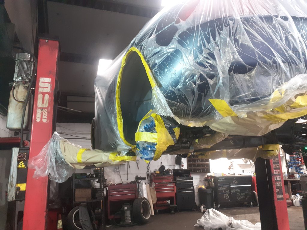

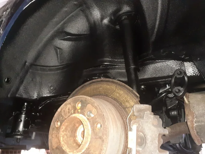

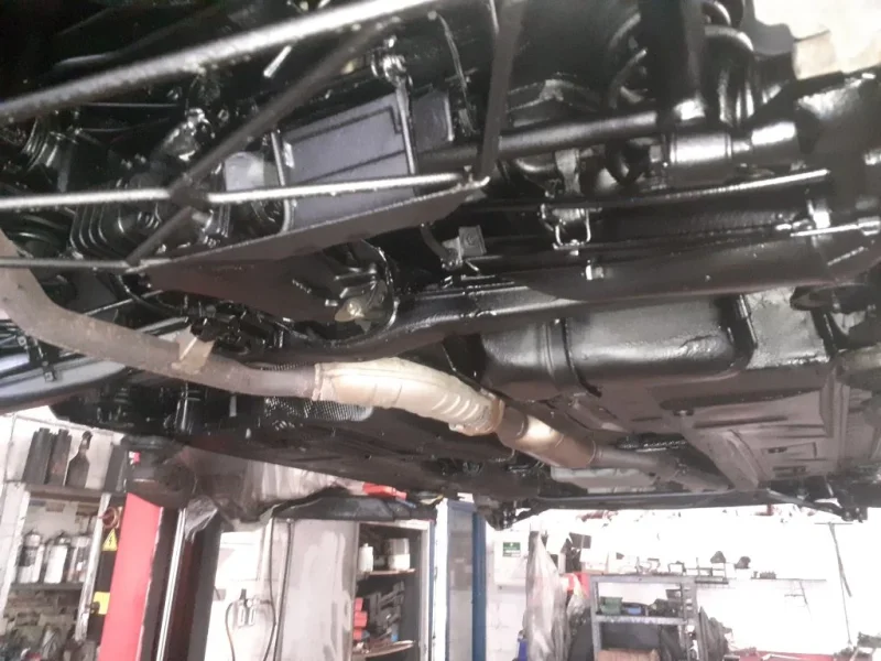

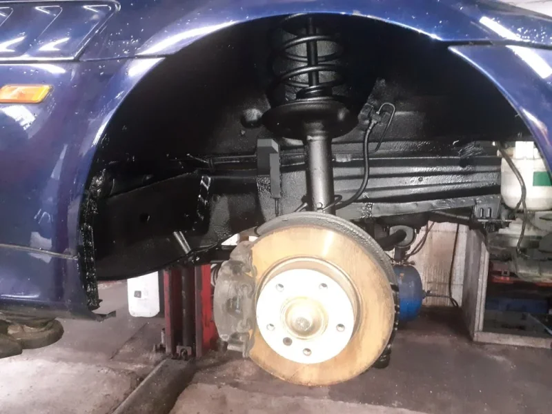

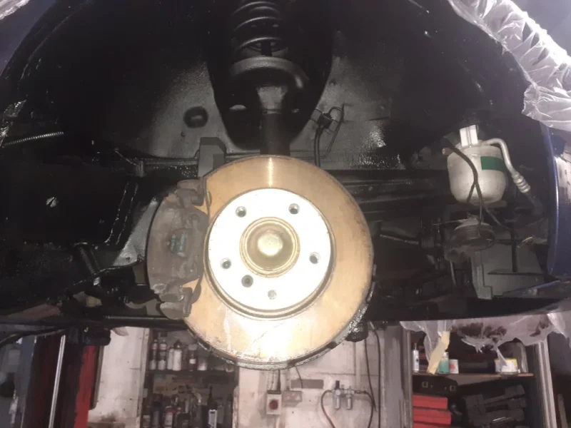

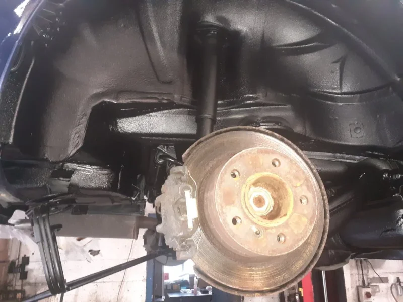

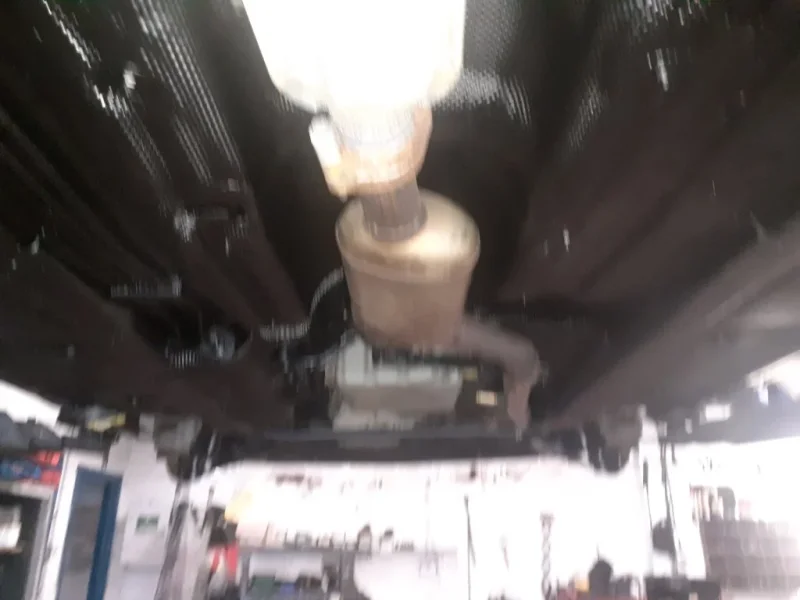

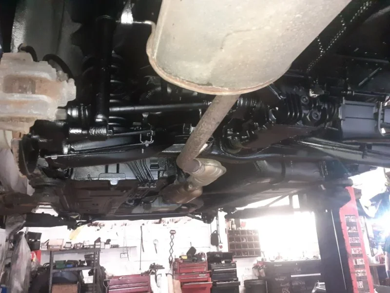

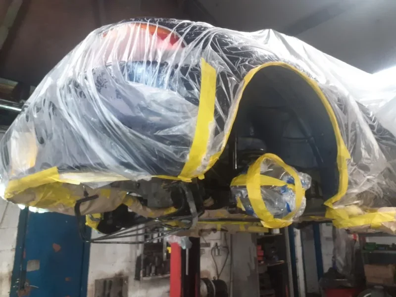

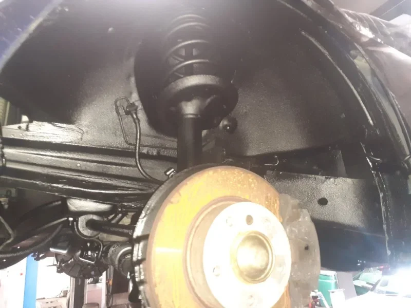

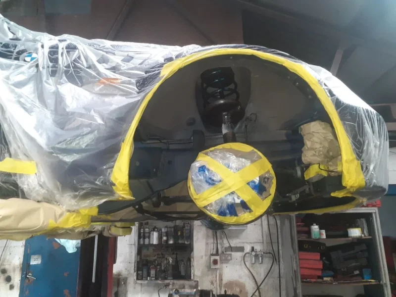

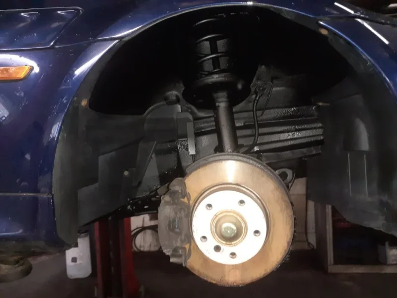

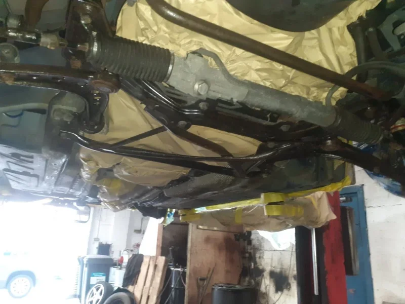

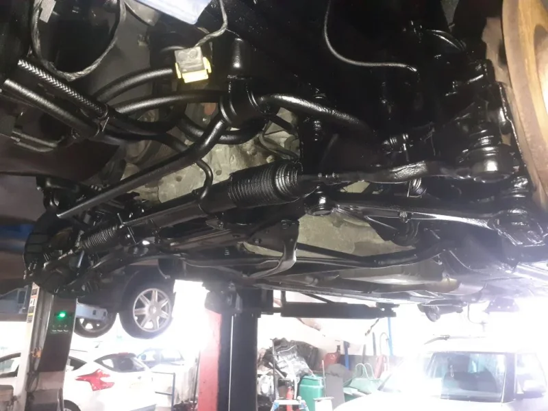

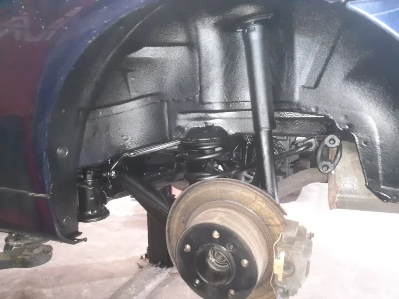

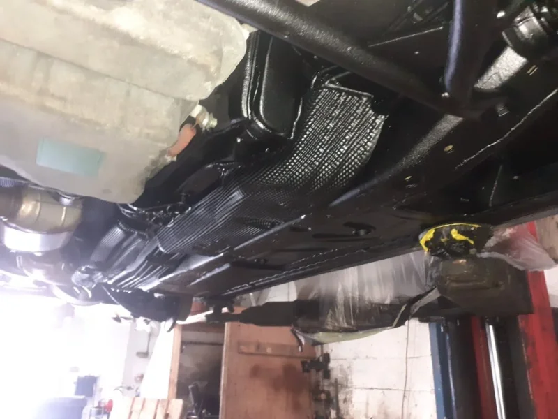

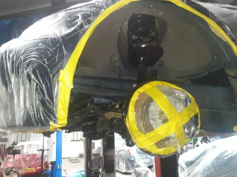

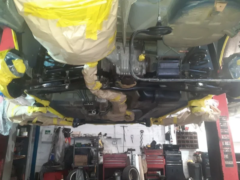

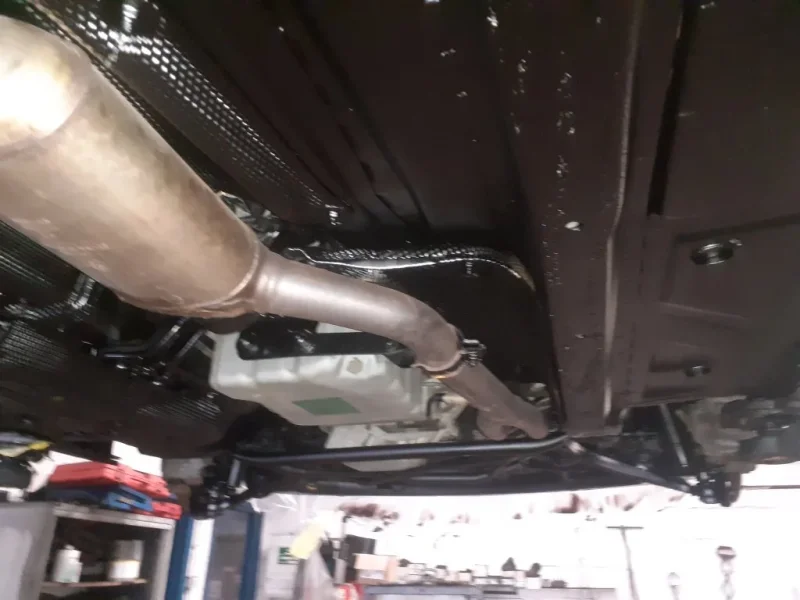

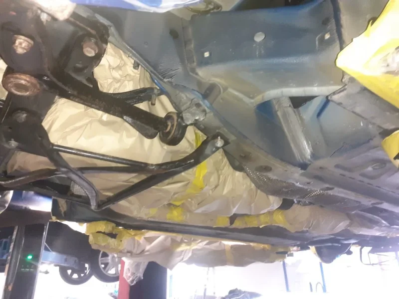

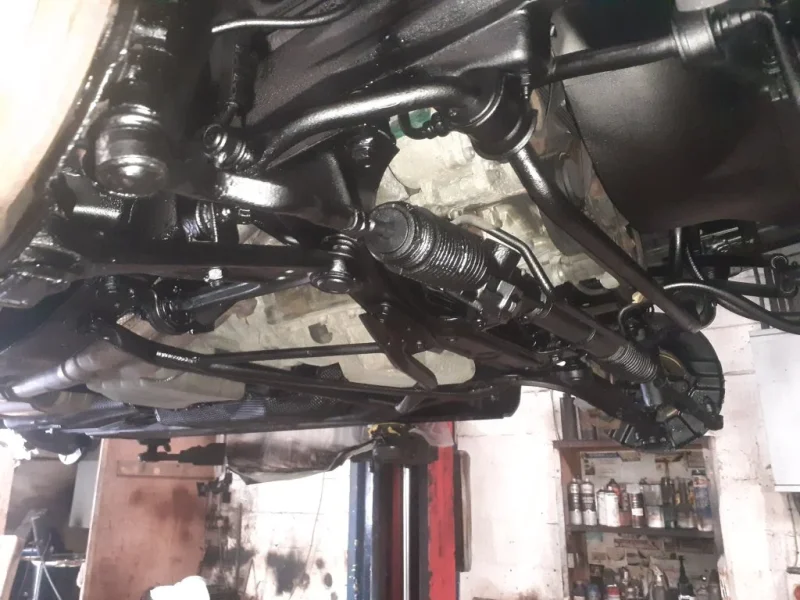

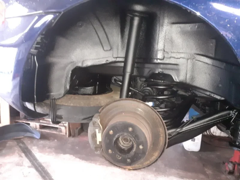

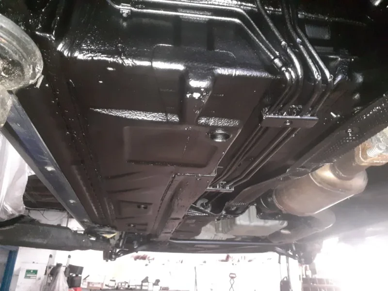

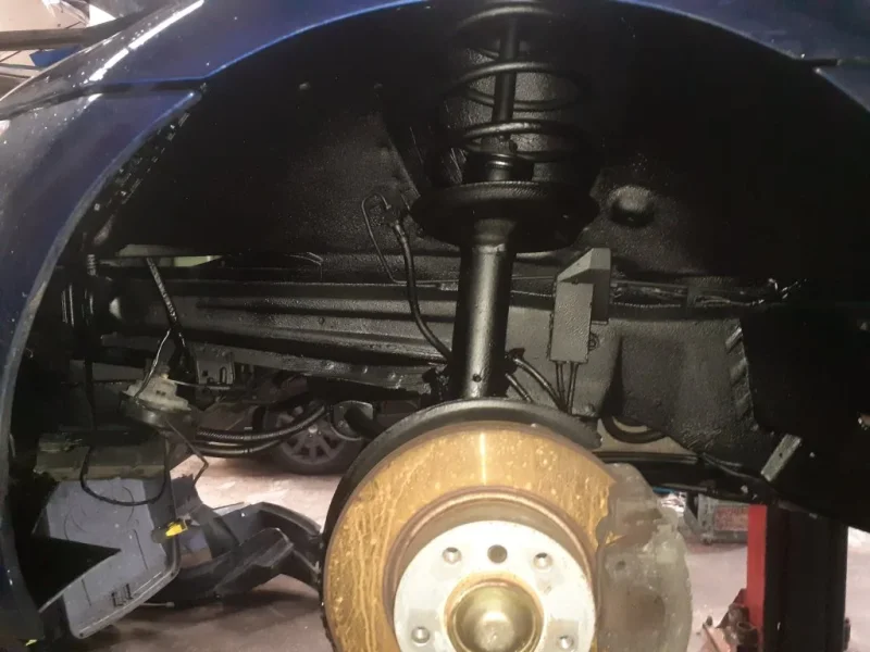

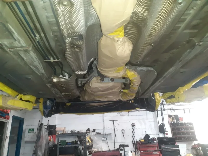

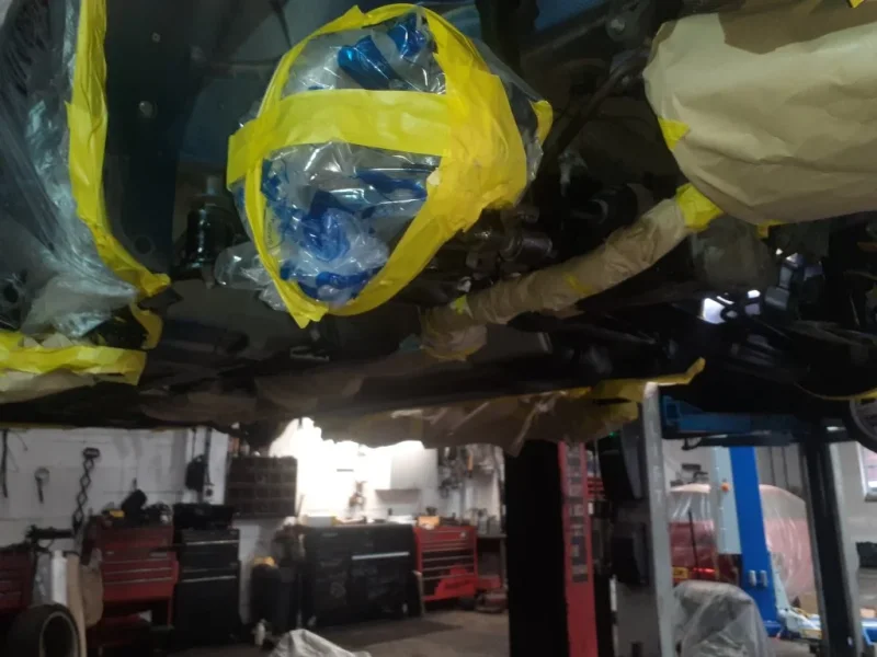

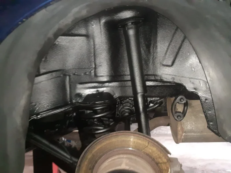

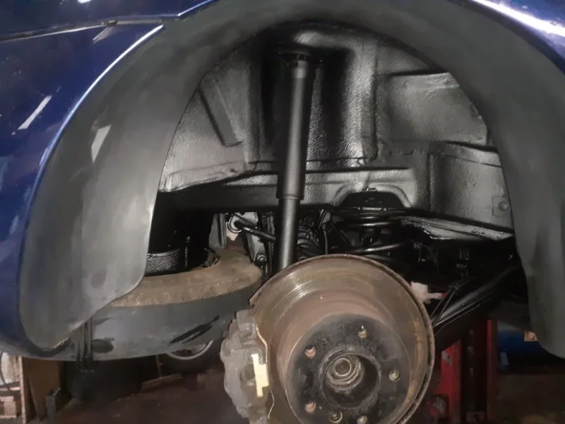

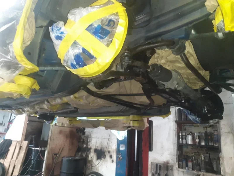

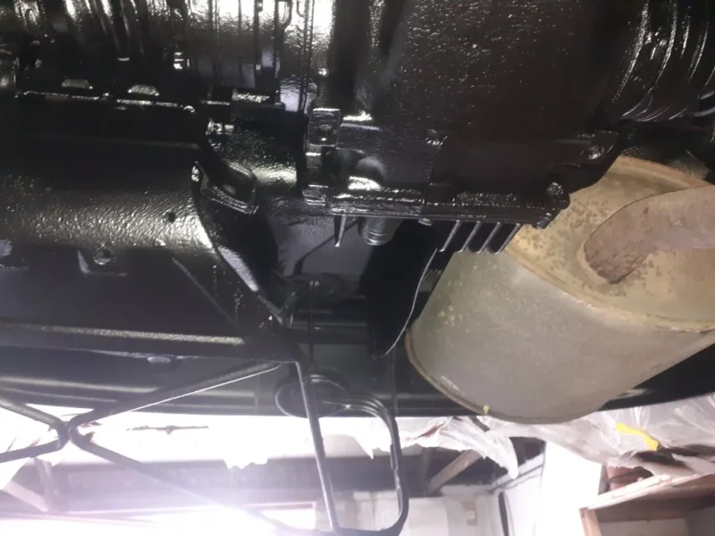

The new project car is so nice I decided to treat it to the full Dinitrol job - done professionally at Duke Street Garage in Rochdale. And bloody hell it looks good under there. Really impressed. See attachments.
Reminder: this is a 35k mile car, Japanese import, garaged most of its life.
