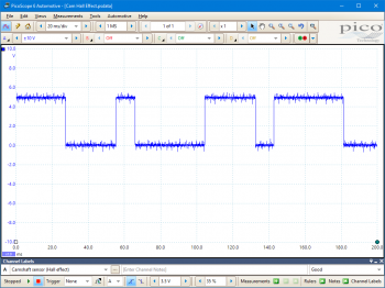

I'm not clear on exactly how a camshaft sensor works. I think it's a binary high/low device but all the same needs to switch cleanly at the right time to produce the correct waveform, like this I believe:
So just because the camshaft sensor is producing output it might not be the right output.
I've done several exhaust sensors with no noticeable change in performance. I've only ever done one inlet sensor and the car I did it on drove like a rocket ship after compared with any other 2.2. So I have a strong suspicion that it's not just a case of working or not working. But there's shades inbetween.
