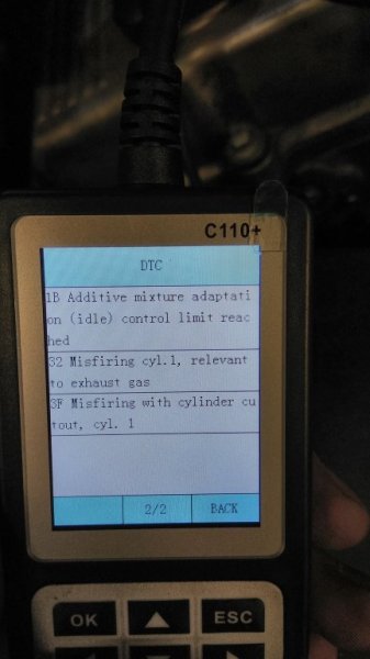

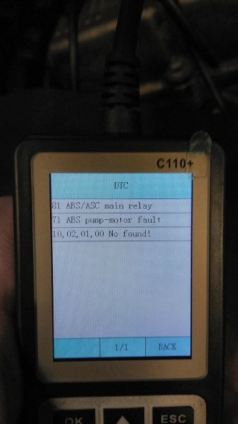

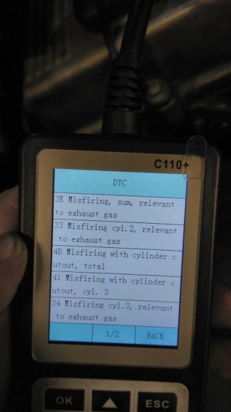

So I plugged the reader in, pressed a few buttons and got this:
I changed the spark plugs while I was there and cylinder #2 came out with oil on the coil plug and the spark plug. I've kept the old spark plugs to double check how they've worn

Oil on plug points to failed rocker cover gasket fueling problems may also be down to leaking rocker cover gasket letting in unmetered air had this on the 2.2 earlier in the year that had cracks in the plastic rocker cover replacement with new gasket solved that

Oil in and on plug indicates failed rocker /cam cover gasket leaking also fuel adaptions indicates its running rich as its probably sucking air in through the failed gasket its seeing unmetered air in the exhaust telling it is running lean check the plastic rocker cover for cracks as well had this on a 2.2 not long ago

Interputating the codes is the key over adaption and misfires point to vacuum leak oil leak points to failed rocker gasket and pos source of air leak

71 is the ABS pump or most likely the module attached to it. You must be getting the ABS light? I've not seen 81 before but it's saying relay so would be worth tracking down the relay associated with the ABS and checking that. Unless it's an internal relay in the module itself. Not sure.

Is there any sort of instruction manual that came with the cider and will help you read the codes? @Bringit96
Nope, I've had a look online but can't find anything conclusive.
This is the only thing I've found but still doesn't clearly say what errors are: http://www.endtuning.com/bmwcodes.html I'll have a look and see what I can make from it.
It came on once when I went over a bumpy section of road at some speed...It went off on its own short after

C110+ Code reader : End Tuning BMW Codes
3E Misfiring : 62 Misfiring multiple cyl.
33 Mis Cyl 2 : 51 Mis Cyl 2
4B Misfiring with Cyl cutout : 75 Misfiring multiple cyl
41 Mis Cyl 3 with cutout : 65 Mis cyl 2 with cut out
34 Mis Cyl 3, relevant to exhaust gas : 52 mis Cyl 3
1B Addative mixture : 27 Addative mixture
32 Mis Cyl 1 `: 50 Mis Cyl 1
3F Mis Cyl 1 with cut out : 63 Mis Cyl 1 with cut out
Nothing conclusive....?
