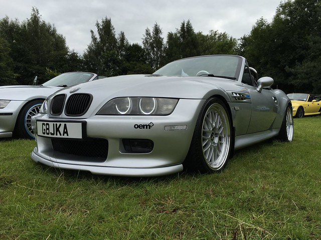

Z3 - 2000 2.8 Roadster
I've had 16's, 17's, 18's and even tried 19's on mine and its lowered. All are fine without any problems apart from 19's require a little bit of the arch trimmed back. I currently run staggered 18's in the summer and staggered 17's in the winter. I don't really notice any difference between any set as the car is low and quite a hard ride anyway.
16's
17's
18's
19's
As long as you get the wheels within the correct specs you will be fine increasing the size.

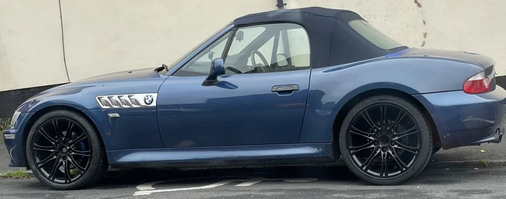

Right an update. Maybe helpful for anyone for future reference.
I got mv2 18 inch staggered rims, Front 8j x 18 ET47, Rear 8.5j x 18 ET50. I bought tyres sizes for front 225/40/R18 92Y, rear 245/35/R18 92Y. They went on with no issues to rubbing on back or front. So all is well in the end.
Hopefully when this covid goes away, we can have a meet up. Stay frosty
