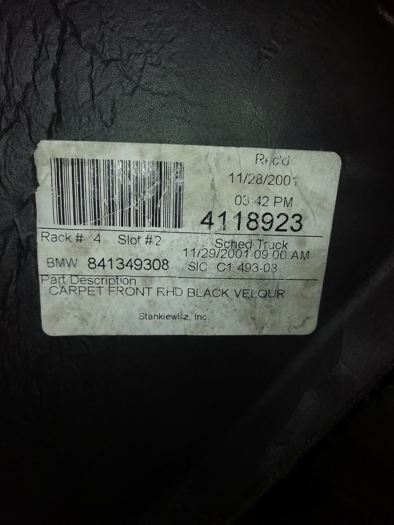

Sure Lee said something about the previous owner having dyed the original carpets blue?!?
