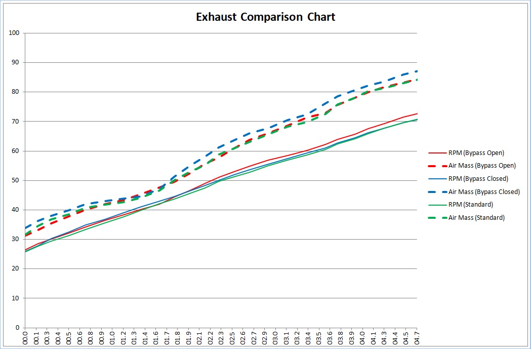

It's quite easy to record data, but it is very difficult to be consistent in each test.

I re-tested the standard exhaust system and the bypass exhaust system (3 runs with each system)...
There are a few observations (thinking aloud)...
a) The open bypass system is the fastest:):thumbsup:, but not by much - so bang for buck (time and effort, not money), it is not the best modification:(.
b) How can the system with the open bypass be the fastest, yet not have the best air mass flow rate?
c) The increase in air flow rate drops at around 4500rpm - could it be VANOS related?
d) I've always assumed that air flow rate is proportional to speed - this chart shows this is not the case.
e) I've had to delete some tests (due to spurious results), so the averages are only over two runs each. I'll do five tests for each system in future. I will be able to delete the poorest test from each dataset and still have enough data to get some meaningful results.
