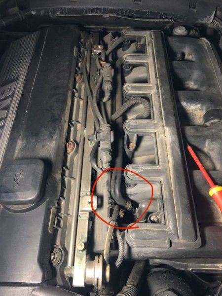

ok on further inspection I’ve found this -
Could this split in the pipe be the issue??

Answer is yes part of the ccv system so you are getting a massive air leak there causing idle and running issues. I always reccomend a smoke test on these engines to find any leaks they are so dependant on a closed vacuum for correct fueling

I've had a bit of a lumpy idle for a while, mainly when the car is cold. I can get rid of it by clearing the adaptations in INPA but it comes back slowly. I recently found a split in the same location, same hose on mine albeit not as big. I have changed the whole CCV system (that pipe is part of it) but haven't used it enough yet to see if its cured the idle issue.
A split in that hose will definitely cause some sort of idling issue.
Don't plastic covers hide a multitude of problems.

I’ll look for a replacement, could have saved myself £115 on a new sensor
It’s a pretty big gash! Still the genuine BMW part so I suppose it’s lasted well for 21 year.
I’ll keep you folks posted after the replacement
Cheers, Jack
