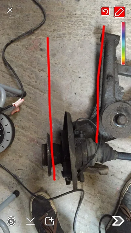

Fitted the new trailing arm yesterday with the help of a good friend. It took all in all about 6 hours (with a few breaks etc).
The car feels a lot better now but I still need to get the alignment checked properly. There is still a slight pull to the right on acceleration. I don't know if the different tyres on the back are contributing, or even worn bushings?

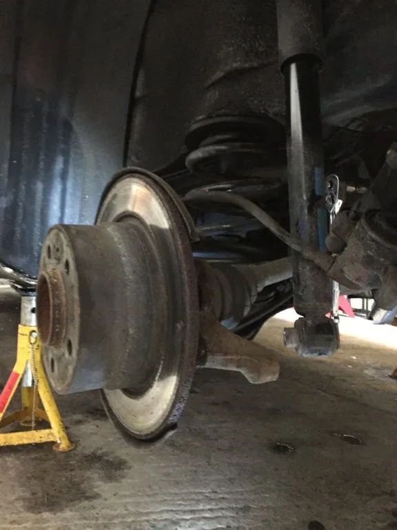

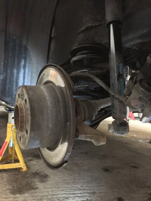

Car on jack stands in my mates unit - wouldn't have been able to do this at home. Some large breaking bars were needed for the differential Torx bolts!

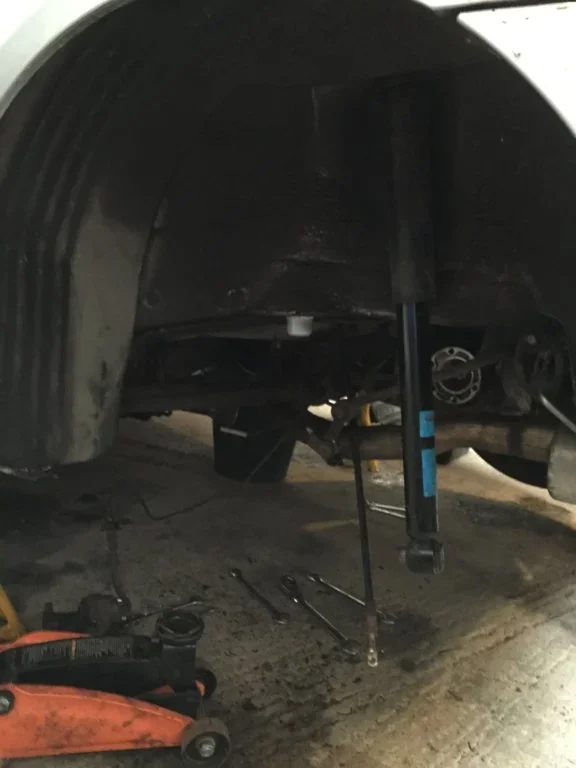

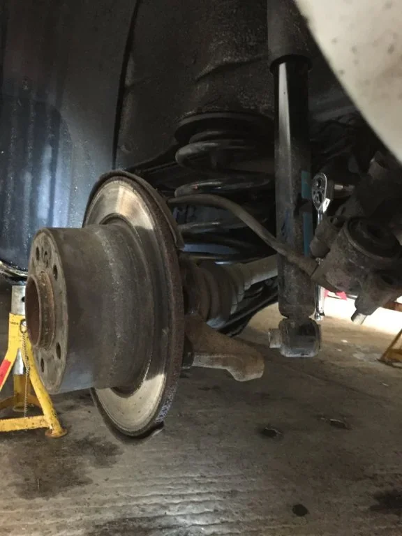

Strut and caliper removed. Cable tied the caliper to something, no need to remove and plug pipe.
Releasing the drive shaft from the diff
After the removal of some more bits the last two bolts were ready to be removed. Access is restricted but not too bad!

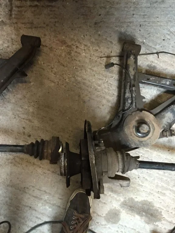

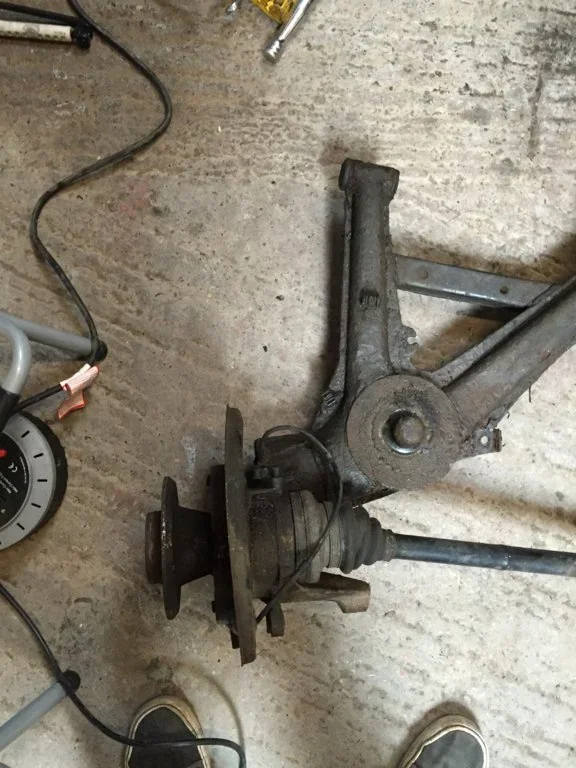

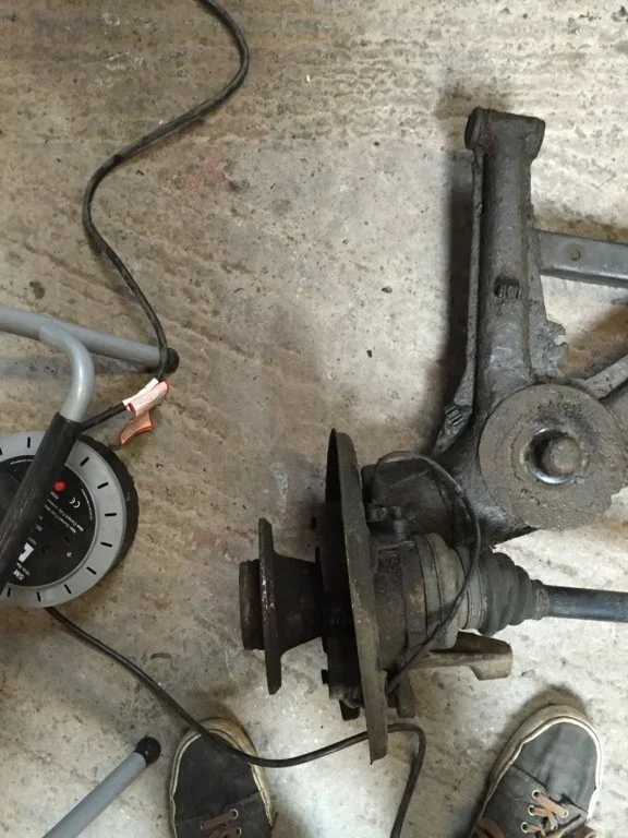

Old trailing arm and hub.
New trailing arm - It's only the steel guard thats bent!

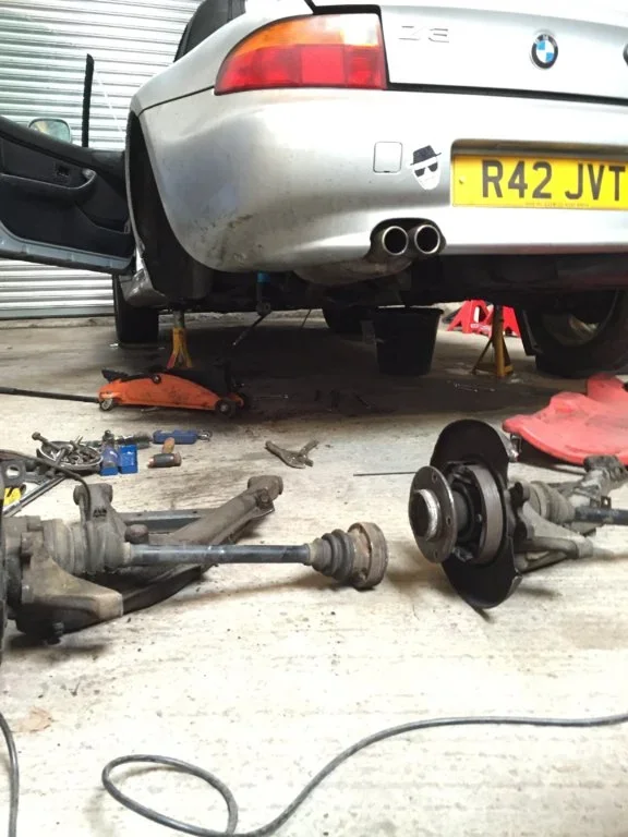

Quick photo of everything out
Side by side pic - New arm on the right.
