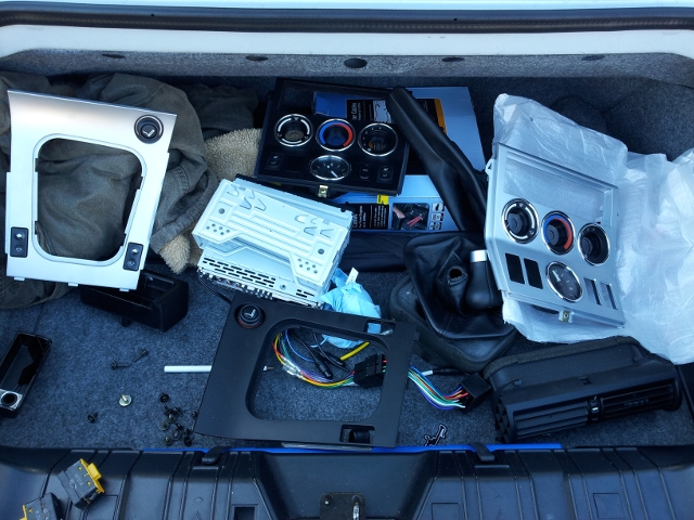

Speaking as someone that has removed the entire console on my Z3, it's a ballache.

Did that lot used to be a car Gaz?
Parts of 2 different ones... I was starting to sweat a bit at that stage, soo many screws and clips.
