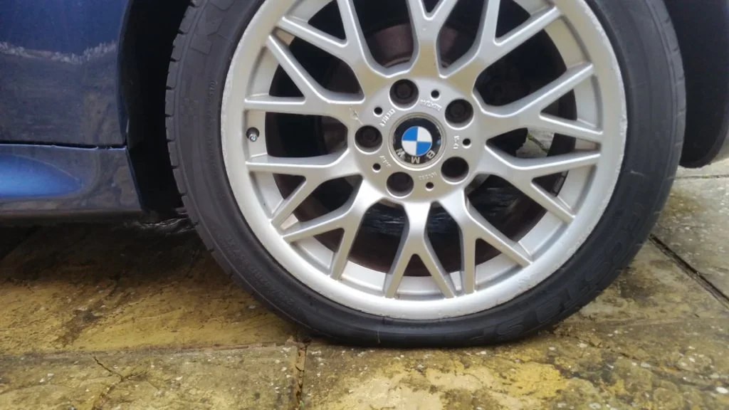

245/40 ZR17 95Y
Recommendations?

Think you need to get some sky in that round fella!
More top recommending :p
Have put 2.2 bar of sky in the round, see how long it stays inflated. Should get me to the local tyre replacement centre.
But what to order ? Pirelli pzero Nero GT has a nice ring and sound nice
Could just be a leak at the bead seat due to corrosion, if not why not just have a puncture repair?
I had the same problem with a slow leak thinking it was a nail in the tyre but the garage said it was corrosion in the wheel so they removed the tyre coated the wheel with a rubber paint popped the tyre on and bingo more problem.
Why not take it off and see where the leak is with some soapy water. If it is leaking around the rim that is easily fixed, if it is a nail or something a repair is still possible if it is not at the edge of the tyre.
I wouldn't want to have non matching tyres across the same axle - what's on the other side?
