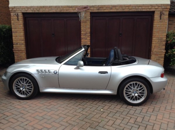

Good afternoon all, I am looking to purchase my first Z3 at the weekend. Being an Audi man normally I don't know a great deal about the Z3 other than it looks great! I've got my eye on this 2.2 auto with FSH and 95k on the clock. I know the 6 cylinder is generally bullet proof and mechanically I'm pretty accomplished however, are there any specific "gotchas" to be aware of beforehand. Secondly apart from the obvious power difference is a 2.2 or a 3.0 the better car?
Many thanks in advance,
Simin

Welcome Simon! The car in the pics looks just great! With 95k, I will go for it!
Good luck!

That car looks nice Simon, but if you're not in a tearing hurry try to get a test drive in either engine size which takes your fancy. Where are you located?, someone may be local enough to offer you a drive or even just a ride in their pride and joy to help you make your decision. Welcome to the forum from me near Lincoln, not a Z3 owner any longer.

Welcome from Aylesbury :p
The 2.2 sounds awesome :thumbsup:
Wow that zed looks really nice :happy:

Thank you Gaz, the do seem relatively easy to work on (which is what I'm after) I've my eye on the silver one pictured but I have been offered a Blue 2.8 with 126k but it is nearly 200 miles away - I didn't realise the power difference was so large!
I'm looking forward to either sitting in my garage

I'm not in a massive hurry but when it comes to cars I go very much with my gut instinct and the silver beauty just popped out at me as it sat so well and looks "right" I've spoken to the trader who is selling it and he sounds straight up and he had it in part ex from an old boy who spared no expense when it came to ththe car. It was also reduced by 1k as he freely admitted to needing the space on his drive and that this is the wrong time of year to get good money for it. I have been offered a 2.8 at £2400 but it has 126 (nothing I know) but it is over 3hrs away and the guy seems relatively keen to move it on but to be fair it seems a very genuine car! at £2400 it's also considerably over my initial budget for a Z3 so where do you stop? Before you know it you are at 3k.
I have checked myself slightly as the car is going to be for the summer and whilst I love my powerful cars, I'm buying it for the experience and the engine note more than anything else. Again coupled with the experience, an auto will make for very easy cruising - I love my 330d and its auto box and the point and shoot driving style. Whilst the 1.9's are cheaper and more plentiful I know I'd wish I'd gone for the 6 pot so I think the 2.2 is a good compromise and I'm sure it will be pokey enough.
