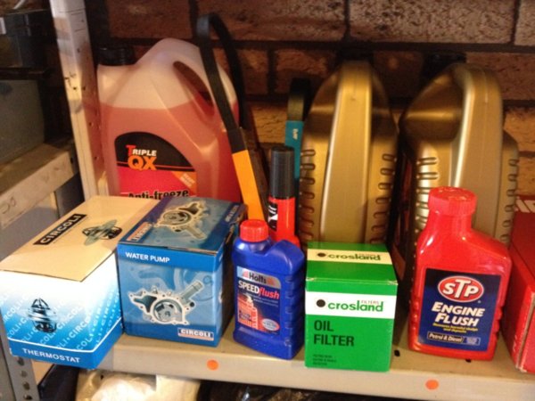

Such as drinking oil like there's no tomorrow?I do all my own servicing and minor repairs from a home workshop. Away on holiday till Friday so will flush/service week after then a healthy test run. I had a couple of RX-8's in the mid/late noughties and they had the same oil cap and dipstick milking characteristics (amongst many...many...other interesting 'characteristics')![]()
That's good cause as it's your car you'll do a more thorough job than a garageI do all my own servicing and minor repairs from a home workshop. Away on holiday till Friday so will flush/service week after then a healthy test run. I had a couple of RX-8's in the mid/late noughties and they had the same oil cap and dipstick milking characteristics (amongst many...many...other interesting 'characteristics')![]()

Did we? Yes that's right I'm sure that's what we did!It does look like a circulation problem, have you run it with hteater in the car switched to hot, we had to do that and hold a fast idle for a few minutes when we did @Grumpy car a few weeks ago before it would fully circulate.
Yes had the heater at max and the fan at 4 while on a run and when sitting at fast idle for around 15 mins. Still lower hose stone cold. No air coming from the bleed screw.It does look like a circulation problem, have you run it with hteater in the car switched to hot, we had to do that and hold a fast idle for a few minutes when we did @Grumpy car a few weeks ago before it would fully circulate.
