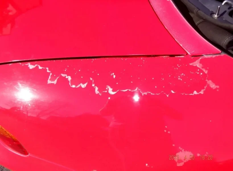

What is wrong with the paint ?

Another option could be to just get the bad panels resprayed and see if the rest will come up with machine polishing, i know you can get a lot of sun fade out. Maybe Russell O could advise if it is possible and be able to view it to give you a price.
Russell O hope you dont mind me sending him your way.If you do i appologise
I believe he in Leicestershire
Was thinking about that, but there are a few other small areas. Will get in contact. If only for advice. Need to get rear springs done first as both broken.

Later this week my mate is letting me practise on his 02 325 as it is s-te and got lots of sun fade, swirls and scratches. So i will take a before and after photo to see how it comes up to give you an idea. Bearing in mind he is just happy to see some sort of improvement and the car has not seen polish since around 2008 as it was my sons before he sold it to my mate

How much can you polish out with the clear Coat?

Reading up on the net you should have at least 38 microns but can be as much as 102 micron and a medium cut should take away 2 to 3 microns but this can vary.
