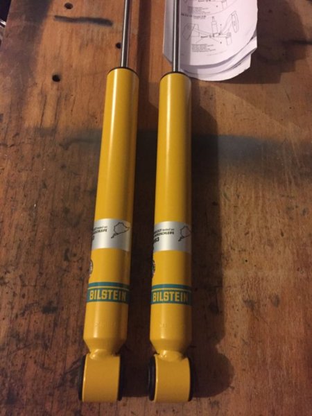

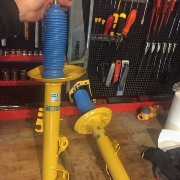

I went for the b12 set up yes. I've always liked bilstein as a brand and have used there b12 kit before on other cars and it transformed the handling so I decided to do the same with the z3 as the existing suspension probably would have coped with the lowering springs but decided it needed freshened up.

  • New H & R lowering springs all round on Bilstein B12 sport shocks (b8's on front and b6's on rear). Mounts refurbished and bolts / gaskets replaced.

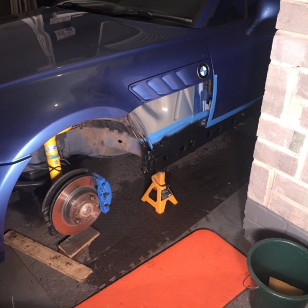

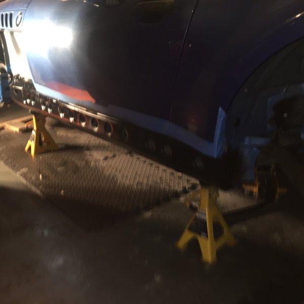

  • Rust rectification - the sill design manufactured by BMW is to be honest rubbish. Offside completely stripped back to bare metal, all rust removed (all wheel arch liners removed, jack points and deflector trims removed), prepared and treated to waxy oils finest primer, stone chip and underseal. Outer sill long past saving so replacements being sourced via BMW as to find good used versions is like finding a needle in a haystack….
  • Rust rectification cont'd - nearside to be completed as above.

Decided to replace the wishbones, ball joints and drop links so they were changed over the weekend. Fitted poly bushes too.

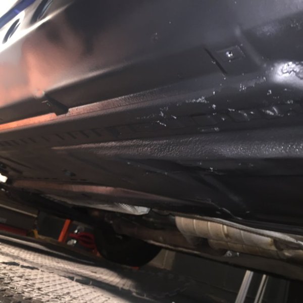

Also managed to get the nearside outer sill panel off also and the inner sill and underside prep'd, treated and suitably protected, primed, undersealed and stone chipped. So now the bottom of the car looks tidy. Managed to get chassis rails and floors painted too.
New sills ordered late last week from BMW arriving tomorrow and ordered all new fixings for sills, jack pads, wheel arch liners and also ordered new trim panels that sit behind the rear Jack point in front of rear wheel arch liner as they were shot too!
Painter lined up also now to paint sills to get the car put back together and then it's off to get alignment and tracking done, MOT'd then to the painters for some cosmetic tlc....

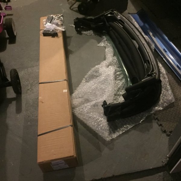

Wee further update....
Sills arrived today along with new plastic trims and also purchased new 8mm self taping fixers too for liners from BMW....
Also managed to pick up a new roof too!
Roof will need to wait to be put on however until I've got the car back together after sill replacement.

That's not a 'new' new roof is it?
Would like to know the cost if it is.
Craig Giblett
Aug 16, 2016
28
Edinburgh
Sport
It's not a new roof no.... Bought a good condition used roof which I managed to source online... Damage, tear, cut and worn stitching / fabric free!
