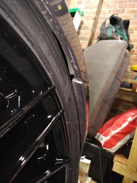

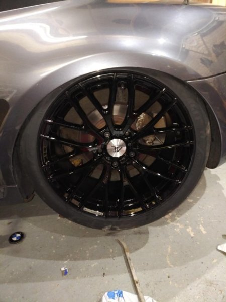

The rears are 265/35/18's and I was concerned they would rub a bit. When I fitted them I removed the rear spring and pushed the suspension up until it was on the bump stop. The tyre just touched the plastic liner but fit perfect. There are mm's to the arch lip so it couldn't be better. I was thinking about correcting the camber but think it will have to stay as it is.
to the forum from me too in Staffordshire. Eeek not much wiggle room on the back now
