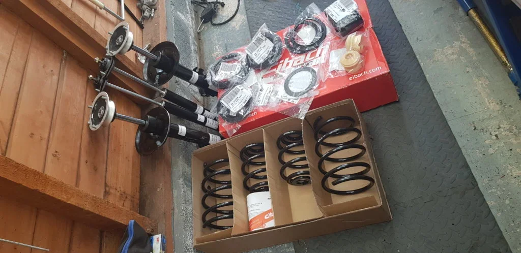

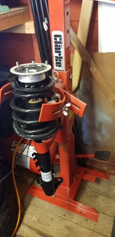

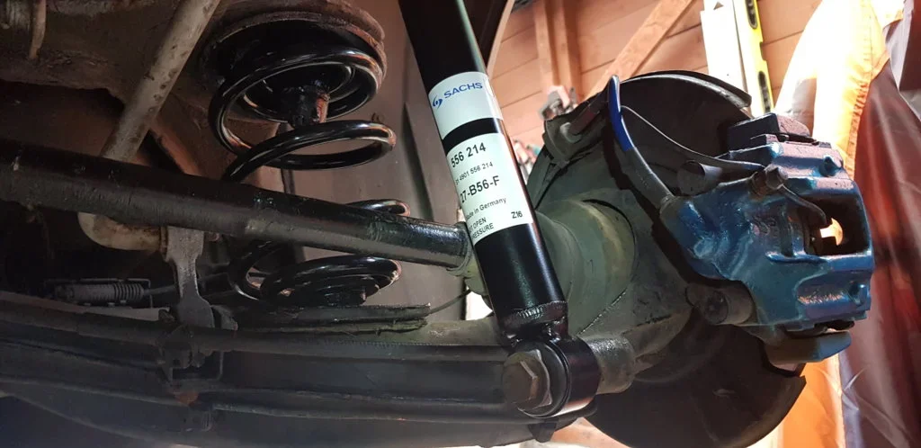

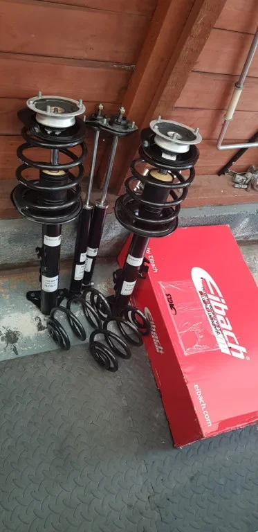

Well in the end I went with new Sachs gas Struts and Eibachs
The Eibachs were from Poland, came very quickly and were only £157.
The struts cost front £133 for the two
Rears £90 for the two including new Meyle heavy duty top mounts
Meyle front top mounts x two cost £40
I then changed the front spring pads, washers, MSport bump stops, spring plates, and sleeves etc, which cost another £84 from BMW.
All in cost £504.
Now a bit more body roll, but certainly more forgiving over bumps.
