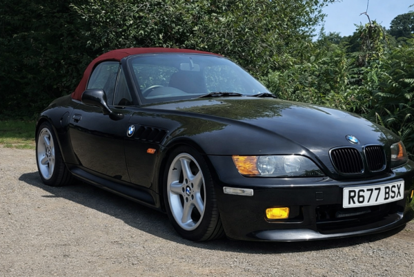

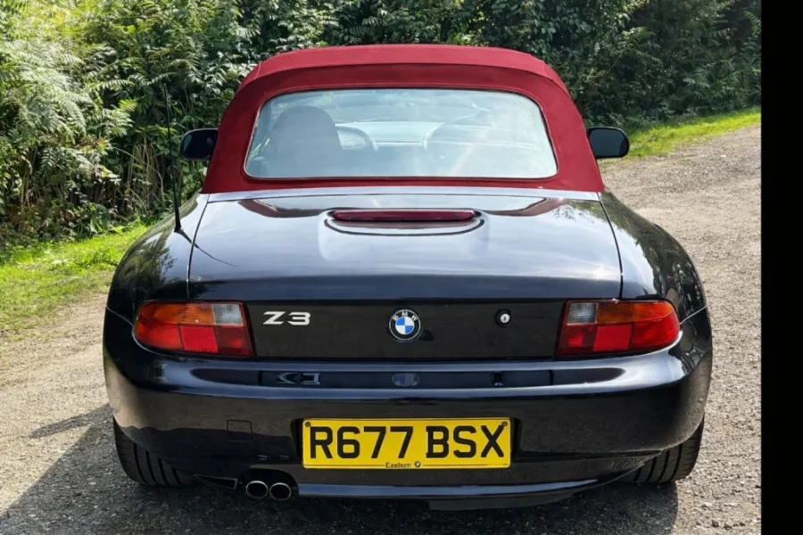

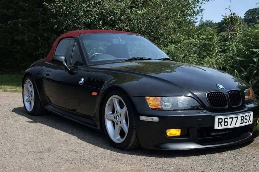

Im going for red . Should look like this courtesy of chatgtp
That will look nice .
I am on the verge of needing a new roof have been toying with a colour change
Uk model Orinoco edition all seem to come with a black roof but European spec models quite often come with a beige coloured roof which i quite like
My only reason for not full on committing to this is i am worried about how clean it will stay and how easy will it be to clean if getts dirty.
So may end up with black again.
Stephen.

Unfortunatly im one of the saddos that doesn't get it dirty so thats not something I worry about but I can imagine the marks on anything but black roofs appear quicker.
