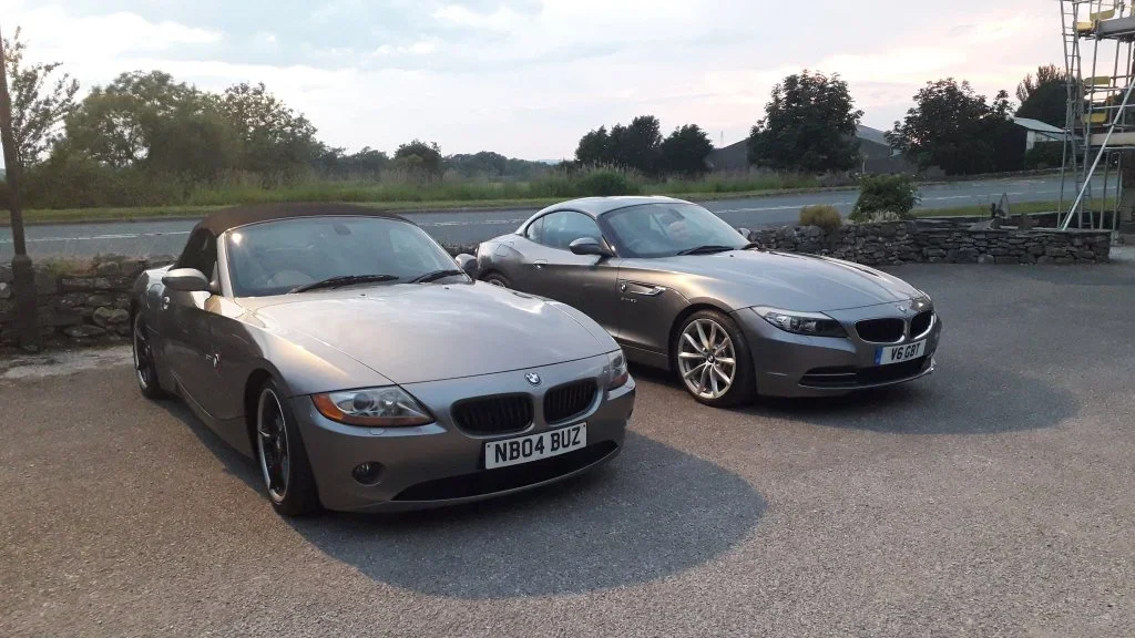

Hi Lee
Do you still need a headlight? I have had mine replaced so you are welcome to teh old ones if they help you.
They are undamaged bracket wise but a bit hazy after 150k miles. They work were working fine before RBM replaced them for me.
I have attached a picture of how they looked prior to replacement

Hi Lee
Hi mate, that would be really handy if you still have them.
