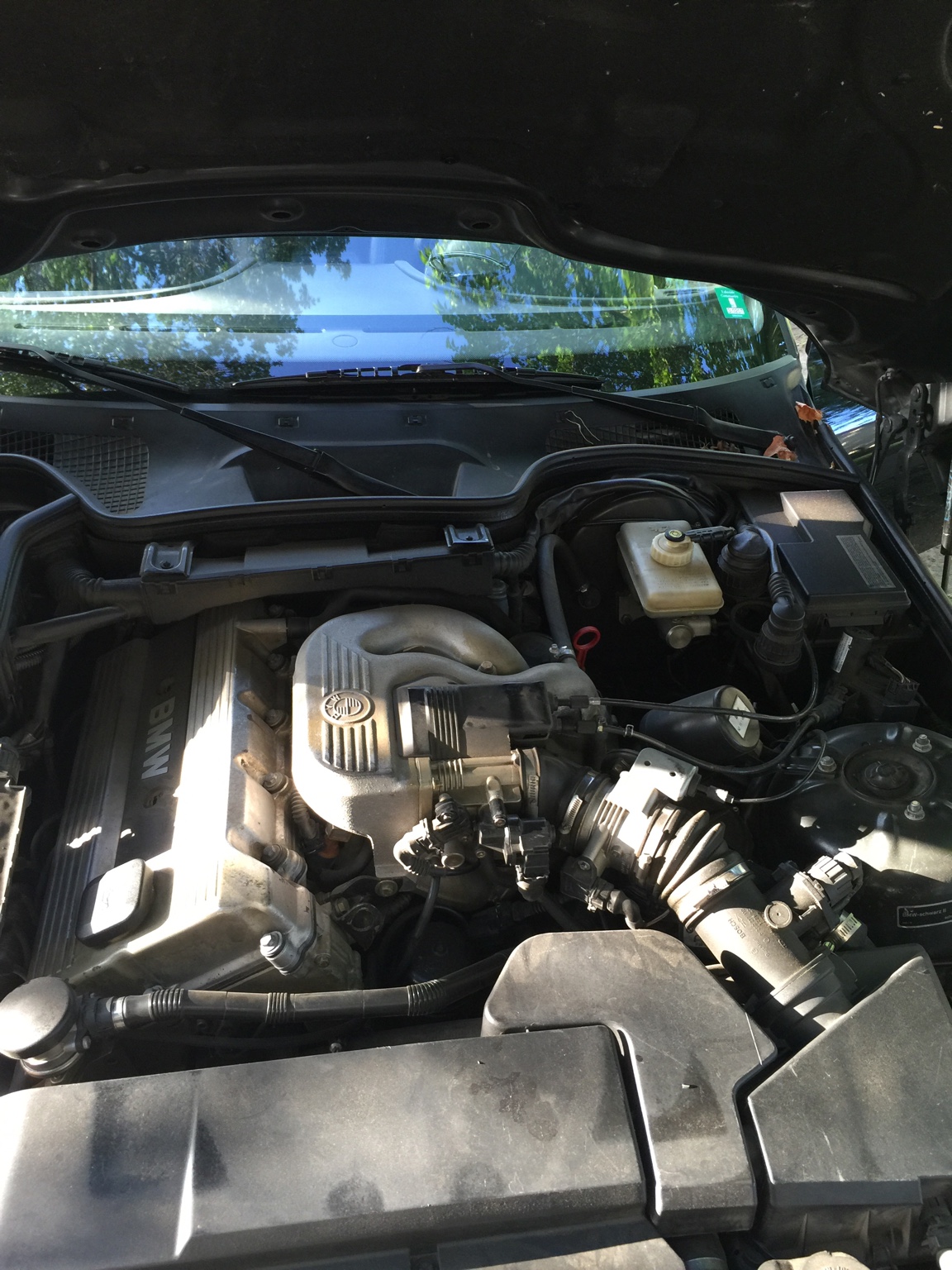

It needs some TLC, but all the base things are in good shape. It has a new to the car M44, Remus exhaust, Catalytic Converter, struts/shocks, clutch, battery, W/HK sound system, heated seats, clean, but seriously needs hood paint. The body is totally straight with minor door dings. My initial observations were major vibration under load (Flex disc) and a huge exhaust leak somewhere. Reading the codes showed it had an O2 rear sensor fault and there is a misfire on Cyl #4..
It needs work, so the price was right. I grew up with Verts and while the 318ti Cali is nice for a big sunroof, it's not a vert. My main motive was price, shell, interior condition and that I have always liked the Z3s. It beat out a Porsche Boxster I was looking at the same weekend that was $2,200 more with a blown motor. I'm happy with this one as they are easy to renew.
A lady owned the car and used it for 180 mile daily commutes. High mileage, but reportedly highway miles. I suspect so as the suspension arms and steering components show minimal wear and tear.
I actually wanted a Z3M, but this was less than a 5th of the going cost and I have immediate available spares for most all that needs repair. Motor runs strong, but needs an oil pan gasket. Also needs tranny mounts and a flex disc.
I started my renewal list. Some things may be overkill, but I like to fix it once while I have things apart, then not have to mess with it again for awhile.

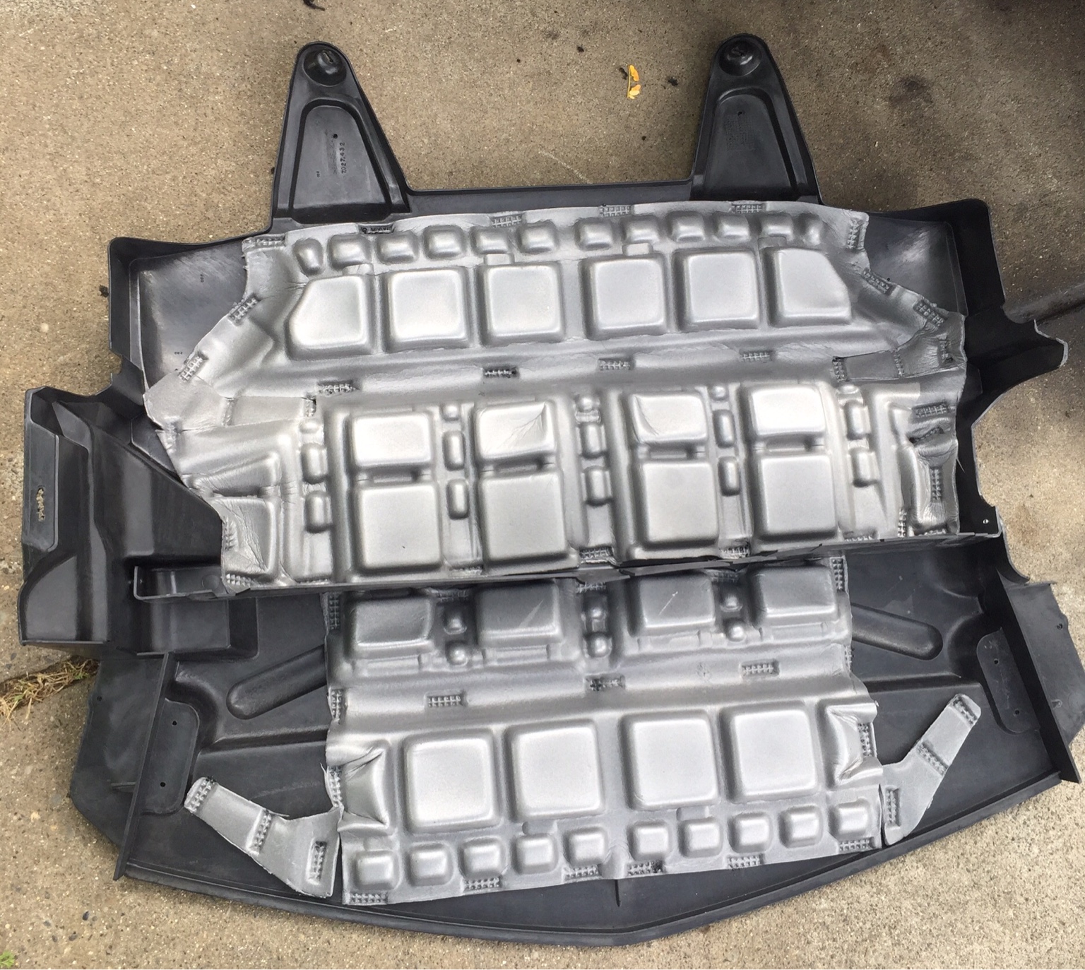

  • Replacement underbody shield

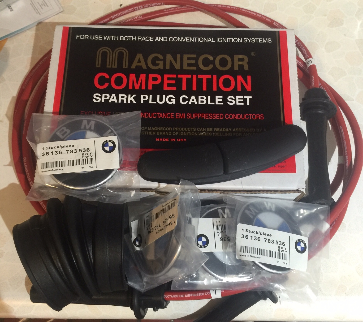

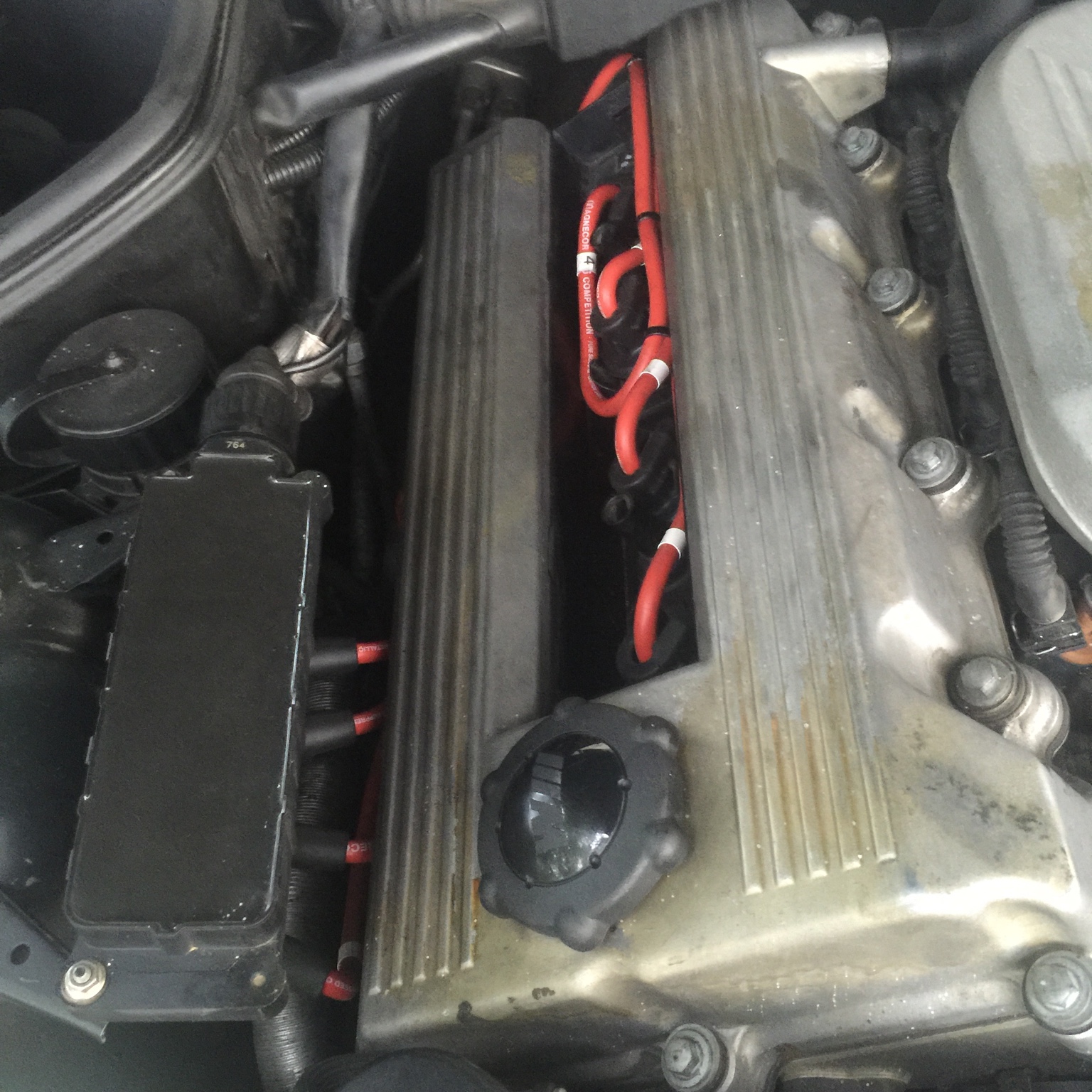

  • Magnecor 8.5mm ignition wires

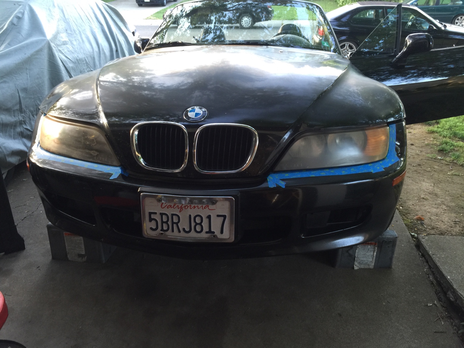

Really bad headlight wear. I started to polish out the headlights. This was after 40 minutes of polishing. easily 50% better, but still needs more polishing. I will likely replace for a HID set for my old eyes.

  • Power washed the underside, so I could better see what I am working with. I hate working on greasy cars on an ongoing basis.

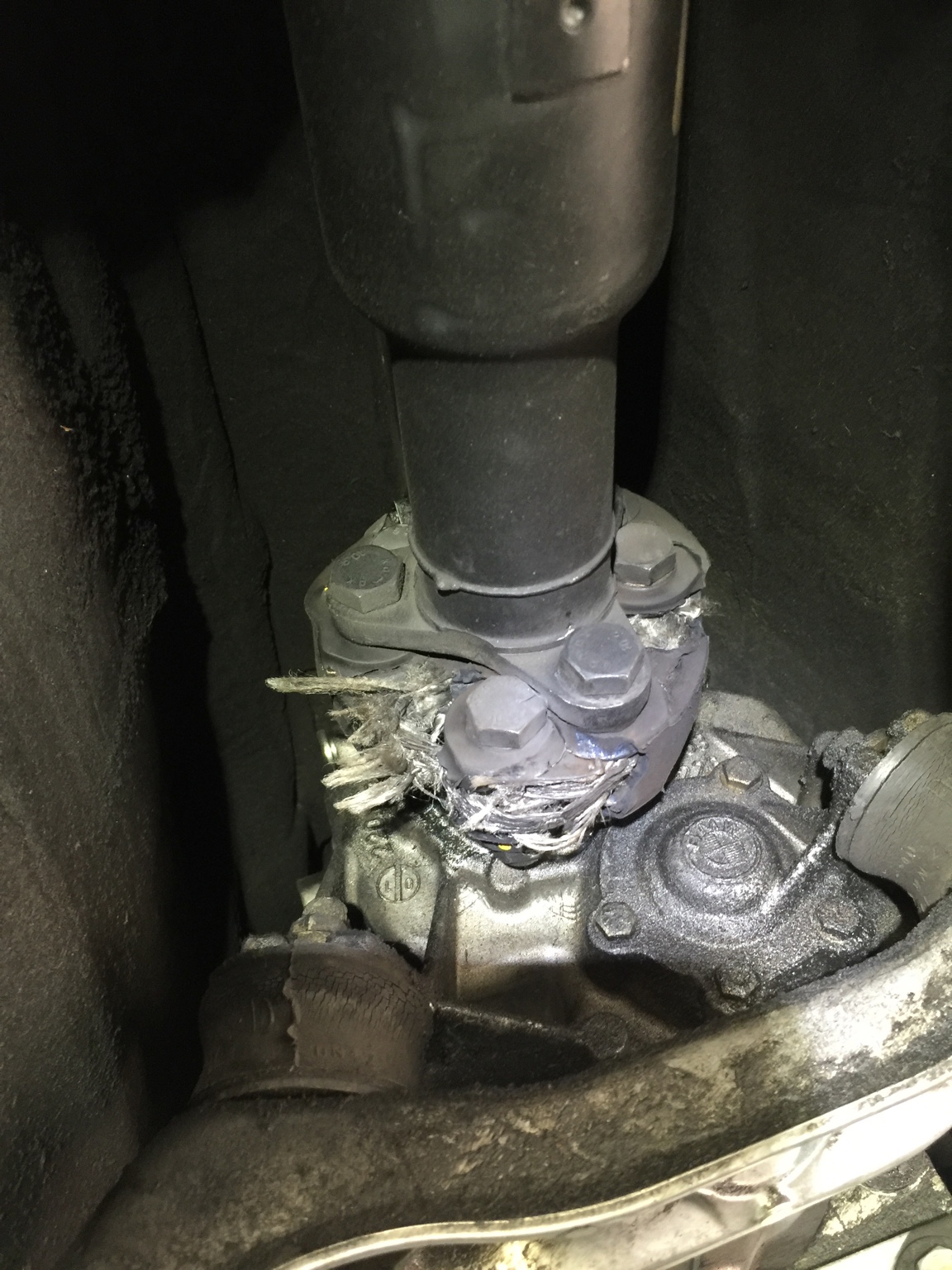

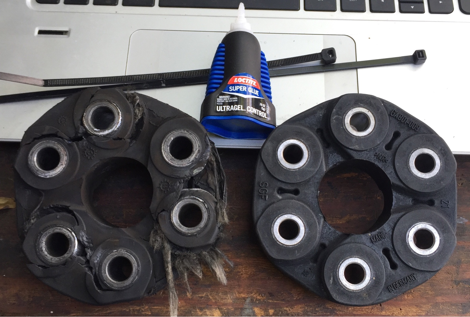

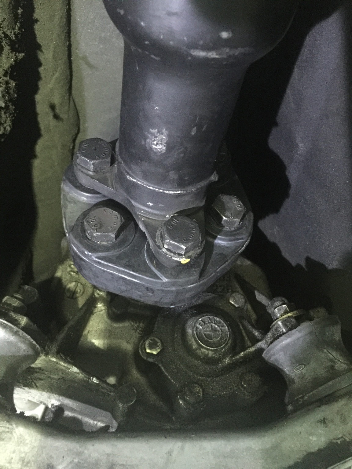

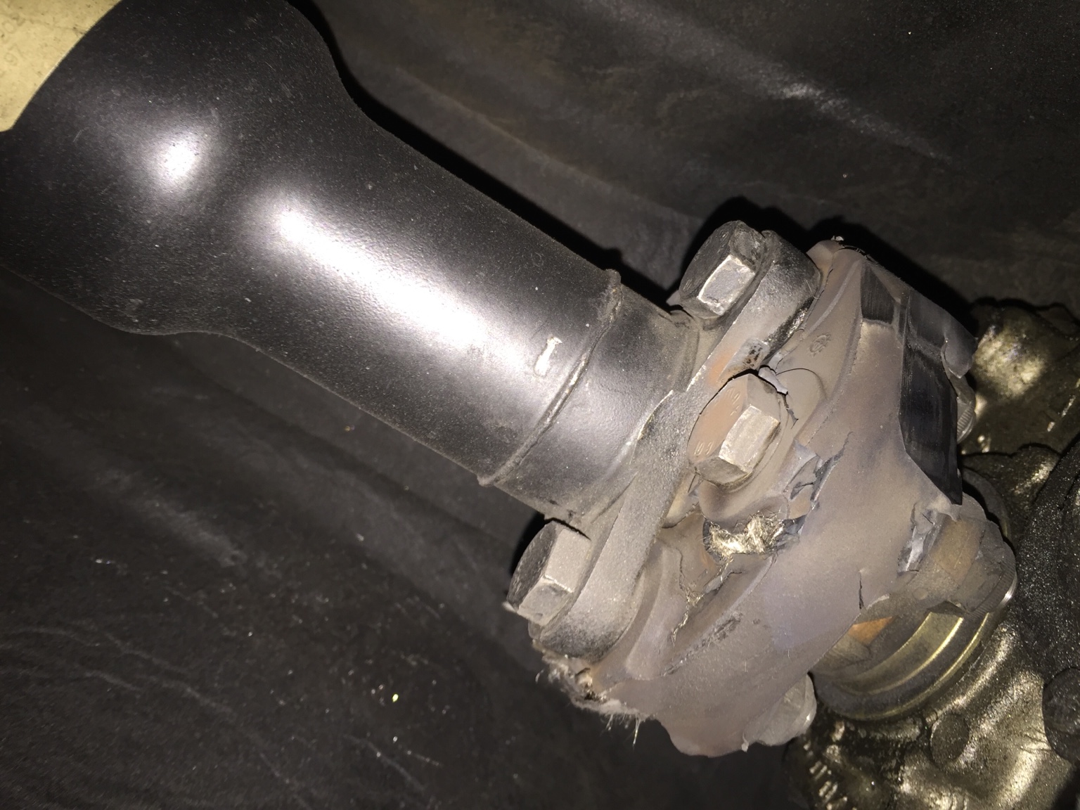

  • Removed the shredded Flex Disc and wasted a bunch of time trying to figure out why spare Flex Disc wouldn't fit. Turned out my spare was for an automatic. Good lesson learned by wasting 4 hours I will never get back.

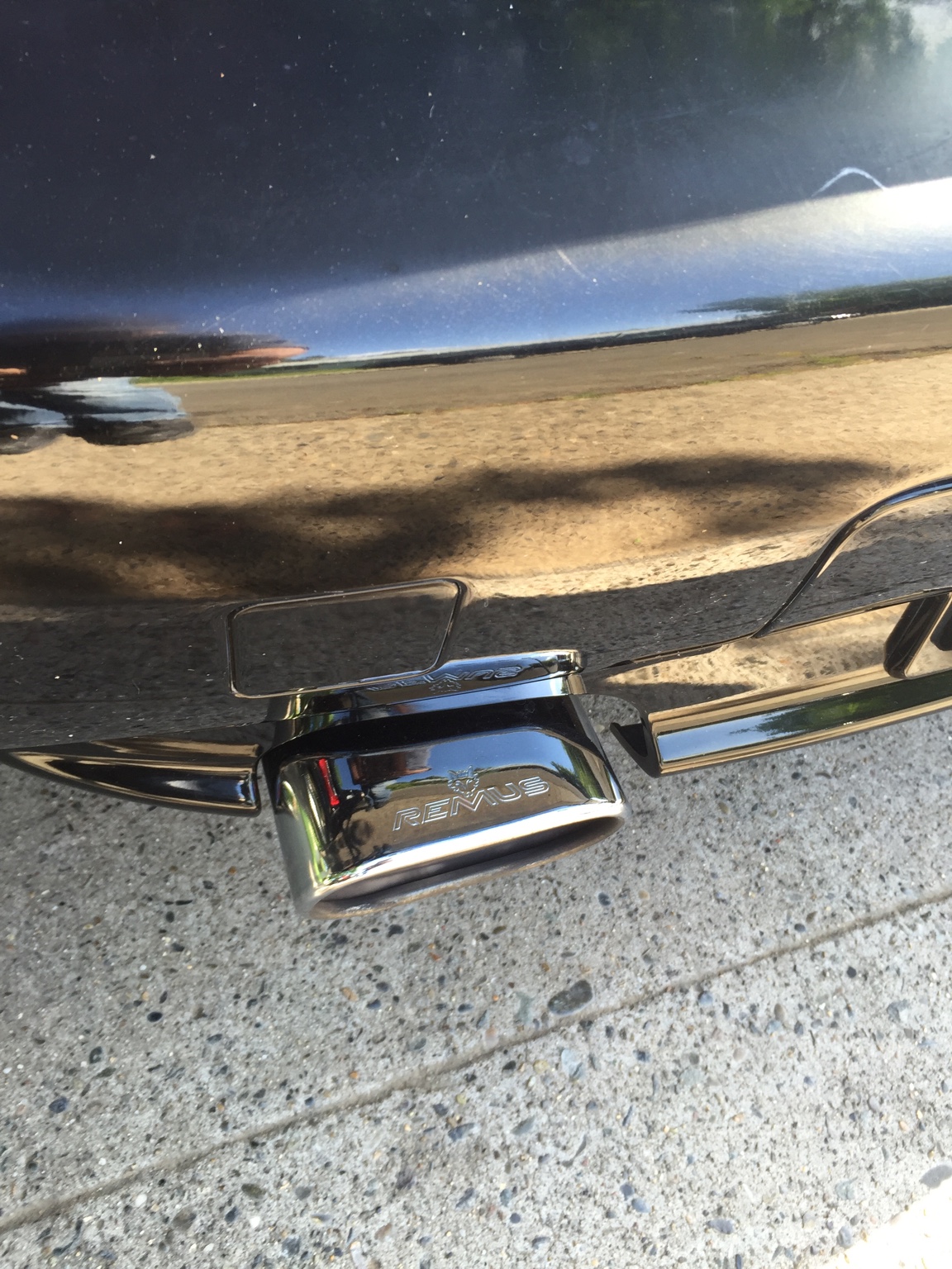

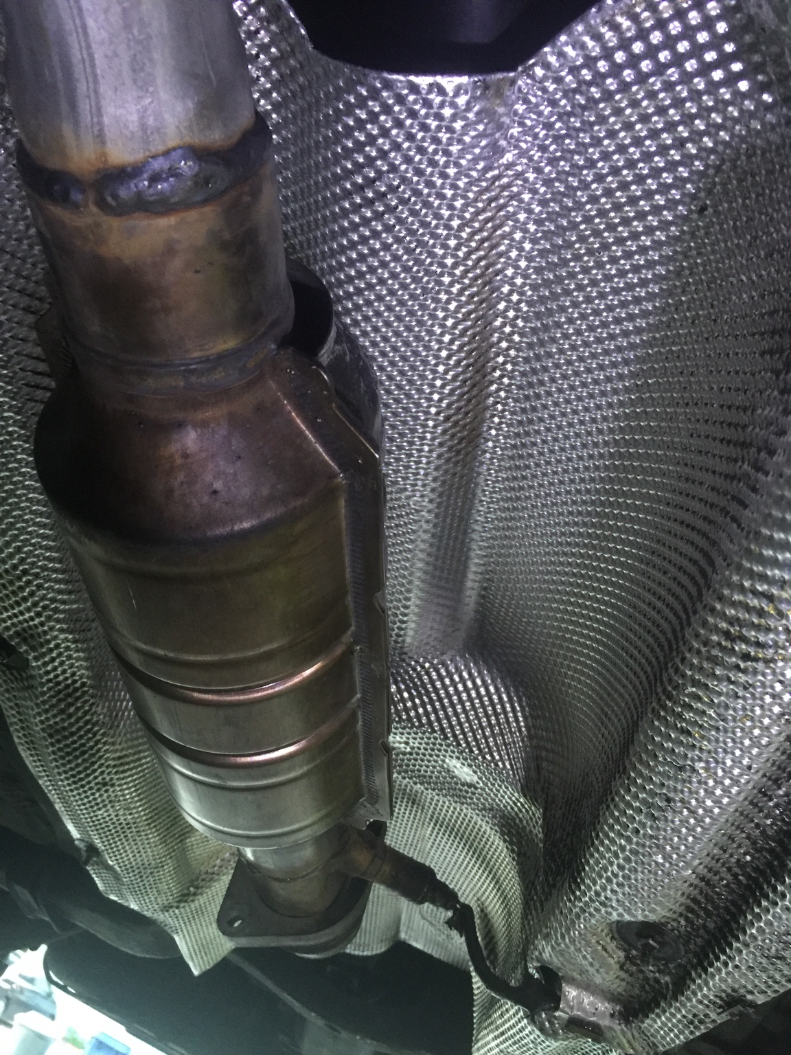

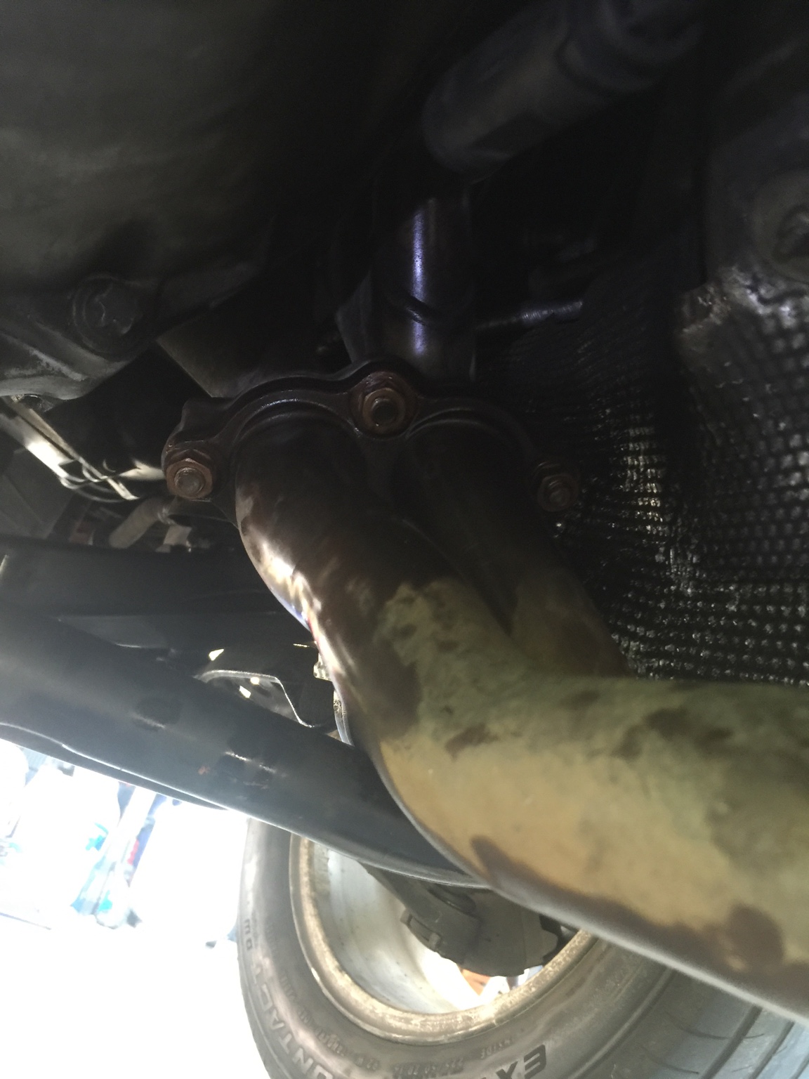

  • Found the source of the exhaust leak, Three of the four retaining nuts on the exhaust manifold flange are missing. This is the second issue that led to the sale. I replaced the gasket and installed four new nuts. Total parts cost $0 as I had the spares on hand.

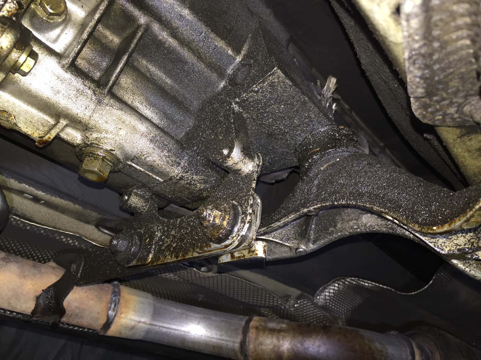

  • I found the main oil leak. It is by the oil pan near the internal oil pump pickup. I suspect no gasket maker was applied to the oil pan gasket at the seams between the covers. The Oil Filter housing gasket does not seem to be leaking, but I'll do that one when I do the drivers side plastic coolant pipe.

  • Correct Flex Disc installed
  • Cleaned heat shields
  • Exhaust gasket and nuts addressed

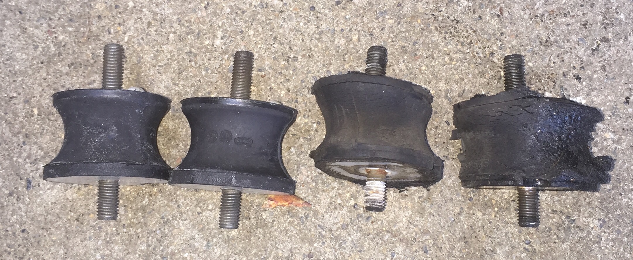

  • Tranny mounts replaced. The shift pattern firmed up nicely and shifting is now crisp, not so sloppy.

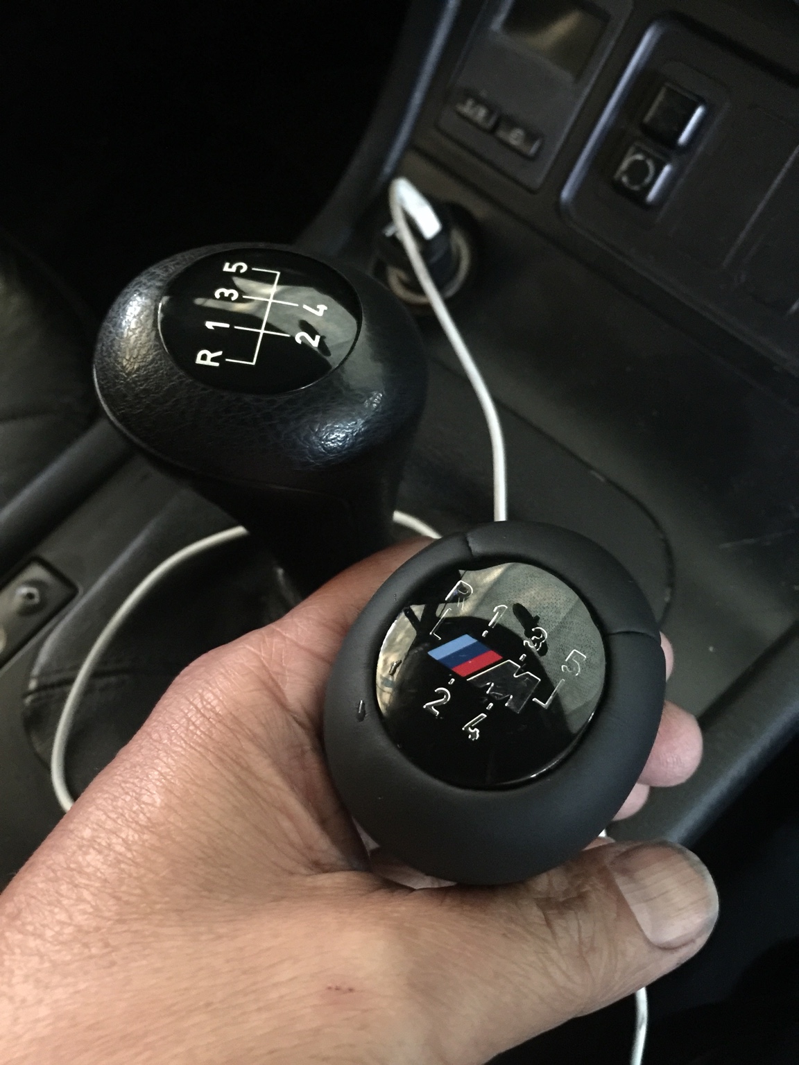

  • Short weighted shift knob installed. The original would not fasten and was coming off in spirited shifts. All better...

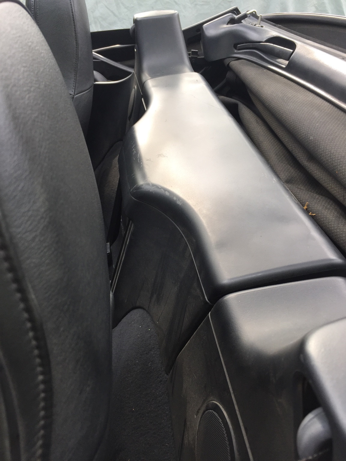

  • Figured out how to get into the Subwoofer for inspection. (thank you guys!) The subwoofer looks and sounds clear. The rear drivers side mid is blown as is the passenger lower mid/low in the kick panel. Additionally, the drivers door speakers are not working. Repaired the cracks in the Subwoofer lid from underneath with epoxy and plastic reinforcement. I have the drivers door panel off troubleshooting the lock and the speakers presently.
  • Still have to figure out how to get access to the two other rear speakers. Knowing all is brittle, I want to do it right, rather than experiment.

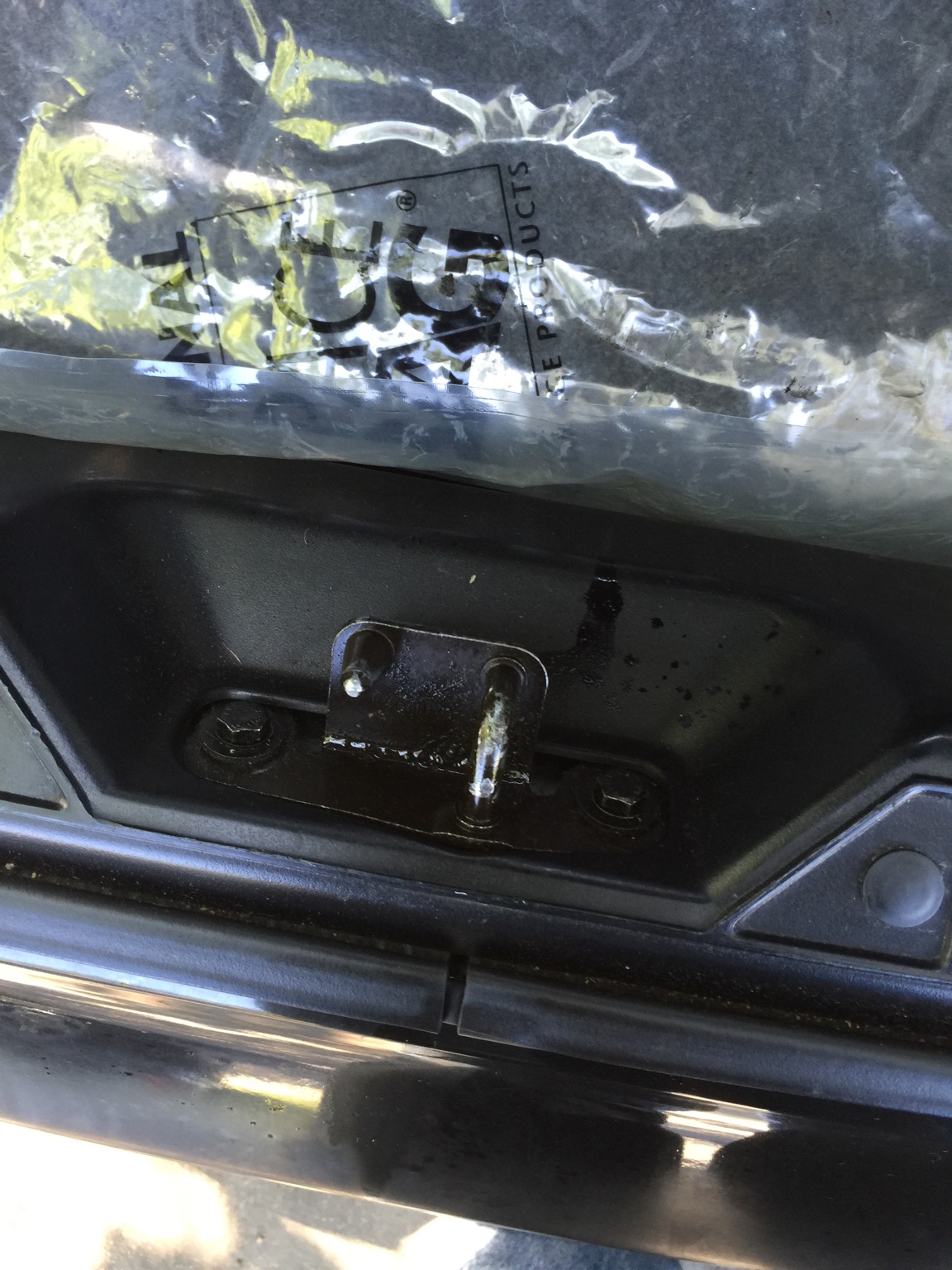

  • Adjusted and lubed trunk lock. It now latches the first time around, rather than 4-5 slams.
The car was running smooth and sounding healthy after addressing both the Flex Disc and the exhaust issue. Then, after a little spirited driving, a terrible, constant misfire.
My BT reader indicated that the #4 plug started misfiring. Upon inspection, the boot was torn off and #4 plug was shorting on the block. I ordered new Magnecor wires and in the meantime, I'll see if I have a spare in storage this weekend to temp replace while I wait for the new wires.

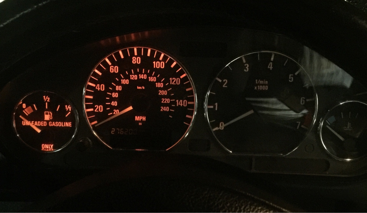

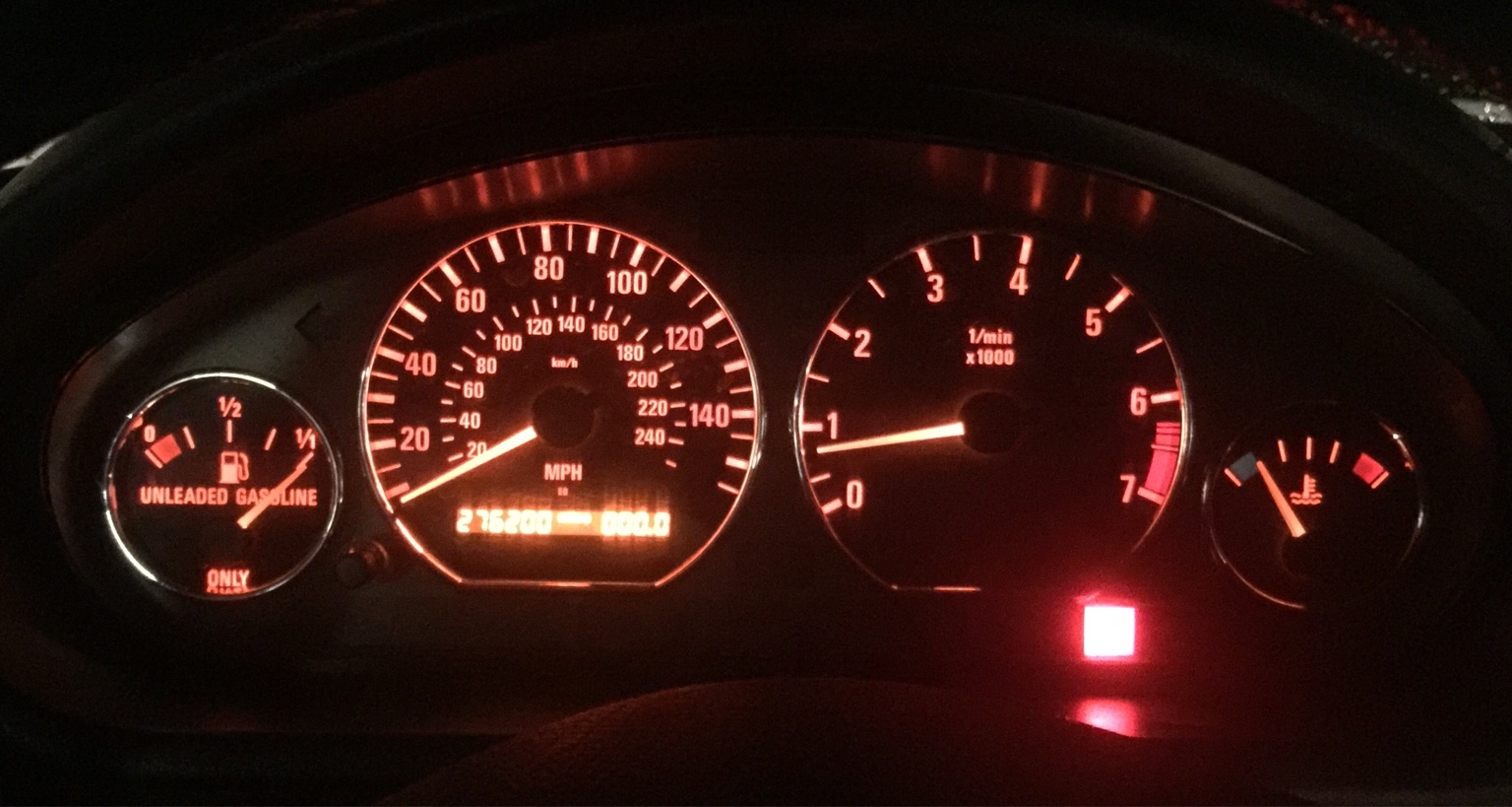

  • Replaced burnt out bulbs in instrument cluster
    Now I can see if I am overheating in the dark of the evening...
  • Replaced #4 spark plug wire. Runs smooth again

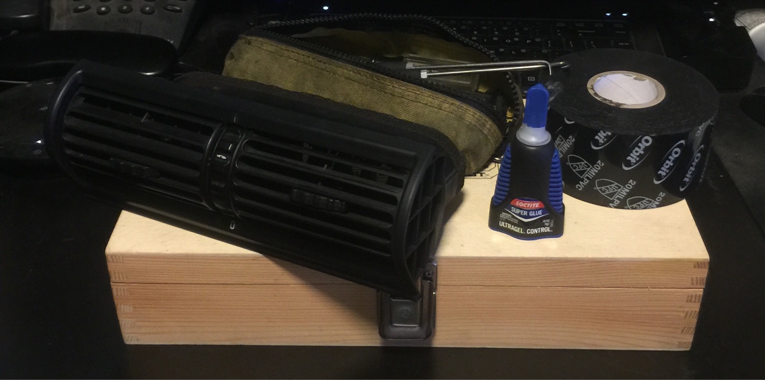

  • Tightened up loose center vent roller switch and rotating vents

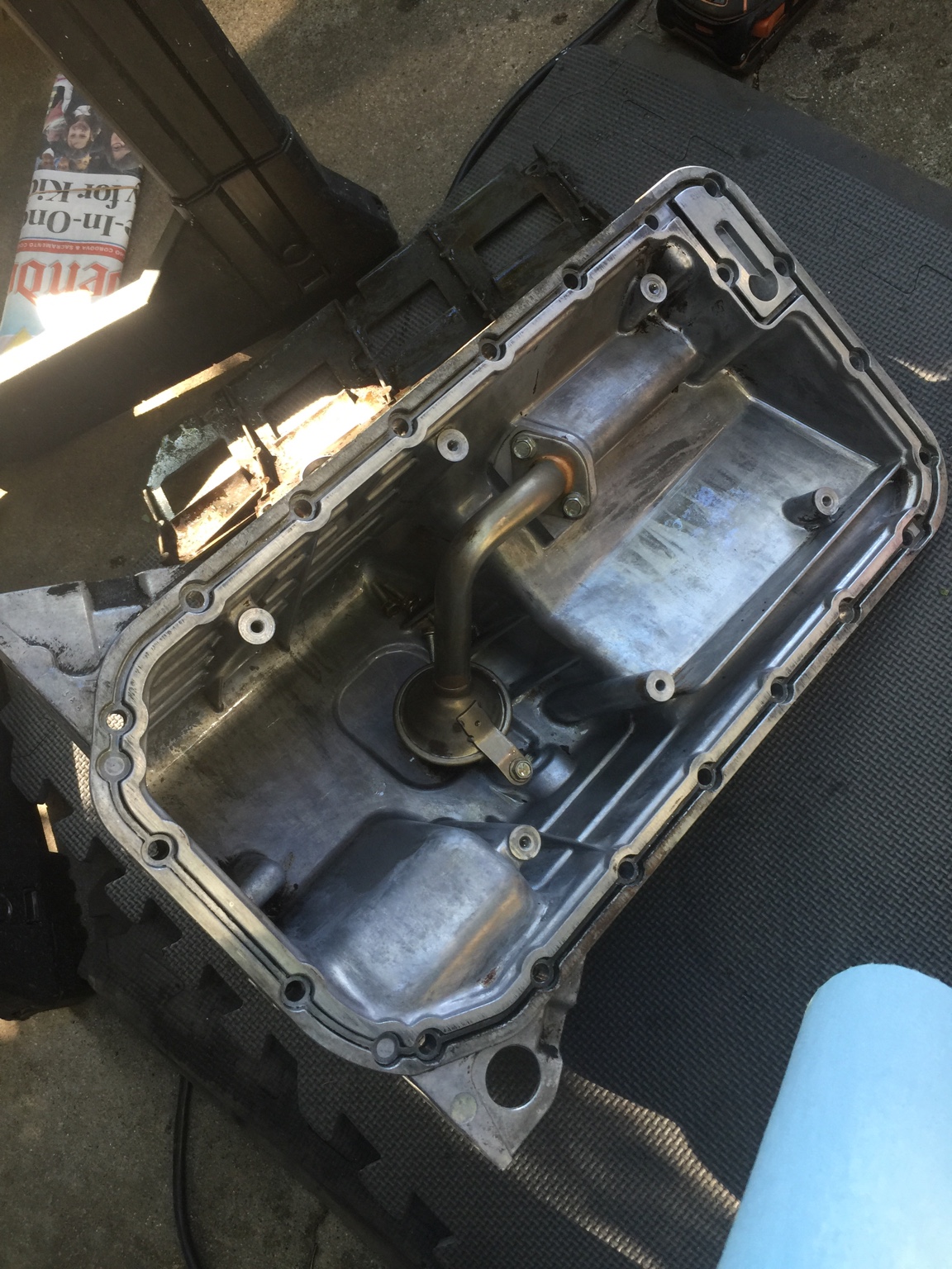

  • Cleaned Oil Pan and replaced it's gasket.
I believe the PO somewhat stripped the Oil Pan drain plug threads with a magnetic plug that had a different pitch to the bolt. It's in there snugly, but I'll plan on replacing the oil pan prolly at my next oil change. I'm getting quicker on swapping out M44 oil pans. I'll write and post an Oil Pan replacement DIY if one docent already exist

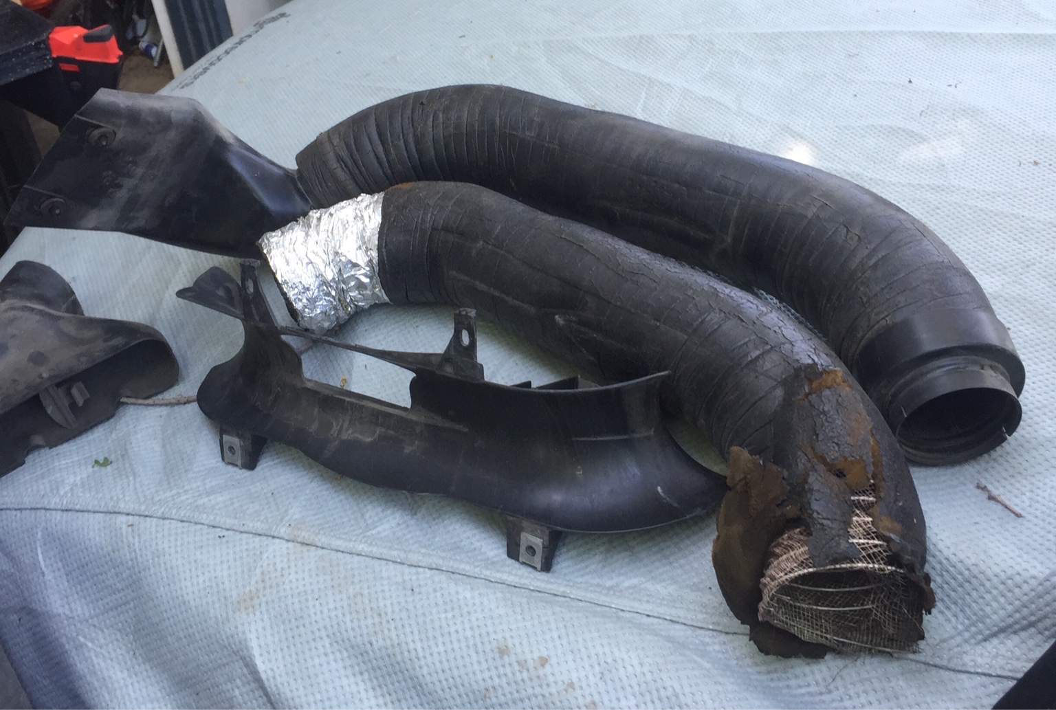

  • Addressed missing air cleaner horn to hose. It was just plain missing. I also refitted the foam air intake hose from a 318ti to the Z3 intake air scoop. All better.
  • Replaced the secondary air pump with one with the correct inlet. I suspect the PO replaced a failing one from an Air Pump from a different model. Same pump, different intake orientation. I replaced the rubber support bushings since I had it out anyway.

  • I'll SMOG the vehicle after Magnecor Ignition wires come in
  • I'll see if I can buff out more of the oxidation out of the hood. First pass on half of the hood showed promising results. It won't replace the clear coat, but it removed the gray oxidation and won't look so ghetto until I get the hood painted. I'll try a more aggressive compound for the real bad areas then work my way back up to finish with some Zymol as a stop gap until other areas get finished off and I can properly paint the hood..

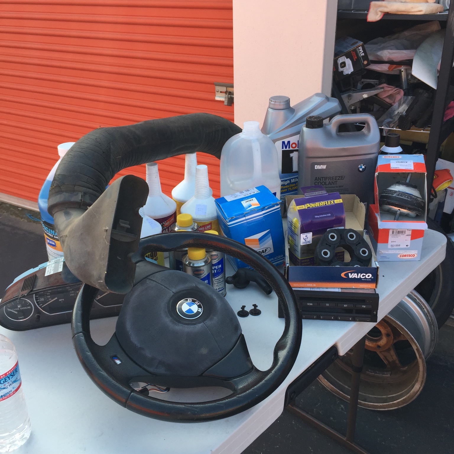

I love getting stuff in the mail. More stuff will get done this weekend.
Installed. Couldn't wait for the weekend. Had to modify the cover plate a little to accommodate the thicker ignition wires. Put the Intake boot on too... (Not pictured)

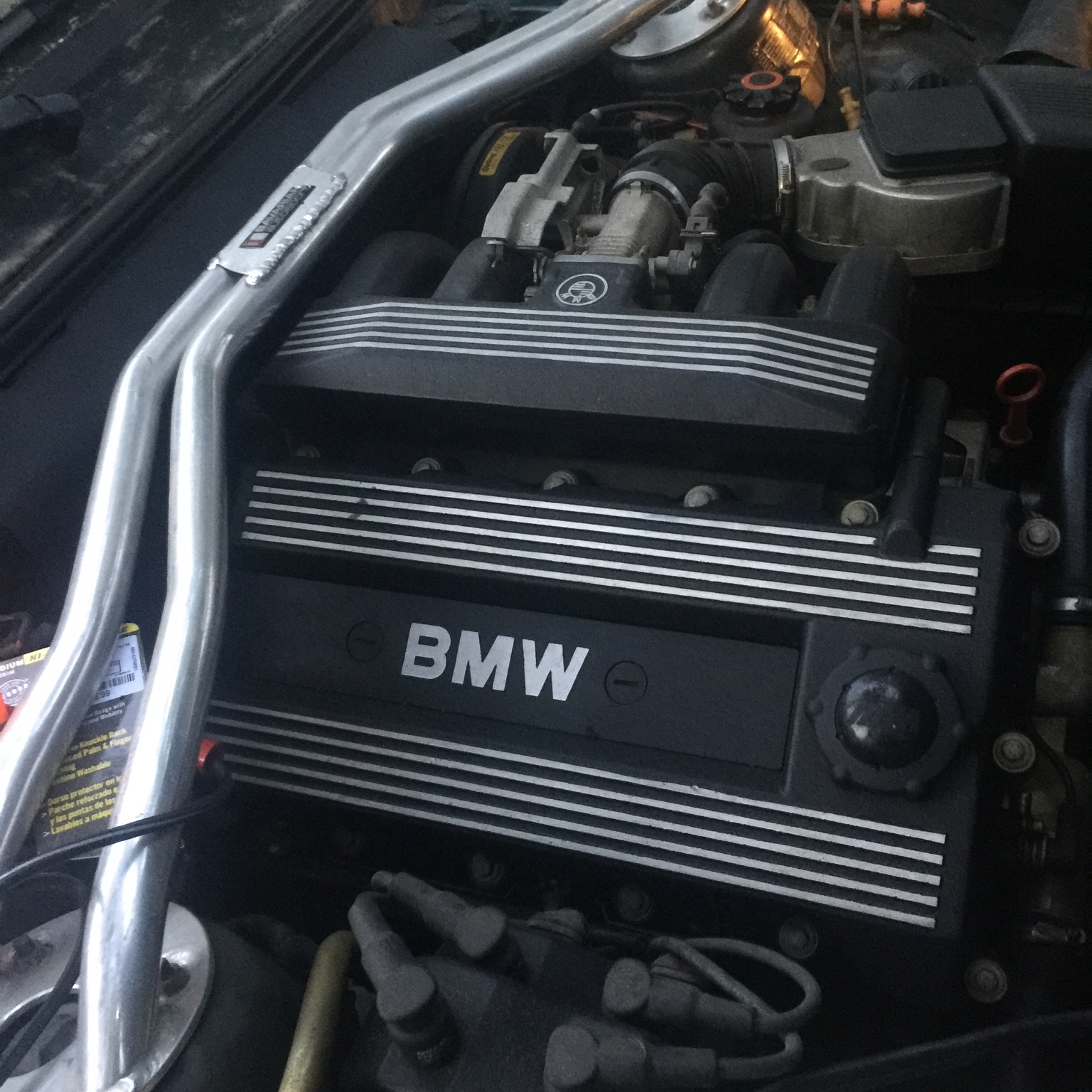

hmmm... Add powdercoating the M44 valve cover and intake manifold to my to do list. Like this. This is the M42 in my 318ic. Maybe Dakar Yellow tho against the black engine bay...

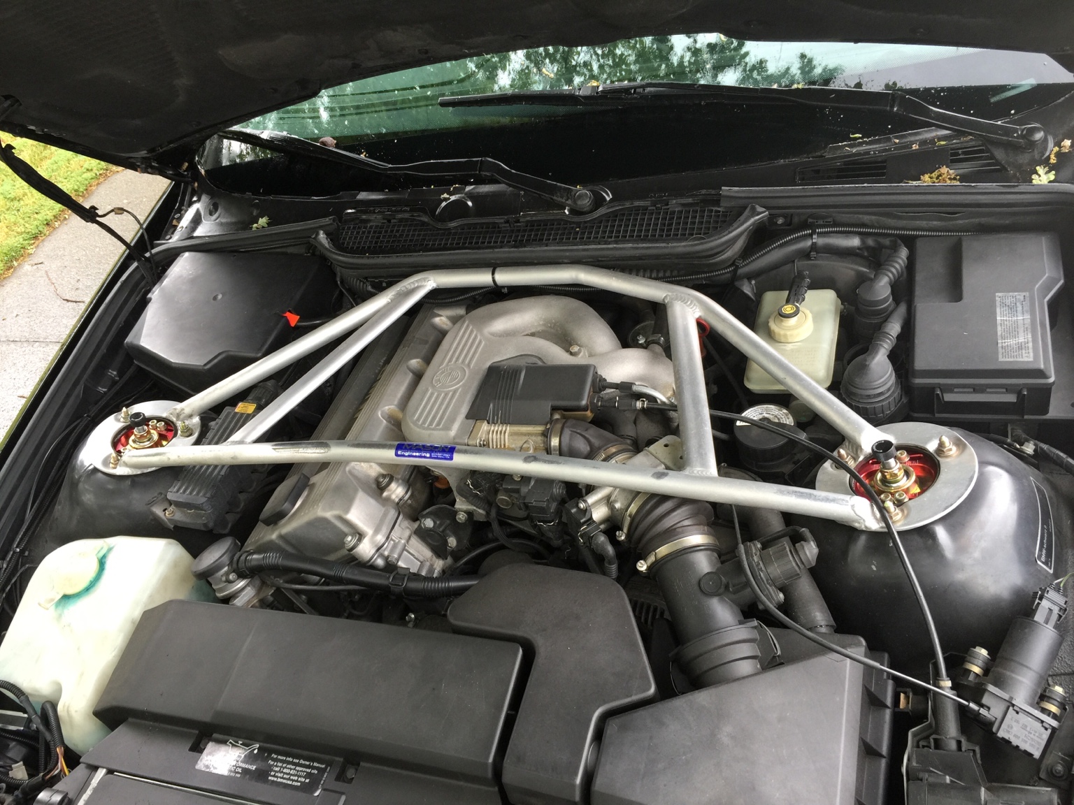

I'd like to locate a nice, effective front upper strut bar if anyone knows of a good, light effective design. Please do let me know. My favorite are the Mason Engineering bars, but John dosen;t make them for Z3 1.9s. :( (Pictured is the Mason strut bar in my daily driver, a 1998 318ti, 1.9L Compact.)

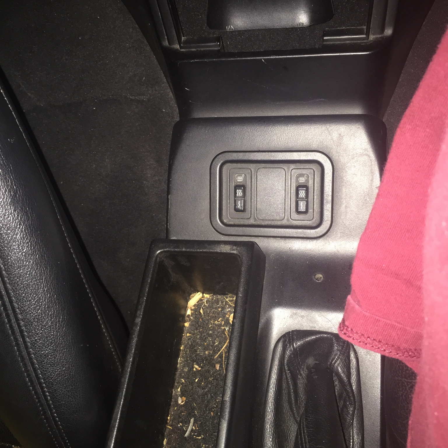

Pardon the mess, but if you have a 1997 Z3, are your seat heater switches in the rear, in-between the two seats? :wtf:
If so, what sort of logic placed them back there? I am thinking to relocate them forward to the dash where I have two blank plates for accident free access. :joyful:
If they were relocated to the rear, I should have spare wire. If originally aft(rear), I'll just need to visit my favorite place to get color matched wiring to be consistent when I relocate them forward.

I don't have heated seats yet but will defo be moving the switches to the front when installed so will be paying close attention!! 1200HP in whichever car it's in must be a wonder to hear and watch. Dragging is my favorite motor sport and I've worked with several friends crews over the years dating back way too far!! lol. Good luck not that I think you'll need much. JIM

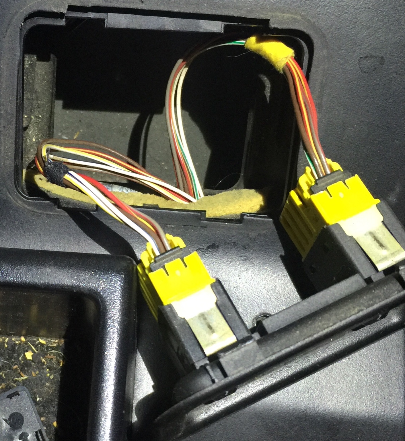

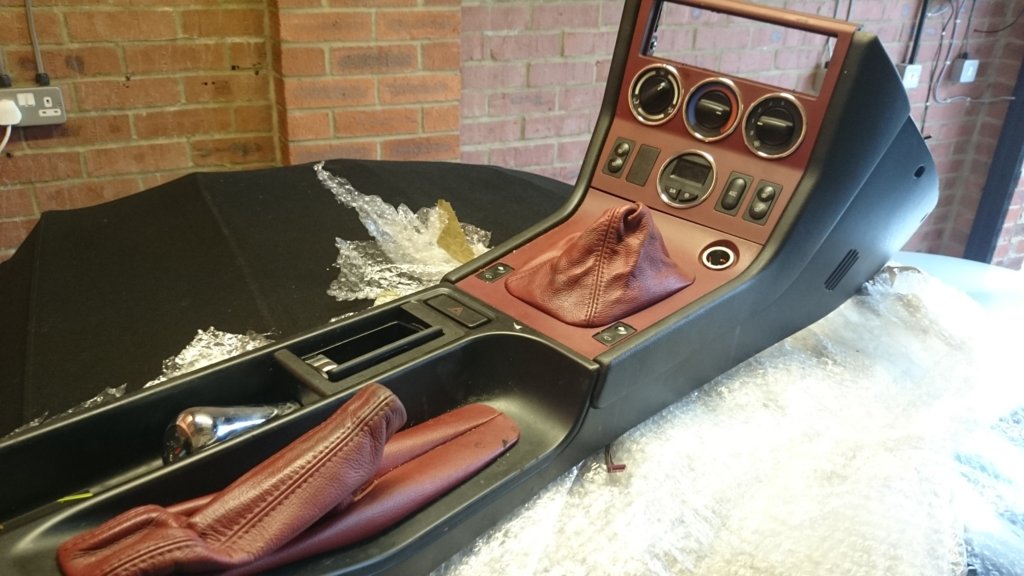

Oh yeah, the seat heater switches are moving forward...
Popped the plate for the switches. Wiring runs under and through the central console.
Here they are routing past the parking brake...
Assuming the exiting wiring can be rerouted, the switches will reside here. Now, I don't have to be a contortionist to turn on the heat. :thumbsup:
Now I just have to find the fasteners to remove the central console.

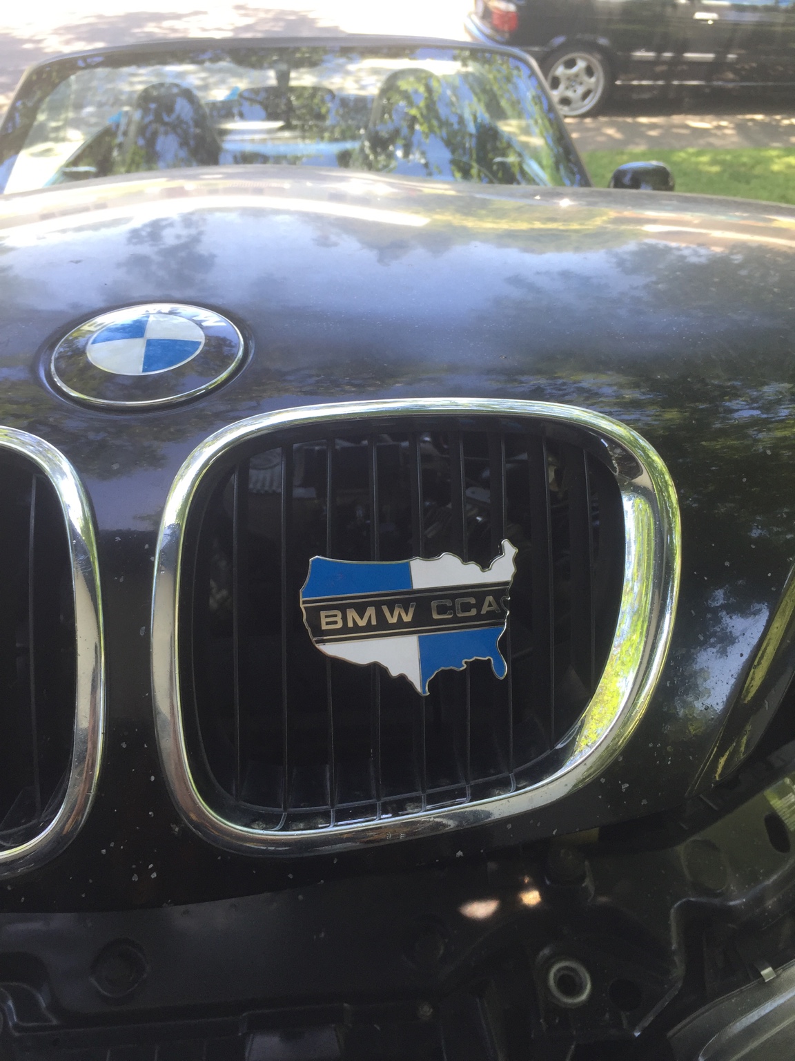

Installed my club badge...
and this one.... Nah, rather just put it in and keep it a sleeper...

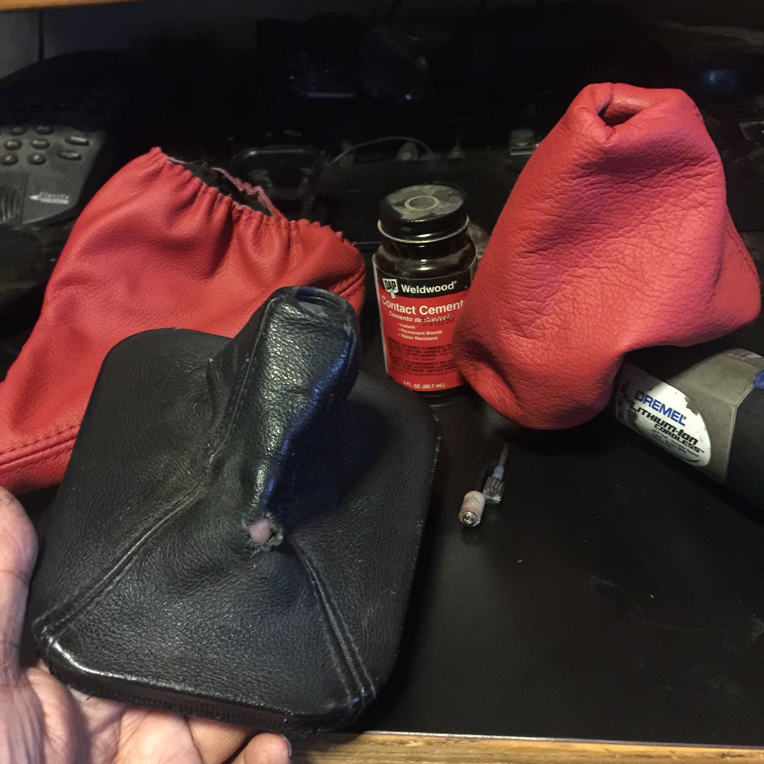

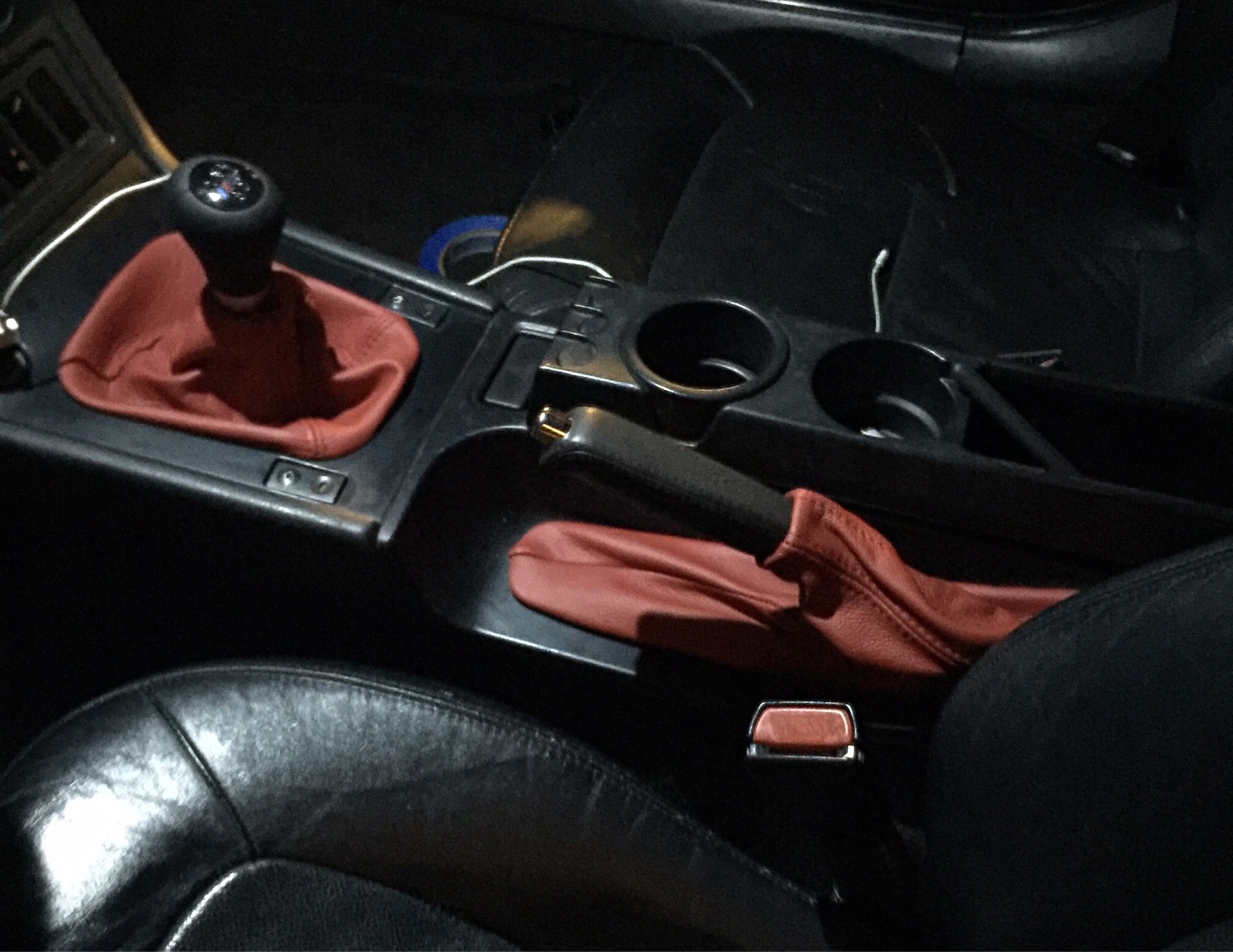

Also working on the shift and e-Brake boot replacements this evening... I figured I put a little POP in the cabin.
Finished product. I'll install them in the morning.

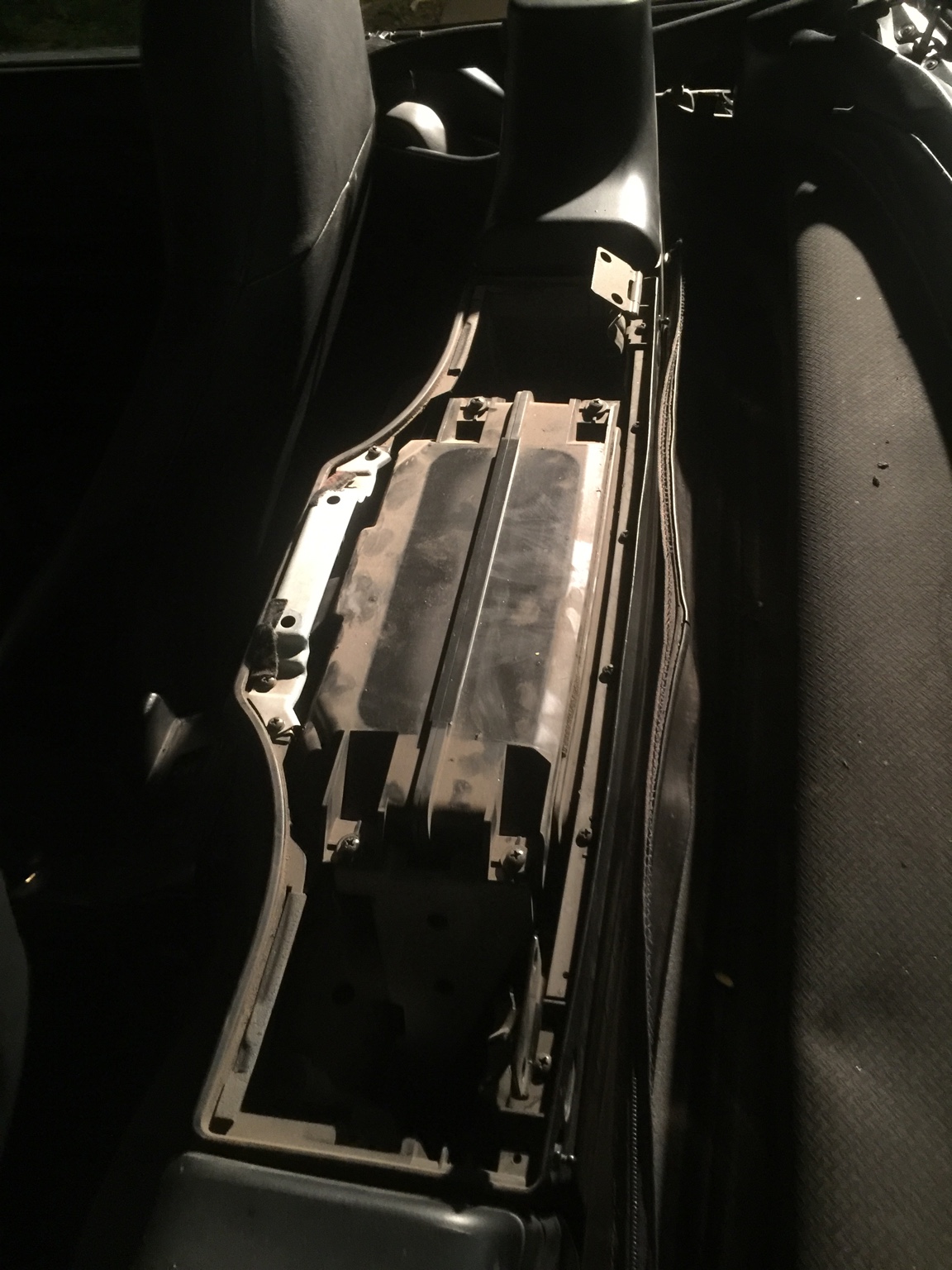

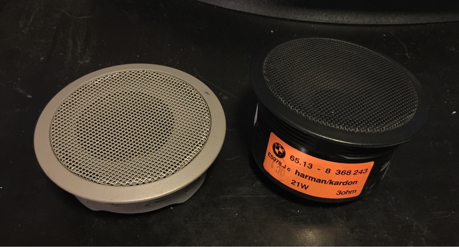

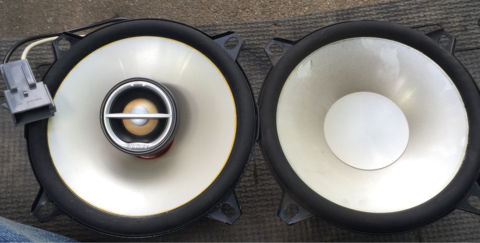

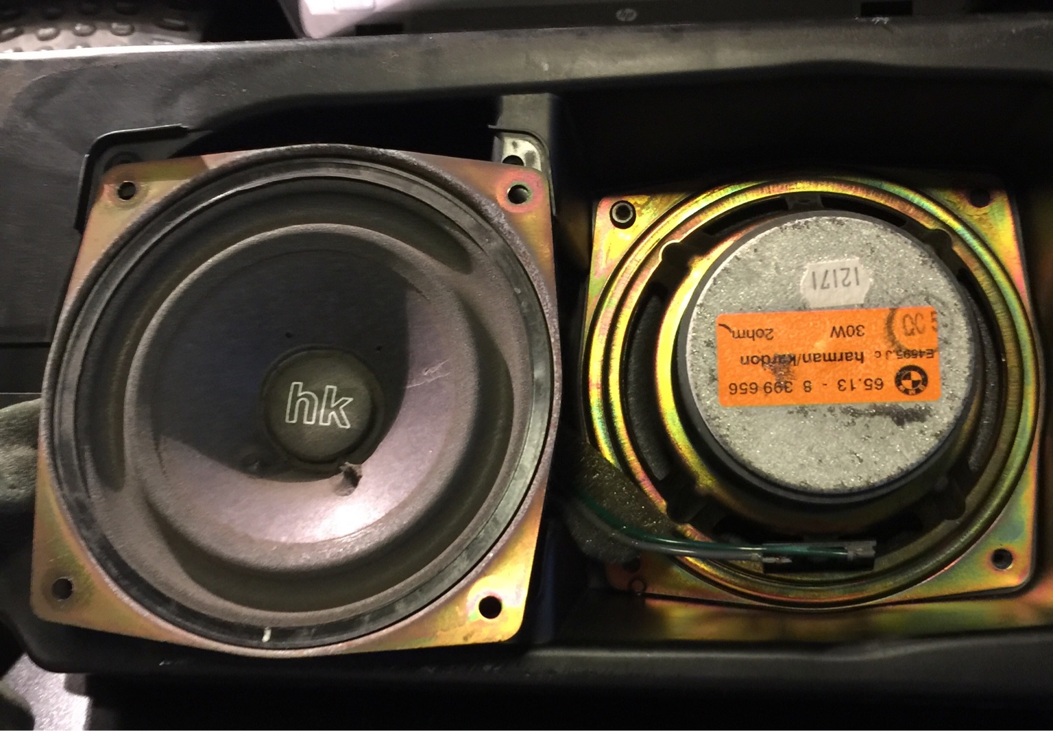

So, today, I worked on the blown audio system. The front 5 1/4" turned out to be Infinity Reference 5000 speakers (Right) I replaced both of the Front's with Infinity 5002s (Left). The passenger side speaker was partially detatched from the rubber surround. The drivers side was just fine.
Both are replaced now. I'll repair the passenger side speaker for retrofit into one of the Compacts.
Both rear HK Mids were also blown. I replaced them with a pair of spare grey Nokias I had for the TIs. I have another pair of the HK Mids coming in. However, the Nokias are clear and working fine. One of the two 5 1/4 subs are breached. Not noticeable unless you crank the bass. Oddly, Mozart was the most noticeable music distorted. I have replacements coming in for me to repair the unit.

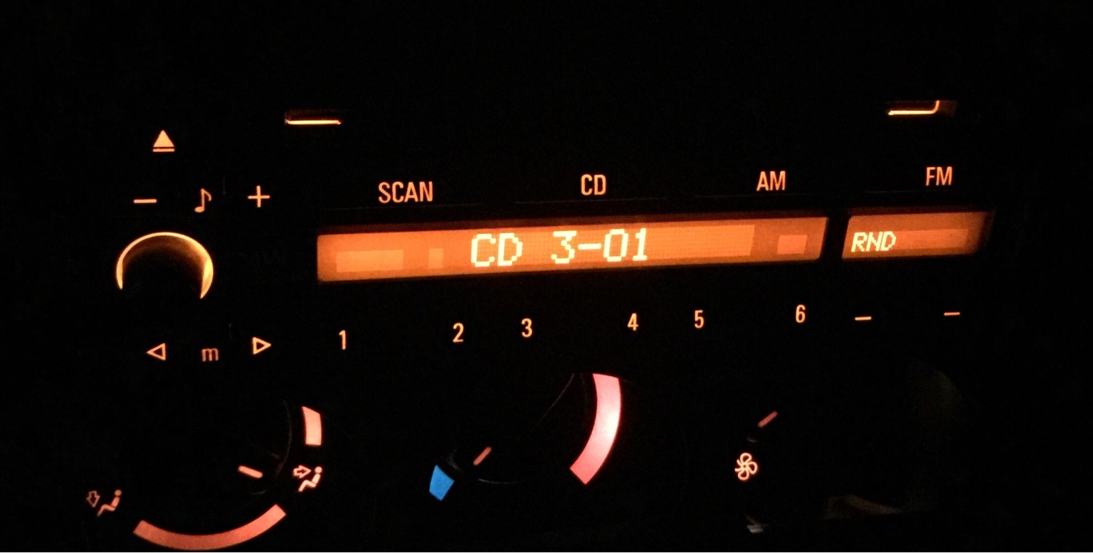

I also tested a CD-43 to replace the Cassette unit that was installed. All functions worked great and controlled the changer just fine. What is particularly nice is that the unit illumination works so I can see the stations or what's actually playing. I wasted about an hour just enjoying how nice the system now sounds.
I also test fitted the e-Brake and shift boots I glued together last night. I didn't fully push in the shift boot yet as I am removing the center console to move the seat heater switches from the aft to forward. Now i just need a pair of red and black M Roadster heated seats.
While I was there anyway, I adjusted the e-brake to six clicks. Actually holds now...
Speaking of the center console, I am trying to figure out how to remove it without breaking anything. I'll look it up in RealOEM and see where the fasteners are. I'll look for a DIY here and in other forums. If anyone knows of one, please point me in the right direction.
If it doesn't rain tomorrow, I'll be crewing at the Drag races tomorrow. If it rains, I will continue renewing the Z. Likely starting with installing this underbody shield to help with cooling airflow. When summer hits, Sacramento can normally be in the 110 degree temperature range, so cooling is imperative. I also have to test the high/low speeds on the cooling fan.

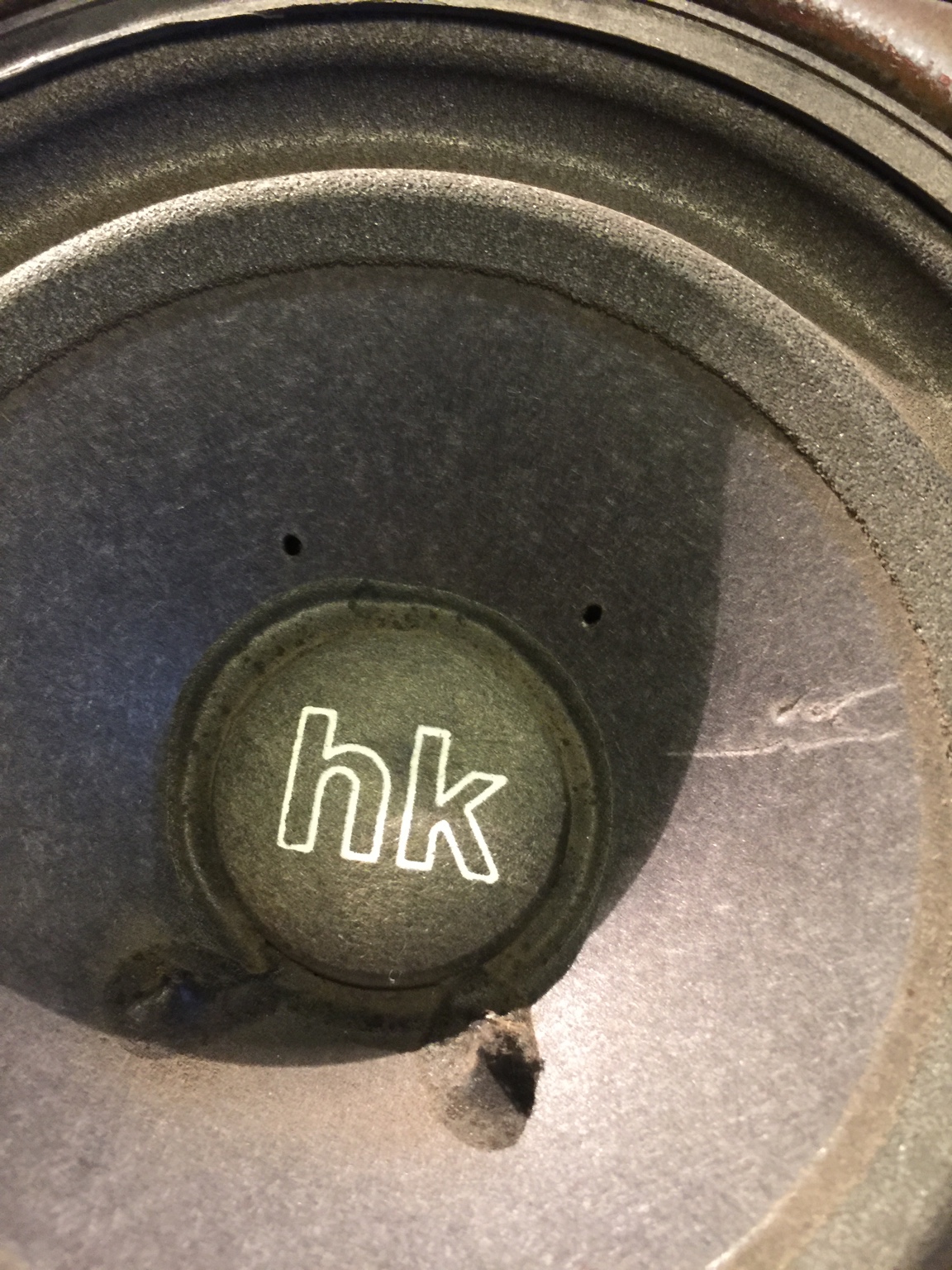

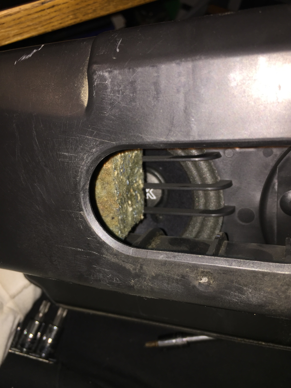

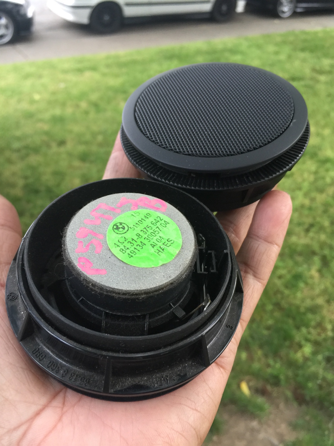

I did open up the Sub today to see how bad the speakers were. The rear facing speaker had a small tear in the center paper coil.
The forward facing enclosed sub upon opening and inspection was just fine.
Here are the two 5 1/4 speakers. I was going to insert one of the Infinities in place of the torn woofer, but the ft was not optimal due to how the foam on the Infinity 5000 protrudes and the HKs are recessed.
The tear is barely visible, but it is there and you can hear it with low tones.
I did find intact Mids out of a HK equipped E36 at the wreckers in crashed E46s. The drivers under panel usually has a single black mid. I found three, kept the best two. $22

Centre console is easy to remove.
Two screws at the back either side
Two screws under the rear cover (switch or oddments tray depending on model)
Four screws under small covers at the front sides.
Pull the center heater vents out (just yank them)
Remove stereo
Remove gearknob and boot
Remove handbrake handle and boot
Then the console is only held in by the wiring looms.
Thanks! I believe I'm stuck at the four front screws under the small covers. Which small covers? I pulled four screws in the area by the radio opening. are there more under the side trim along the side of the console?
screws under Part #13?
http://www.realoem.com/bmw/enUS/showparts?id=CH73-USA-05-1997-Z3-BMW-Z3_19&diagId=51_2369
5harp3y
Jul 10, 2015
168
Basingstoke
2.8
No they are on the side of the centre console in the footwells
They are under small black caps that need to be pried off
5harp3y
Jul 10, 2015
168
Basingstoke
2.8
The whole tunnel console needs to be removed to remove the fascia panels.
