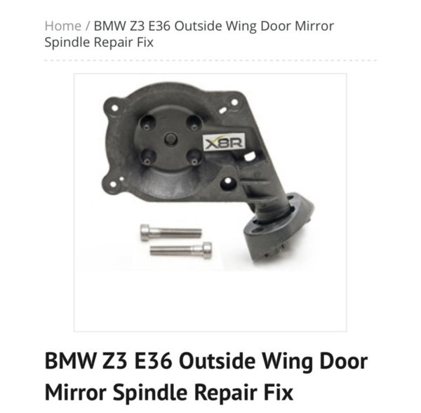

I broke both mine on my Silver ‘97 Z3, when I was trying to fold them in when putting a winter cover on :(:mad:
So I got some of the X8R resin ones
Got them sprayed up, swapped over the wiring, motor, casing and mirror. Now no worries about rusting or seizing up :thumbsup:
