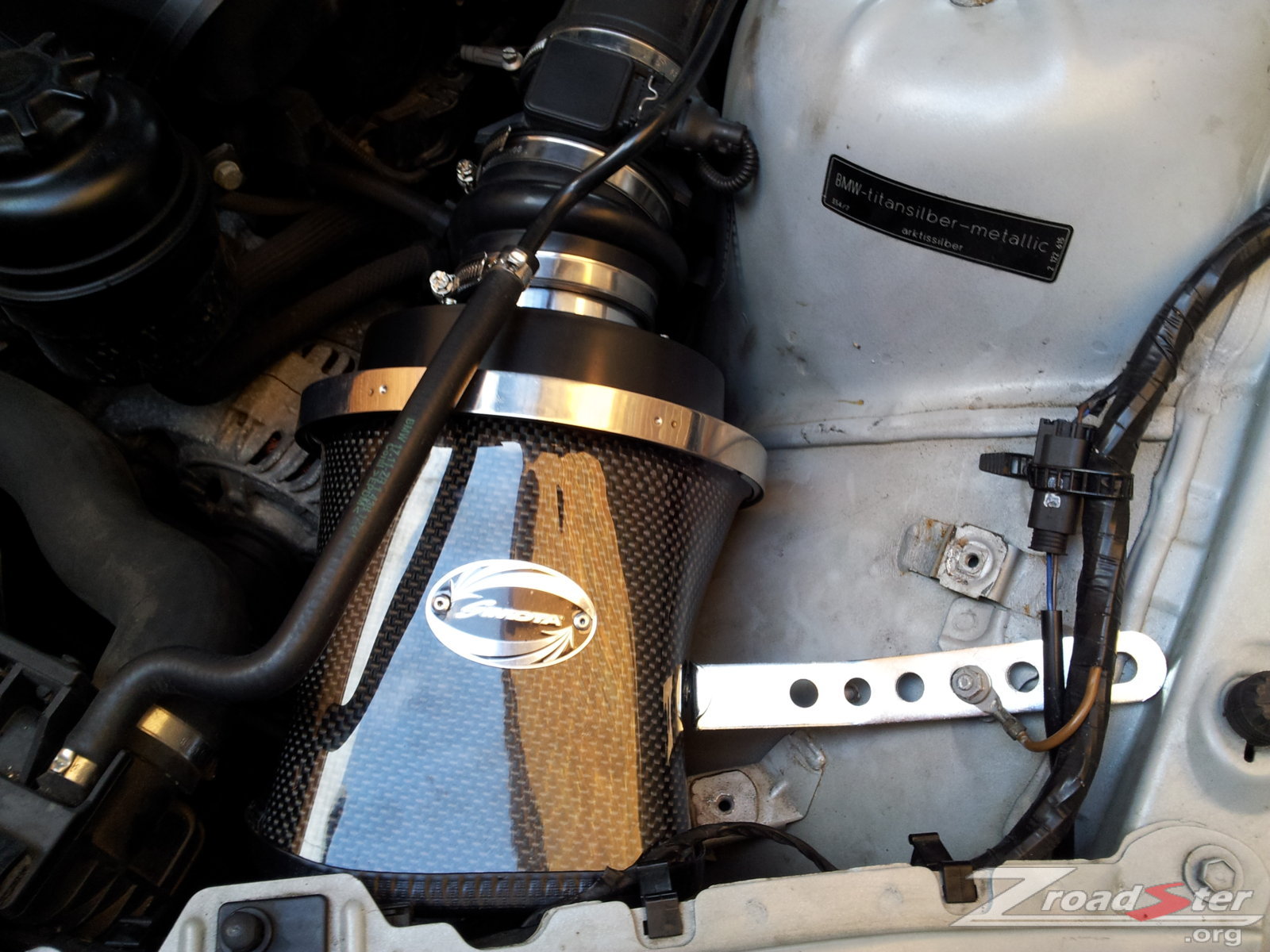

@GazHyde I've taken a look at the airbox fogging guide, when you fitted the simota did you make any changes to the cold air feed?
Cheers
Ash
Ash. The Simota replaces the air box in its entirety and fixes on to the MAF. The carbon fibre makes a funnel for the incoming air and can give a small ram effect (doubt that much in reality).
Is that not still relying on the cold air from the kidney grille which feeds the std air box?
I just found out the price for one aswell :dead:
Yes it does. As far as I understand it, as with any cone filter replacement it allows more air in to the intake. The carbon fibre bit funnels the air in to the filter, and also keeps out the warm engine bay air out of the filter. I'm sure someone can explain it better than me though. All I know in practice the engine generally ran smoother than with the OEM box.

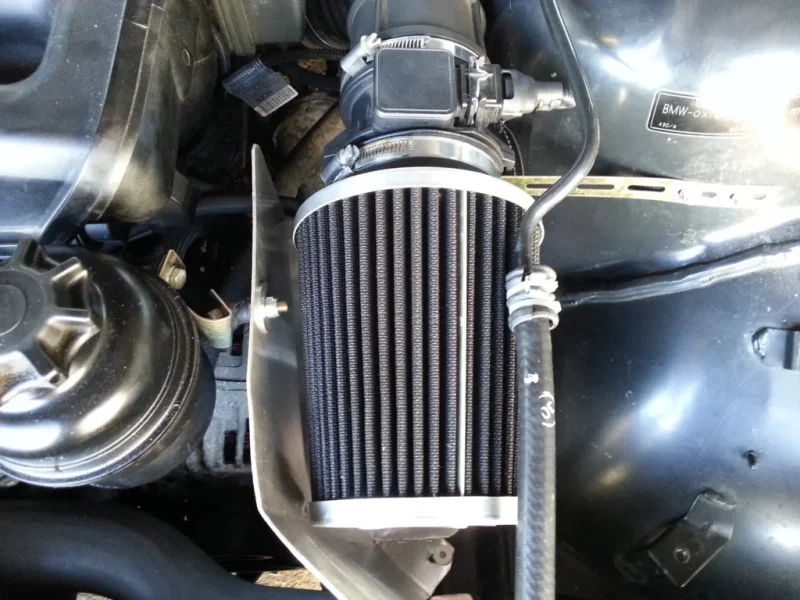

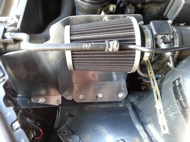

Yeah, only downside. There are cheaper alternatives, such as an open cone filter and making your own heatshield for it.
As you can see Ash it's work in progress to be honest. Having started this project earlier this year and now my car is "off the road" till spring I will get the filter fully boxed and will post pic's later as I get it done. The engine definitely runs smoother and seems to accelerate better with this induction "kit" on.
