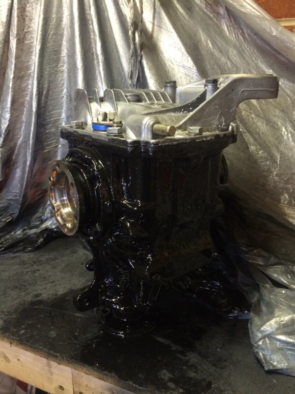

nice thread @zedonist interesting stuff going on, shame you couldnt get the diff, that would have been the easiest way out, am on the look out for one myself ;-) SMF is interesting, it will certainly make a big difference and will be interesting to see how the biting point works out compared to the DMF, look forward in anticipation ;-)
PS, nice work on the rear ;-)
