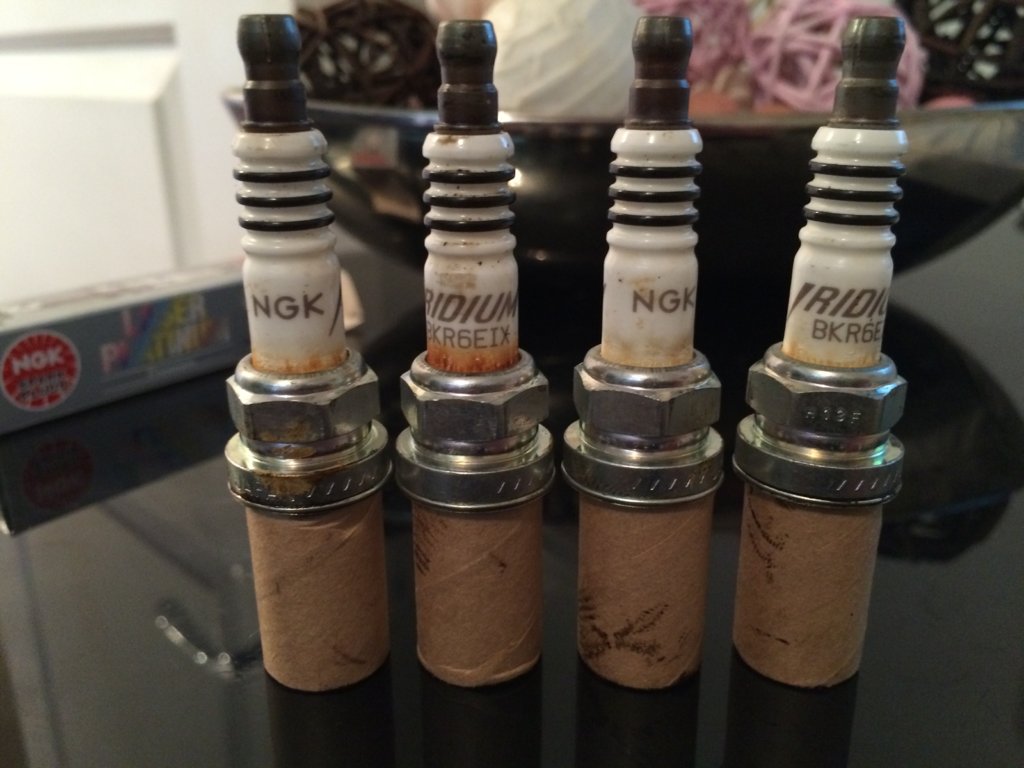

Well thought i would add an update, its not related but i know how frustrating it is waiting for these types of discussions to move forward, anyway had an issue with my ASC and ABS lights tripping, and diagnosed this back to a misfire, the culprit at the time was an arcing plug lead, dutifully swapped out, that done the lights went away and the codes never appeared until Monday, so ASC & ABS lights triggered again, funny thing though they only trigger when the car is running from cold, on Monday I had a longish trip to the Engine Builder, lights trigger in 10 minutes of driving, anyway on the way back the lights cleared and never triggered once. Short story long, figured it had to be plugs, so jump on the net and order some new plugs - NGK BKR6EQUP, these are the quad electrode platinum tip plugs and not the Iridium plugs i currently had installed.
Well special delivery today, new G-Shock Watch and 4 spark plugs, well i was on line i might as well have done some extra shopping, missus thinks the plugs cost over £100 ;)
So this morning cup of tea in hand (not coffee Gaz) start to remove the plugs, number 1 is loose, so there is good start, number two has corona staining, three and four look fine. Overall the condition of the tips is excellent showing a nice running engine, mind they had been in 3 years:
New plugs installed codes reset, and off for a drive, ASC and ABS light reset itself and not come back, and no pending codes for a misfire, have to put it down to plug 1 or 2.
